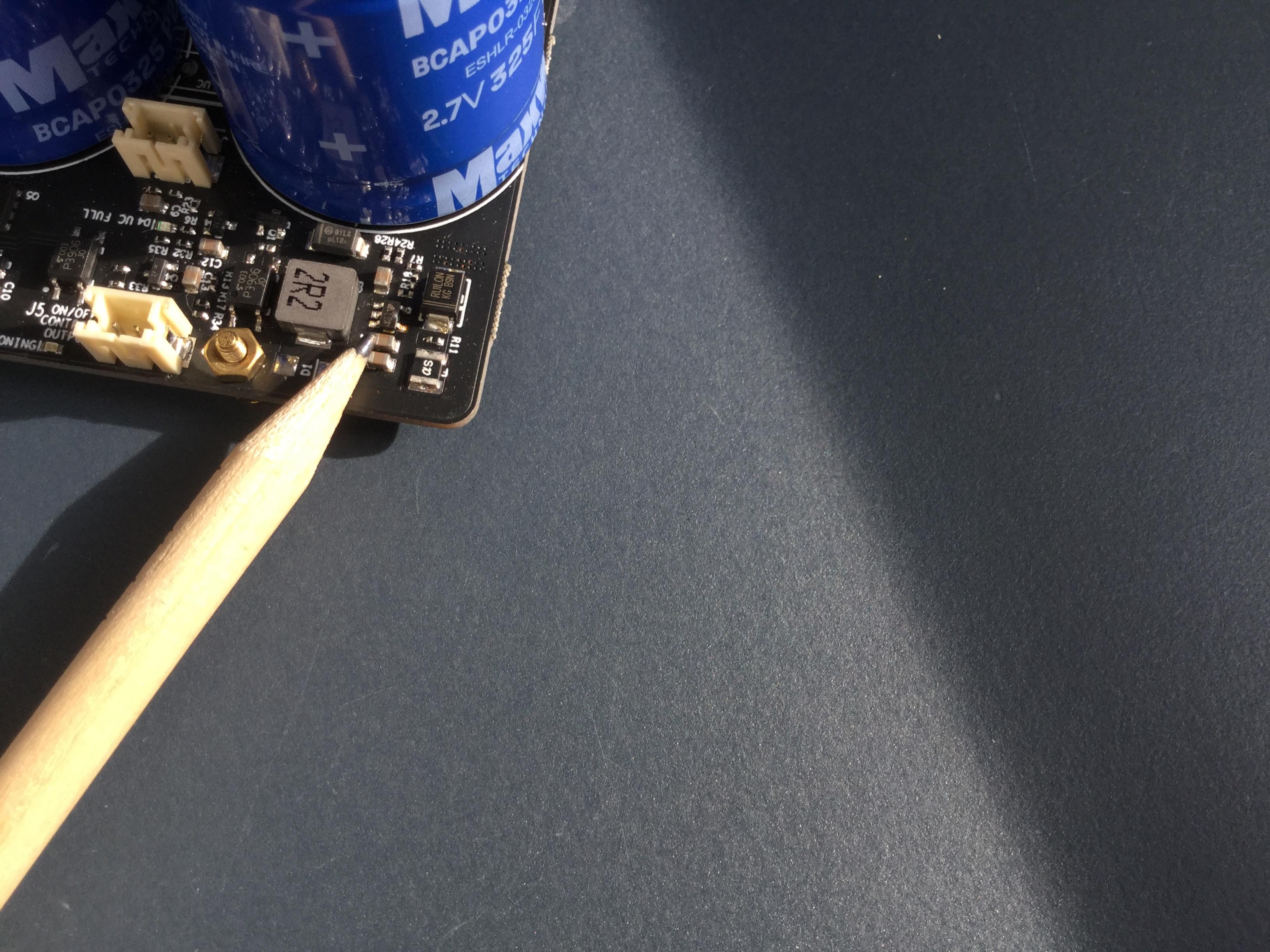

Hi Supersurfer,
Sorry about the issue. U1 is the pre-charger not the transistor. The only chance to damage it is that the input voltage is high than 6V. Even at short time. What was the output voltage of you power supplies?
I don't know Tentlabs ps, can I have more details about it. How did you power on/off it? What voltage did you set? If they are tube heat power supplies, the output voltage may not that stable.
I have used many power supplies with it, I never got problem. So if 3 of them have the same problems on your side, it should be some thing related.
I would suggest you trying the good one with a better 5V linear power supply to see if there is any problem.
To fix it is very easy. I'll send 4 chips to you to replace.

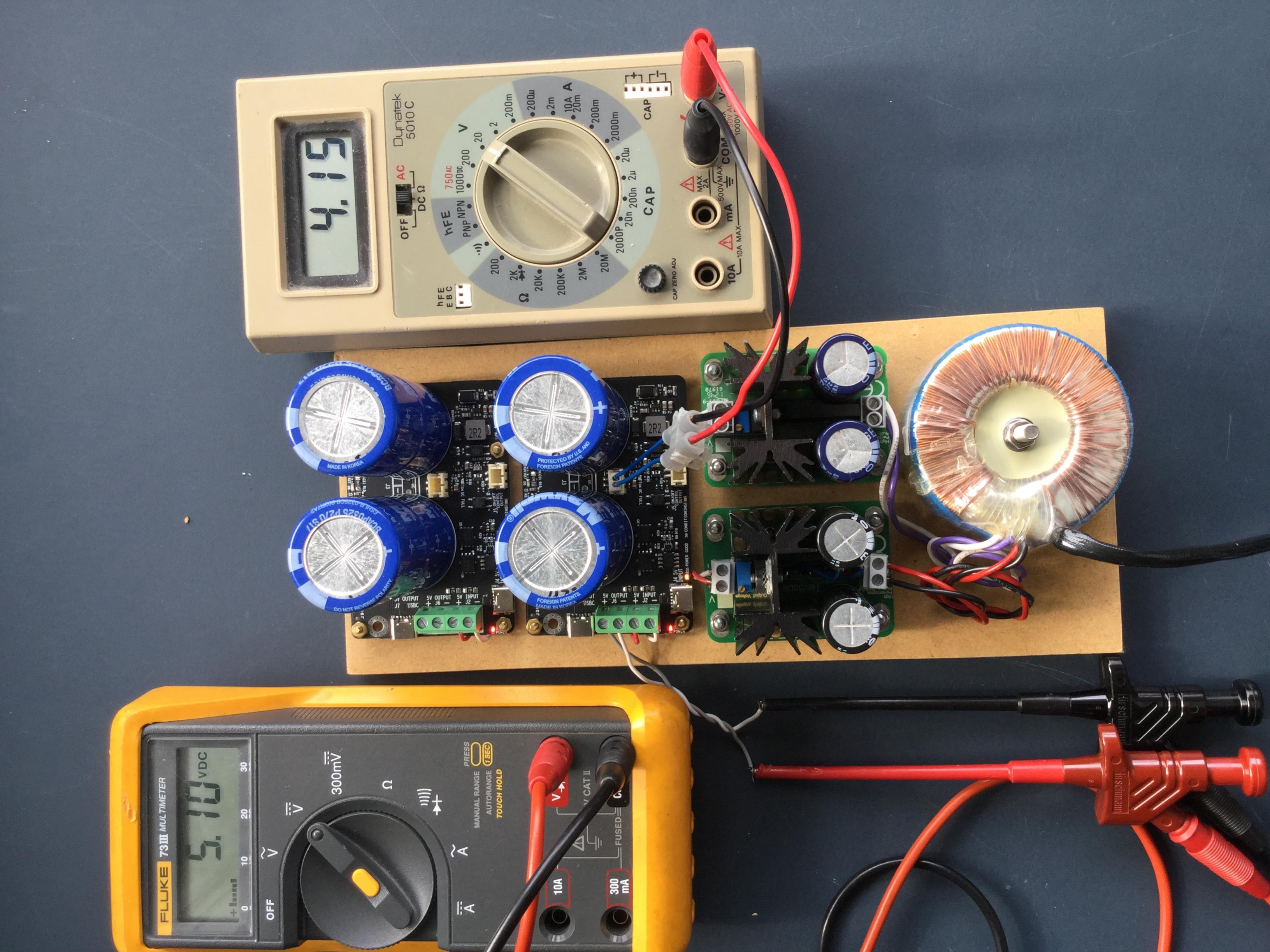

Hi Ian,
The U1 is burned out on one of the modules. Please sent a replacement chip for this one. I can replace it myself.
I do not have more information on the Tentlabs ps than the link in my post. They are also used by Tentlabs as a ps for a diy cd player. I have used them for powering raspberry pi and other stuff with no issues for years. I think they are very stable but I did not have a voltmeter connected when it browned out. It was adjusted to 5.0v, power on/of via a switch on 230v input. Maybe the switching of the UcConditioner itself has caused a voltage spike?
For the other two modules:
The power supplies are adjusted to 5.0v and I have turned one up to 5.2v to see if the charge is going up; and it did.
They have a charging issue and it is not related to U1 brown out. They will not charge higher than 4.10v with input of 5v. If I raise the input voltage 0.2v the charge will also raise. So I think it is a calibration issue or something similar.
How can this be solved?

I received the parts from Ian yesterday and soldered them onto my UcConditioners. I even got a spare UcConditioner to test!
Everything is finally working now! I need to find the cause of the U1 browning out, the Tentlabs power supplies were never above 5,2v, and I have been using these for several years without any problems, maybe there was a power peak due to on/off switching.
I like the linearpi design and would like to get some of these the next time I am in the mood to order stuff from Canada.
Thank you Ian for your assistance through email and sending the parts!
