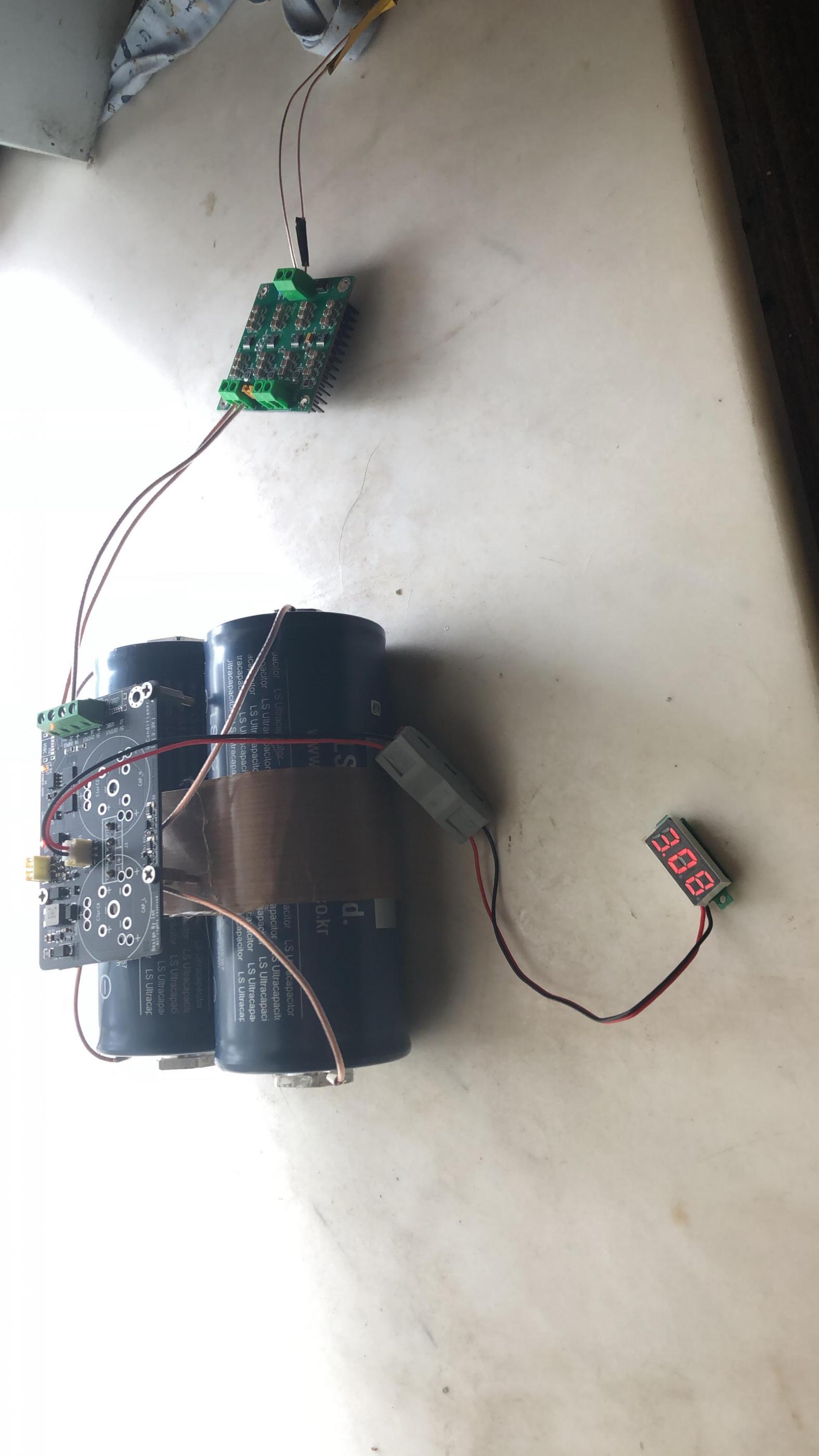

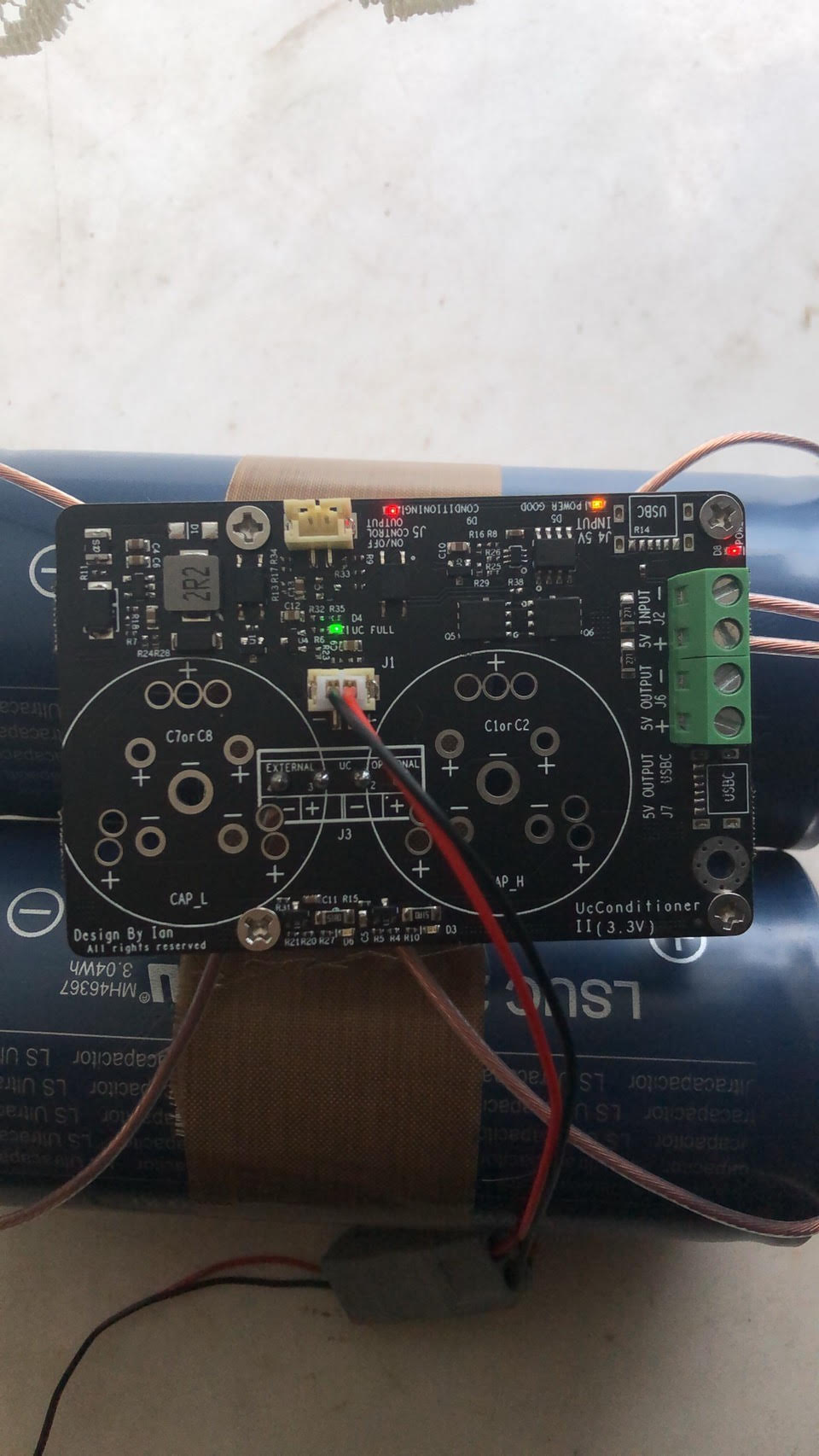

I have been waiting for the supercapacitor connector I purchased, and today I have the opportunity to test the 3.3V UcConditioner. As a result, I think I should get a defective product.
I just turned on the power, and the indicator of UcConditioner showed that it was FULL...
But I didn’t give up immediately. I let him energize for 1 hour, but the output terminal could not measure the voltage, and the supercapacitor did not measure directly.
It's really disappointing. Since Ian's new product has no effect, it is even defective.

Please no worry, all UcConditioners were fully tested so shouldn't be any problem unless you didn't use them properly.
1. If your ultra capacitors was charged full very quick, it means either you didn't connect them correctly or your ultra capacitors were defective or don't have enough capacitance. What kind of ultra capacitors your are using? What's the brand name and specifications? Why you don't use the recommended P/N? Can you post how did you connect your external ultra capacitors?
2. There will be voltage higher than 3V at output as long as Power Good LED D9 is lit. Please connect your load to the output before you measure the terminal blocks. There could be no voltage at screws if the wires are not installed tightly to the terminal blocks.

He seems to be able to work, and after charging for an hour, the full indicator lights up. This may be because I didn't connect them correctly before.
However, when the full indicator light is on, the output terminal still cannot measure the output voltage, but when the voltage of the super capacitor is measured separately, it can be measured to 1.65V. It seems that the charging function is normal, but the current and voltage cannot be output. Must be connected to load to have current output?
My super capacitor is LS Mtron Ultracapacitor 3000f. The ESR value of 3000F is lower, which is my reason.
I claim that it is ConditionerPi that does not have any effect. As for whether UcConditioner has any effect, I still don't know, because UcConditioner can't output voltage at all, even after charging is completed.

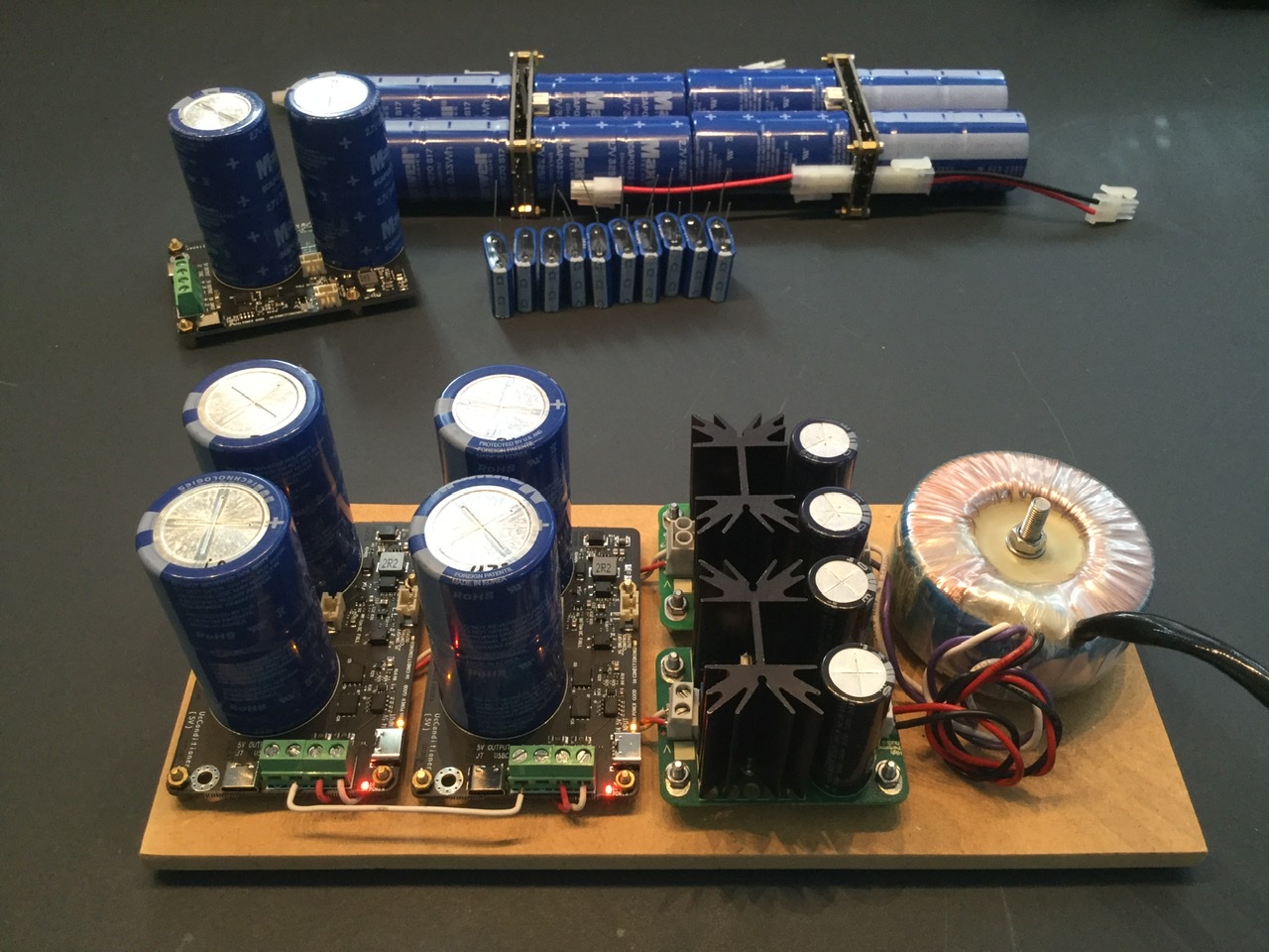

10v UC conditioner power supply
This is my breadboard 10v UC conditionded power supply.
I use a transformer with 2 secondairy windings, two 5v linear regulators and have tied the output to each other to get to the 10v.
It is charging now. One thing I have noticed is that while charging you can hear a high frequency noise. Is this normal?

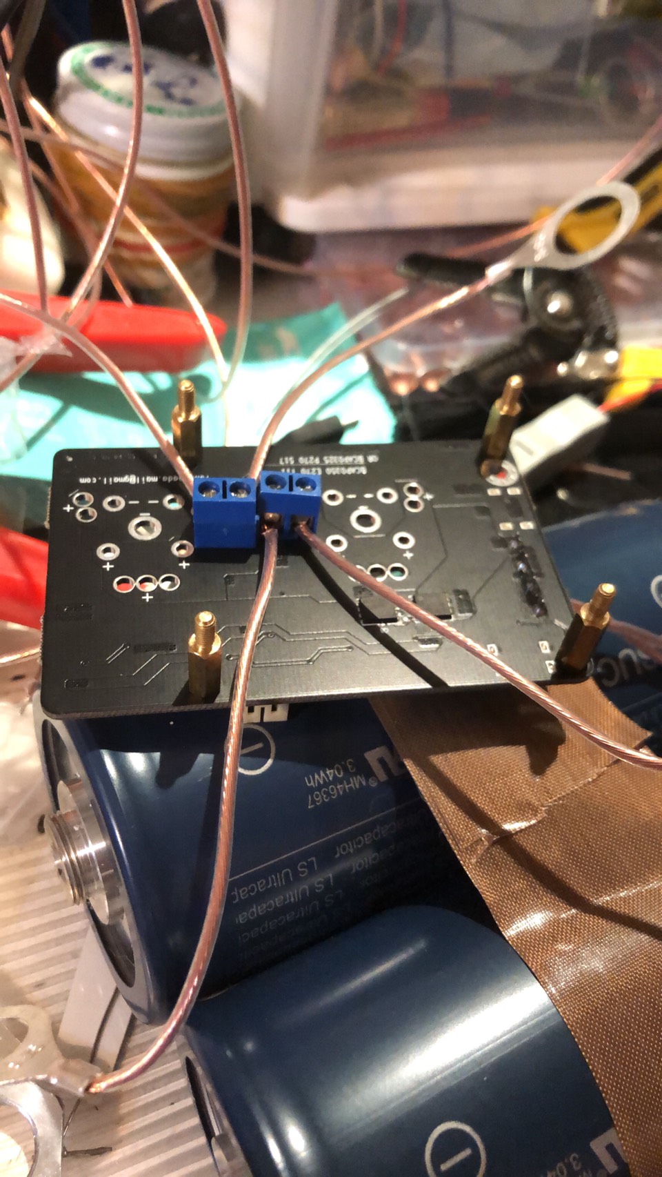

Hi Ian,
After my package was stuck at customs for more than a month it finally arrived last week!
I ordered 4x UcConditioner and 4x UcHybrid
2 of the UcConditioners will charge in approx 15min and are working fine, one is connected to an USBridge Sig after a Shanti power supply (so the ripple must be completely vanished on this ps line ). I will let it run for a couple of days before testing the audible differences.
But there is also a problem: 2 of the UcConditioners are stuck on 3.95v after charging for more than 3 hours.
I have changed the input voltage of one device to 5.20v and now it charges up to 4.19v
They seem to be broken.
What should I do?

Hi Supersurfer,
No worry. It's normal if the sound comes from the instructor during pre-charging stage. Once it turns into conditioning stage (with the conditioning LED lit), the pre-charger will be 100% disabled and it will be complete silence.

How was the Conditioning LED? What are the UCs you use on it? How did you measure the voltage?
What's the power supply. Can you post a picture?

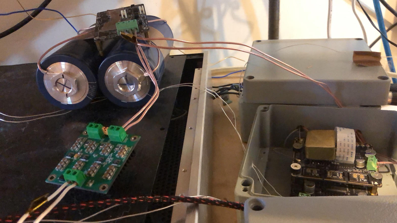

Today I finally tested the super capacitor power supply. I really feel very disappointed. Under the power of UcConditioner, only the low-frequency volume becomes louder, but this may be caused by additional low-frequency noise, but this low-frequency noise cannot be identified. After listening for a while, I started to feel dizzy. At the same time, the rhythm of the sound was slowed down, and there was some noise. This may be easier to hear the middle and high frequency noise.
If someone only hears the low-frequency volume increase, then they think the ultra capacitor power supply is great. In fact, you only hear the sudden increase in low-frequency noise. Even if the hearing is not very sensitive, you will start to feel uncomfortable after listening for a long time.
The conclusion is that Ian's recent new products, from LiFePO4 battery power supply to ultra capacitor power supply, have only negative effects, especially LiFePO4. It is recommended to refer to the products of esoteric, a major audio manufacturer, who uses supercapacitors in the power supply before launching his own products. I don't deny the effect of super capacitors, but according to the actual test results, Ian's ultra capacitor power supply fails.

I think I can see your problem yunyun, I dont think your wires are long enough.
Yeah, I’d probably add an extra meter just to make sure...
Seriously Yunyun, no more than 10cm if possible, otherwise you start picking up garbage and impedance is not at its best. Long cables will render this setup quite useless.
