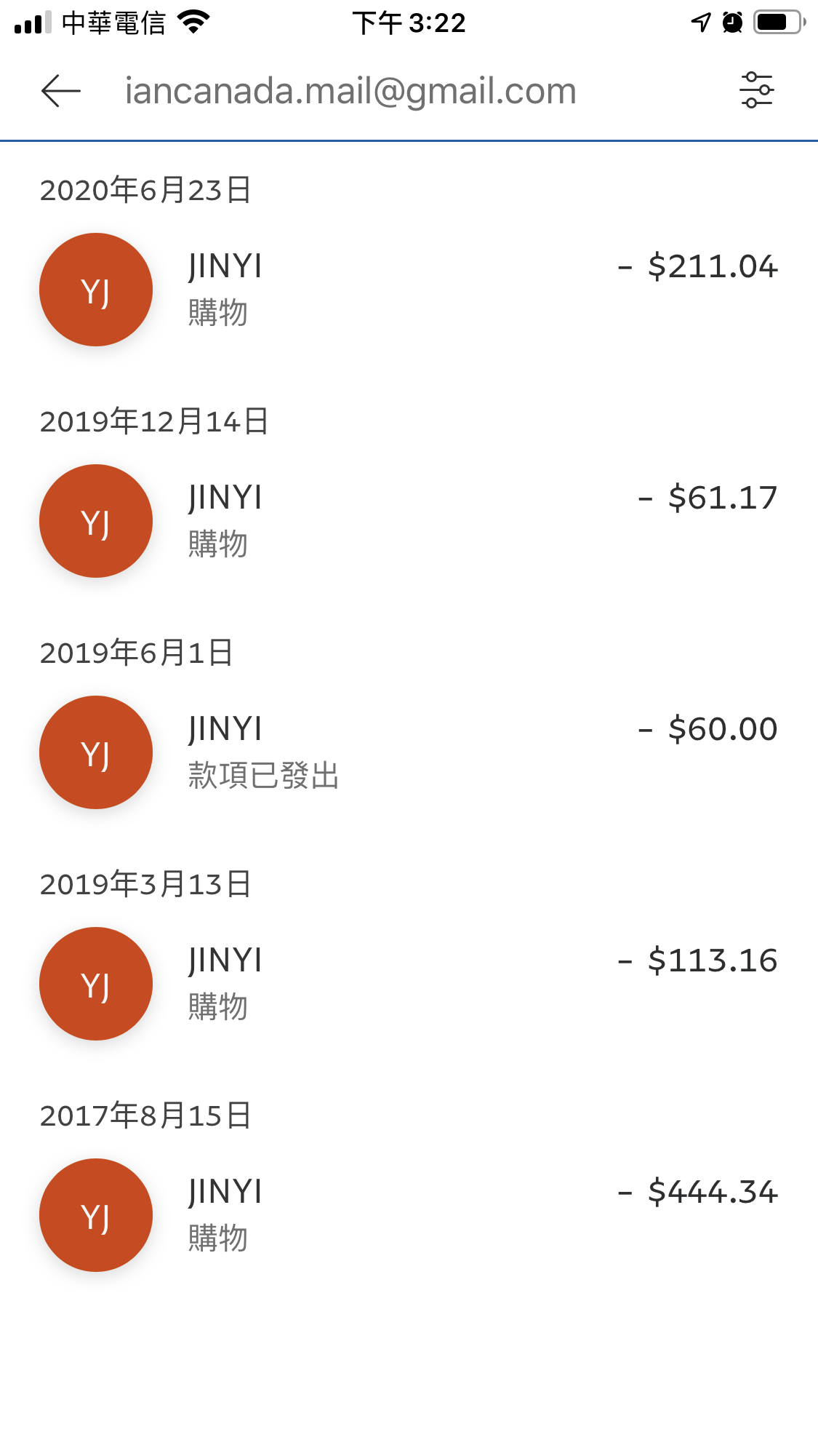

Thank you for your kind reminder, but if you want me to ask why there is a difference between the 3.3V and 5V versions, I don’t think it’s necessary to ask because it only involves Ohm’s law. Under the formula of V=IR, the difference between the 3.3V and 5V versions is of course the resistance. Earlier, I mentioned that I bought the wrong 5V version, and I should buy two 3.3V. I once asked Ian how to change 5V to 3.3V myself, but Ian replied that it is unlikely that I could modify it myself. At the same time, Ian further stated that he did not have time to help me make changes. Even if it was only exchanged, he was not available. So, what else do you think I can ask?
Well, since this site is called DIY Audio, it is to be able to DIY, so I first announced that I initially found the difference between the 3.3V and 5V versions, and then began to study whether to replace the components on the 5V version with 3.3V , I can complete the modification of both modules are 3.3V output. Furthermore, based on these research results, I will redraw the circuit diagram according to my own ideas and change it into a more ideal module. For example, only one Jumpers is needed to switch between the 3.3V and 5V versions. There is no need to distinguish between the 3.3V and 5V versions, and it is more flexible in use.
For example, EA6 and EA8, which can be seen everywhere on the board, are reference voltage ICs. ICs of the same brand are linked as follows. The datasheets of EA6 and EA8 have detailed instructions on how to use them, and then compare the relevant components on the board to easily draw the circuit schematic.
Diodes Incorporated|Diodes Incorporated AZ432ANTR-E1|Voltage References|LCSC
Since this may infringe on Ian's intellectual property, I will publish the designed circuit diagram file for free, without involving commercial activities, and only provide it to those who are interested in making changes.

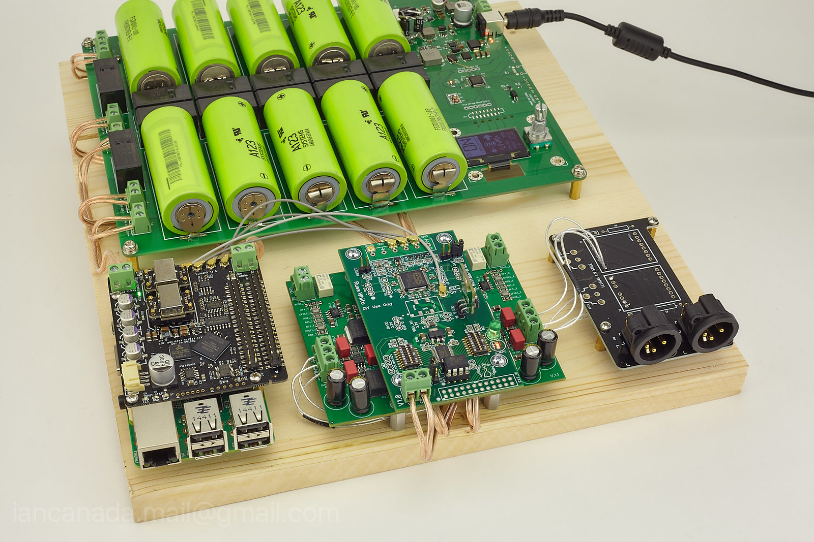

After the test, I feel very disappointed. ConditionerPi did not bring any improvement. Maybe I already use an isolator, and any interference from Pi has been isolated.
In this way, UcConditioner is probably the same. I bought Ian's new toy, but I didn't feel more happy for the first time. I have bought more than 800 dollars in total, and I shouldn't buy it again.
Hey Yunyun,
I see you are using stock clocks here. They are very bad and I would look to replace them asap. That is by far the limiting factor, I cant actually enjoy listening to music with them regardless of optimisations I have made.
I know Ian has built the UcConditioner to help the raspberry PI, but that is genuinely like trying to polish a turd when it comes to replaying audio in my limited experience. You would be much better of using an allo usbsig (I2S) if budget restratined, which will be okay. If you really want to go all out, get a good USB to I2S board - slave it to the FIFO (obviously with better clocks) and an excellent USB source. J-Cat USB XE is a better USB source - compared to say a USBsig, but at a price.
Drop me a pm with your entire stack and configuration, I will try my best to help you get more out of your investment.
Edit: Forgot to mention, stacking anything as noisy as a PI or even a Usb sig under the FIFO - is far from ideal. If you do, at least get some copper tape, wrap it around some card and then protect it in kapton tape to reduce upwards radiation.

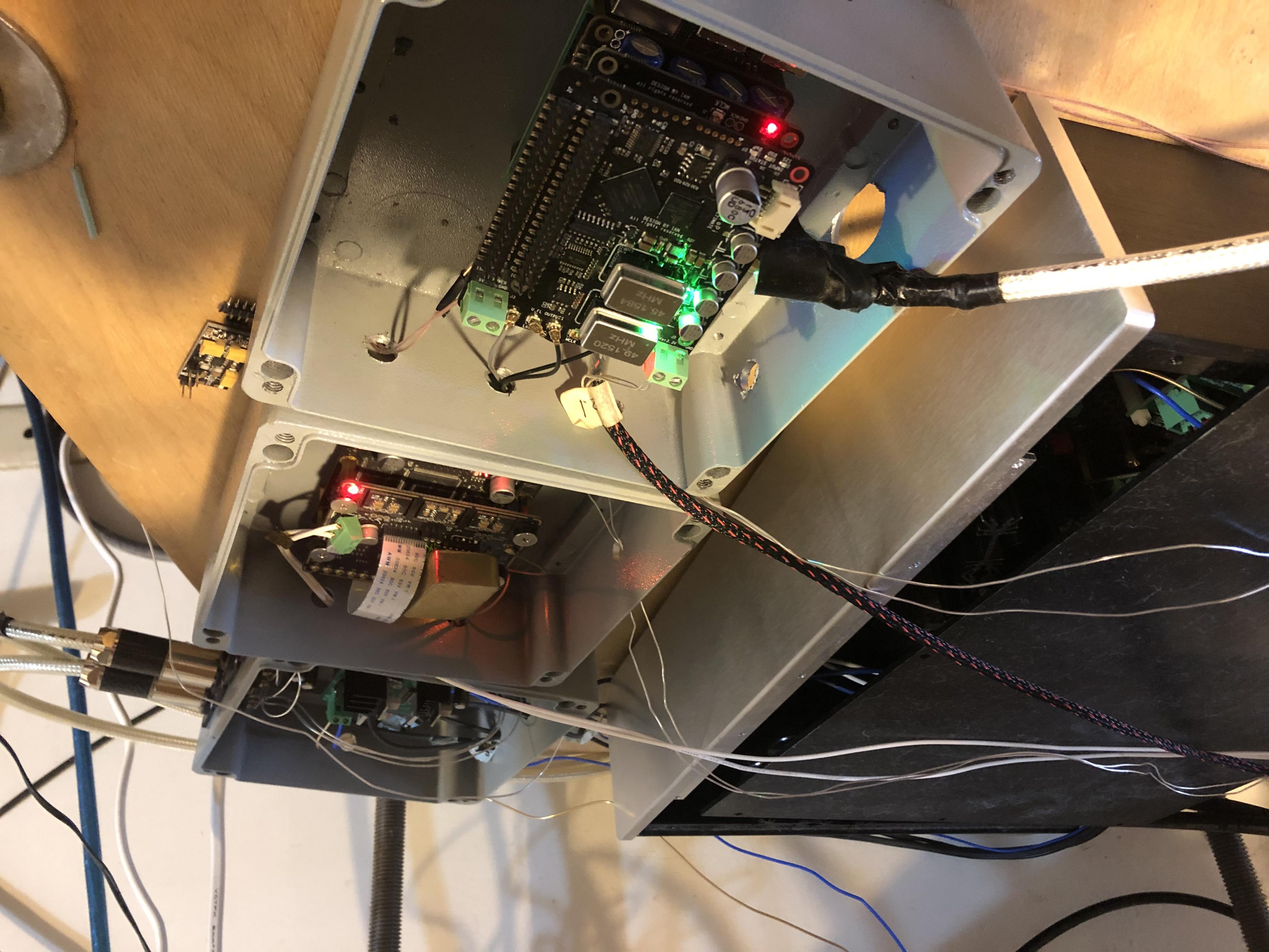

I suppose, in the nature of DIY that YunYun and Andrea are advocating. That I should take the time to add my experience with Ian's ultracapacitor and LifeP04 supplies.
I have been tinkering with Ian's DAC since September and introduced ultracaps to every 3.3v rail and the sonic gains were significant.
Upon the release of his Mk3 board and UCconditioner range, I decided to implement them slowly. The MK3 board, may have made an improvement but nothing substantial - however the firmware upgrade for 5v was welcome. I was sceptical that 3.3v UChybrid boards would make a negative impact vs them being hardwired and balanced by a single resistor - I always go for simplicity where possible. I was pleasantly surprised that there was no degradation to the power supply and it sounded the same before.
(Tangent) I then upgraded my ESS dac to his new 9038plus.. That was a surprisingly decent step-forward. Clearly a better thought out design. Increased copper, meant I had to do less to combat the RFI/EMI from the clocks underneath (I still do) and there are no more components underneath that could potentially create a short.
Auralic Vega G2
I then introduced the 5v Ucconditioner to my digital source, clean side of my USB board and the battery board. Underlying supply for the external 5v was the Shanti, which I would consider an average power supply at best (despite its low noise rating). This combination surpassed my expectations, so much so I have sent them out on loan for confirmation.
At that point I wanted to base-line the DAC, so I started looking at comparable ESS designs. I ended up choosing to get a Auralic Vega G2. ESS SDM conversion and lots of marketing material around their clocking and class A output stages, seemed like a good benchmark for it. I wasn't expecting the Ian dac powered by the Battery PS and Ultracaps to better it. Well I was in for a big surprise, it far surpassed it and I sent the Vega G2 back three days later. I tested without the ultracaps and the results were a lot closer, but still lent towards the Ian Stack.
It has taken a significant amount of optimisation to get to here though.
With further testing with friends, I would say the ultracap 5v board would improve most supplies. Providing that the cables are thick and location to target is as close as possible. What we did find though, is that if the powersupply was good enough the impacts were less. For example, the MPaudio 10x LT3045 (single rail) had a very very marginal improvement if at all. Importantly though it didn't negatively impact it.
I am on the group buy for Andrea's clocks and looking forward to see what that brings to the Ian dac. I also plan to buy his entire R2R stack, to compare. Great to have options and a bit of healthy competition.
https://ibb.co/kGzDZYH
UcConditioner should be really useful, because if conditions permit, UcConditioner can directly provide 3.3V to the digital circuit, and avoid using LDO in the digital circuit.
However, we can't avoid using LDO on the raspberry pi, so ConditionerPi is not really helpful, which is easy to understand. Even if I can learn from theory, I still try to buy it directly, but I advise everyone to stop wasting money to buy ConditionerPi. As for the LDO module used to charge the super capacitor, there is no need to buy it specially, unless you don't have an LDO module on hand. The reason is very simple, let me say it again, as Ian himself said when UcConditioner is supplying power, it will no longer use the current of the charging LDO module, so no matter what is used for charging, the overall effect is the same. . In other words, the short life and expensive LiFePO4 is not worth buying.
When you use Auralic Vega G2, because you can't directly input 3.3V, you can't fully obtain the advantages of UCconditioner. You should buy Buffalo-IIIse-Pro without LDO.
