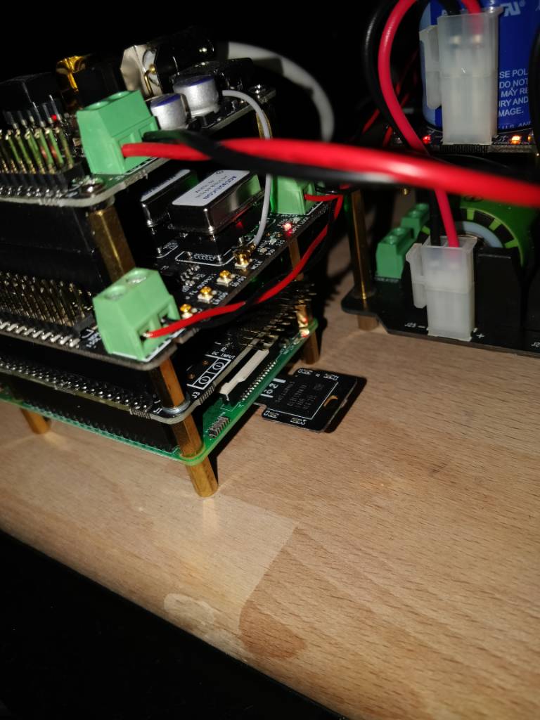

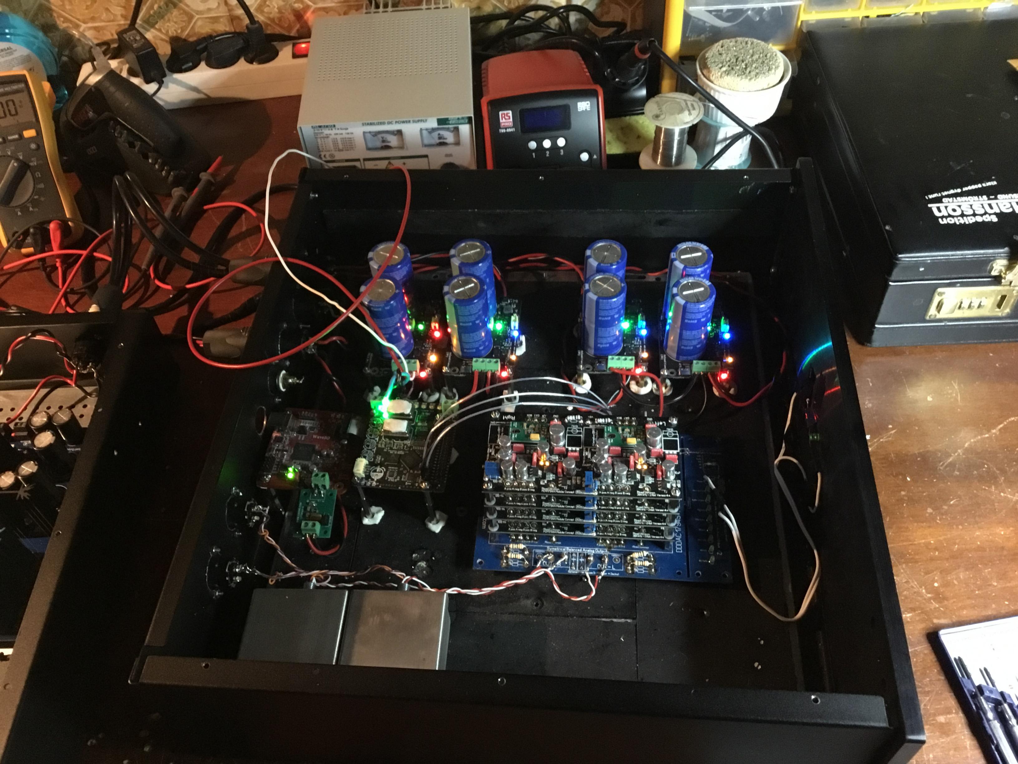

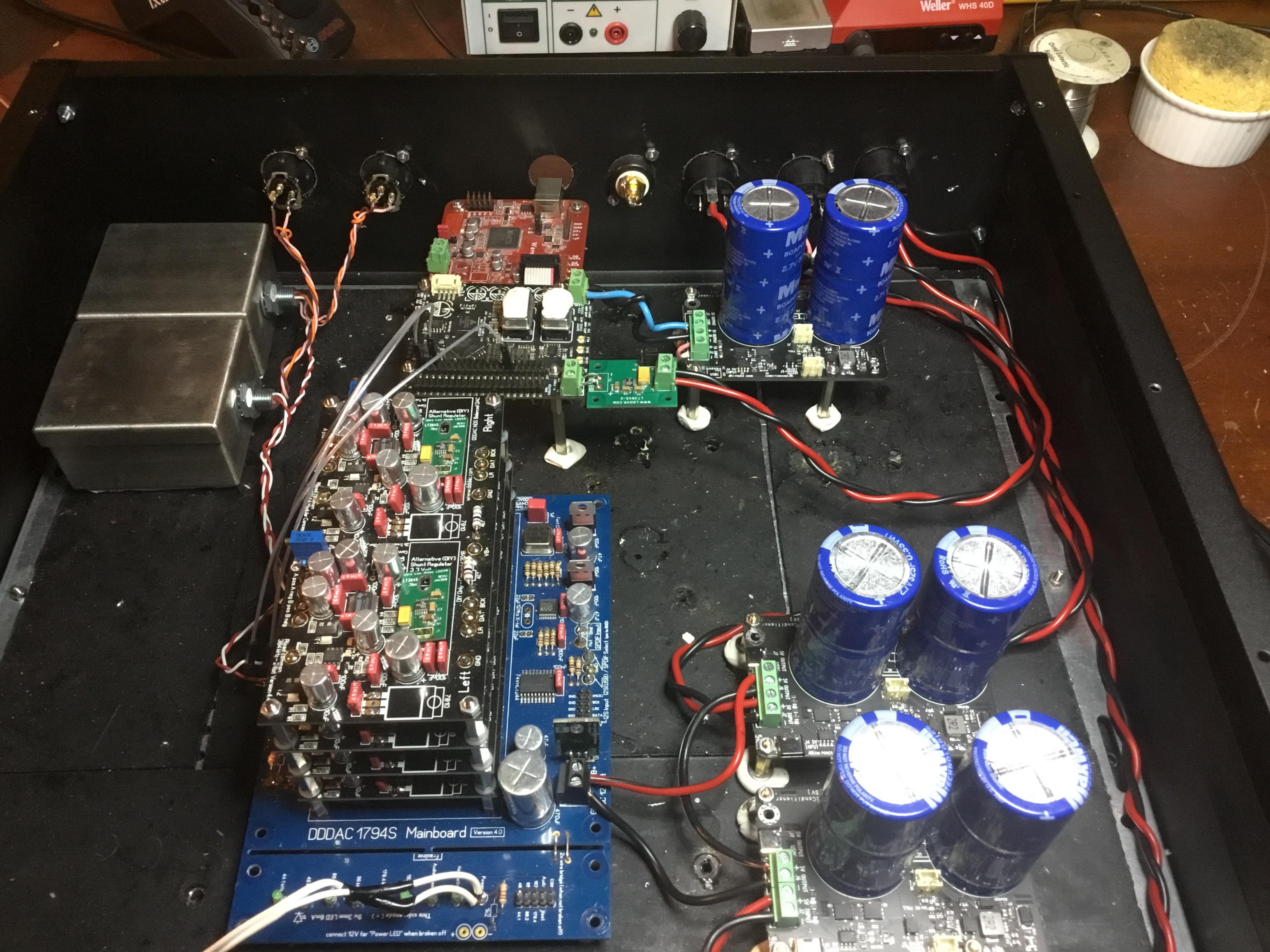

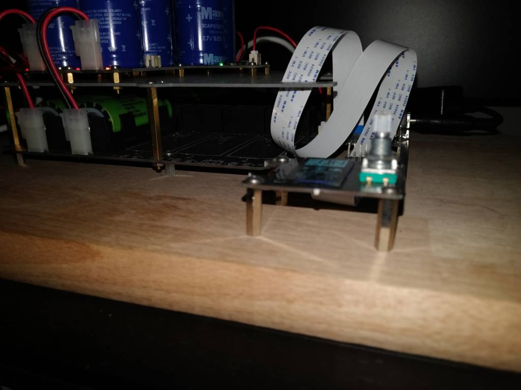

Ucconditioners installed. Dc in on right side and analog out via Sowters left side.
The first days I was playing without the Sowter transformers (doede special edition), and I felt something was missing. The sound was clear and detailed, but listening fatigue was knocking at my door, hmmmm, what could solve this,,, then I come to think on my Sowters, which sounded over the top bass heavy when my dac was using a big choke psu.
Doede’s Sowter special specified trafo’s seems to hit the bulls eye in combination with Ian’s Ucconditioners. I have decided to ad one more conditioner on fifopi to replace the 5v reg from Ldovr.
Anyone else using this conditioners and want to share their listening impressions ?
Ps; when the picture was taken the wires from fifopi is not connected to mainboard dac, if someone wonder.

Yes, do that. You won’t regret it. Ian’s UCconditioner on FiFoPi isolated side is a real upgrade.
I have UCconditioners also on the unisolated side, and on my dddac tower. The sound is very detailed and with a strong/tight bass, just love it. But, and this is important, If your setup has the slightest sign on giving you listening fatigue it can tip over and end up wrong at the end.
How did you add this to the DDDAC tower as that runs on 12 volts? Two of the conditioners in series equals 10v
Hi Simon.
I have removed the 7810 regulators on the dac boards, and what’s left is the 8v tent shunt regulators. 10vdc in on the tent shunts is working fine. I have been using 10vdc in on mainboard for several months without any kind of problem. I know Doede prefer the 7810 regs in place, just to be safe i guess, but I took the chance, and so far so good.
I also like the sound better without the 7810 regs.
