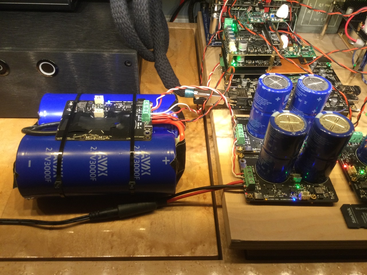

After the positive comments from Greg about the huge 3000F ultracapacitors I tried them myself.
I got me some AVX samples and tapped M4 thread in the poles (after measuring the thickness with a metal thickness measuring instrument from work) to connect the wires.
I also tried aluminium welding some tabs but the aluminium is not a weldable type.
The UcConditioner is attached and charging needed about 4 hours.
They are now feeding my USBridge Sig.
This is real overkill but I must say that I hear a positive effect in comparison to the previous setup with 2 UcConditioners in parallel (to the right in the picture)
The sound seems a bit more open and transparant, low registers are a tad more detailed.
Are there others that have experimented with these big caps?

I have sine solved the problem with a few changes
1) the laptop power supply I was using was extremely noisy the worse I have seen. They are not all equal. over 200mv of complex ripples a Toshiba one I had was a night and day different 5mv. I have since switched to a low noise linear power supply off ebay to be on the safe side.
Even if your system is running on batteries a really bad switching power supply running in the Lifepo4 could send waves in your system even your entire house.
2)I installed a dedicated line for cleaner ground with no switching supplies on that line.
3) used a star grounding system to avoid ground loops
I grouped the ground in the streamer I am building in 2, Chassis ground that is grounded to house power line earth, and power ground. Now it will be easier to AB test (connect power ground to earth ground or not) so far it is close I will do some more sound tests later and decide may connect them via a parallel (resistor and x2 capacitor)
