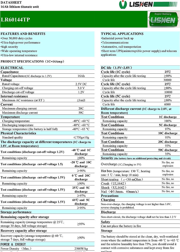

Can UcConditioner 5V be used for Lithium-titanate battery? The output voltage of LTO battery is relatively stable and the internal resistance is also very low. LTO also has the characteristics of fast charging, so LTO has better electrical properties than supercapacitors.
LTO is safer than LiFePO4, and is more suitable for use in audio applications that do not require high energy density.

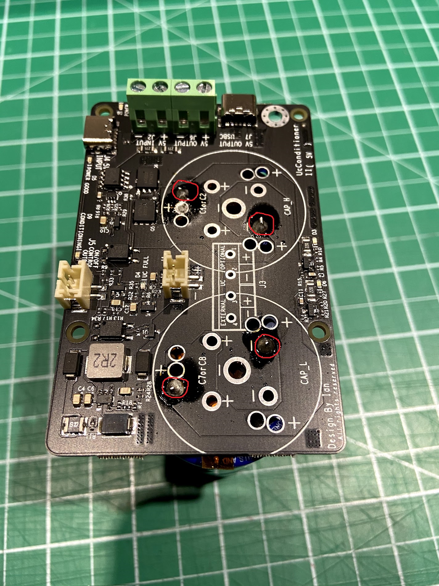

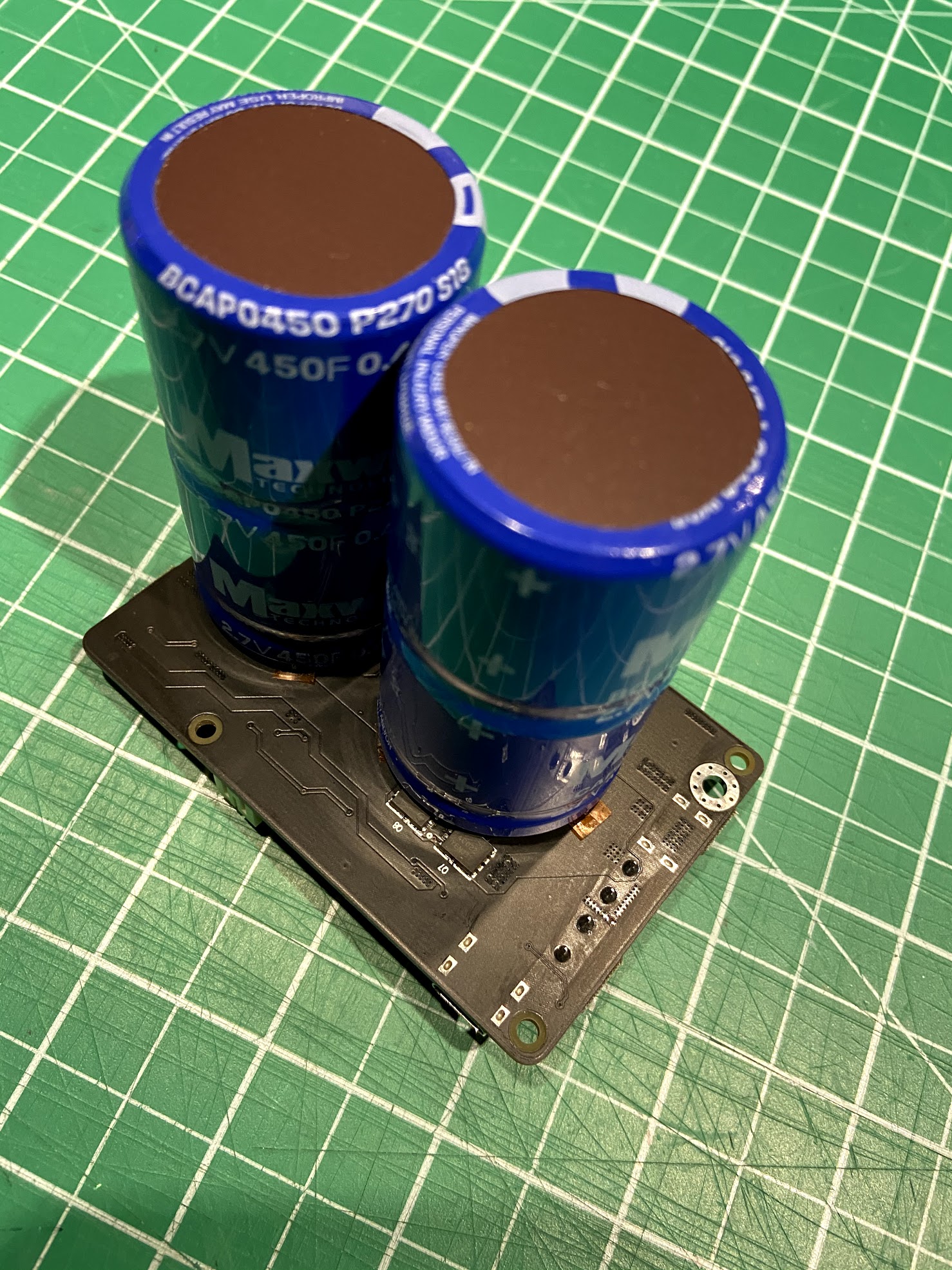

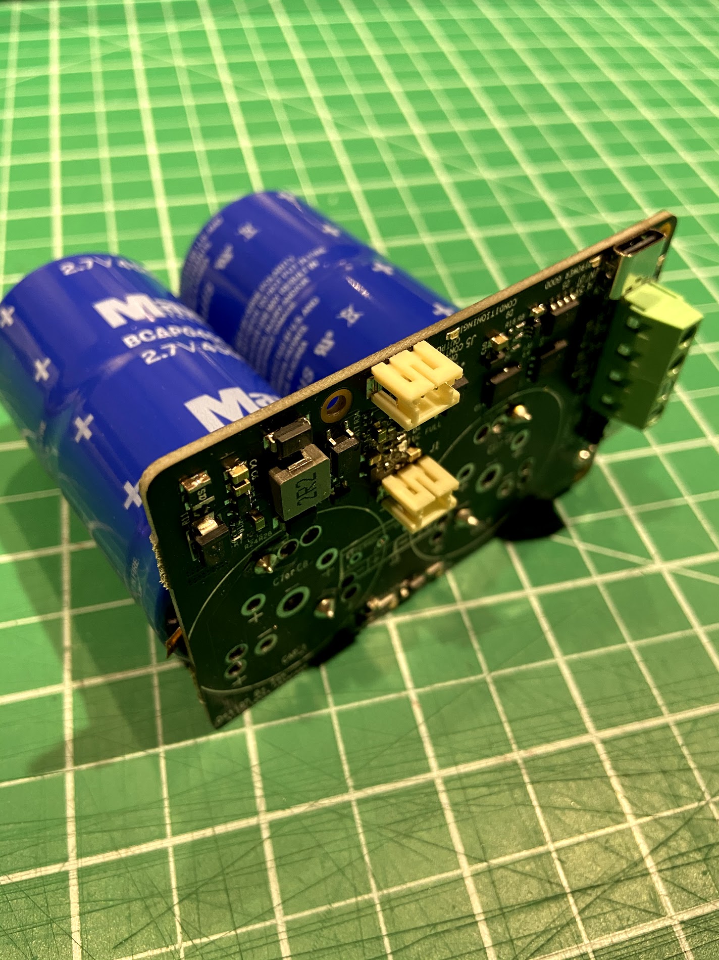

UcConditioner New 450F BCAP0450 P270 S18 mounting solution
I understand that the ultra-capacitors are now having very long lead time under this COVID situation.

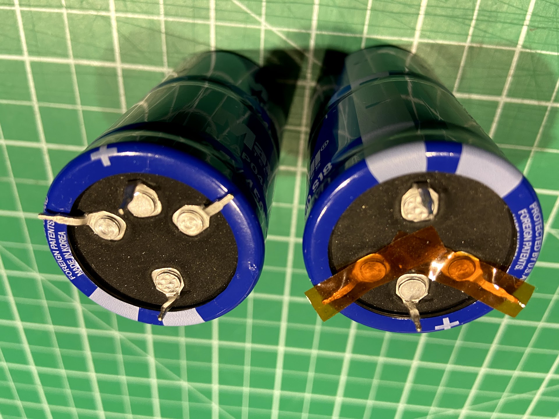

But just found the new MAXWELL 450F BCAP0450 P270 S18 ultra-capacitors are still keep in stock. This ultra-capacitor will be great to work with my UcConditioner. But the footprint is different.
Now I have solution to mount them to my UcConditioner.
1. Bent the two NC pins and then cover with tape to avoid any possible short circuit.
2. Solder the two 450F UCs to the UcConditioner at the bottom side of the UcConditioner PCB.
3. Make sure + and - are at correct positions.
Please refer the attached pictures for details. Please let me know if you have any questions.
If it is required, you can disassemble the input/output terminal block connectors and then flip/solder them to the other side of PCB.
Good weekend.
Ian

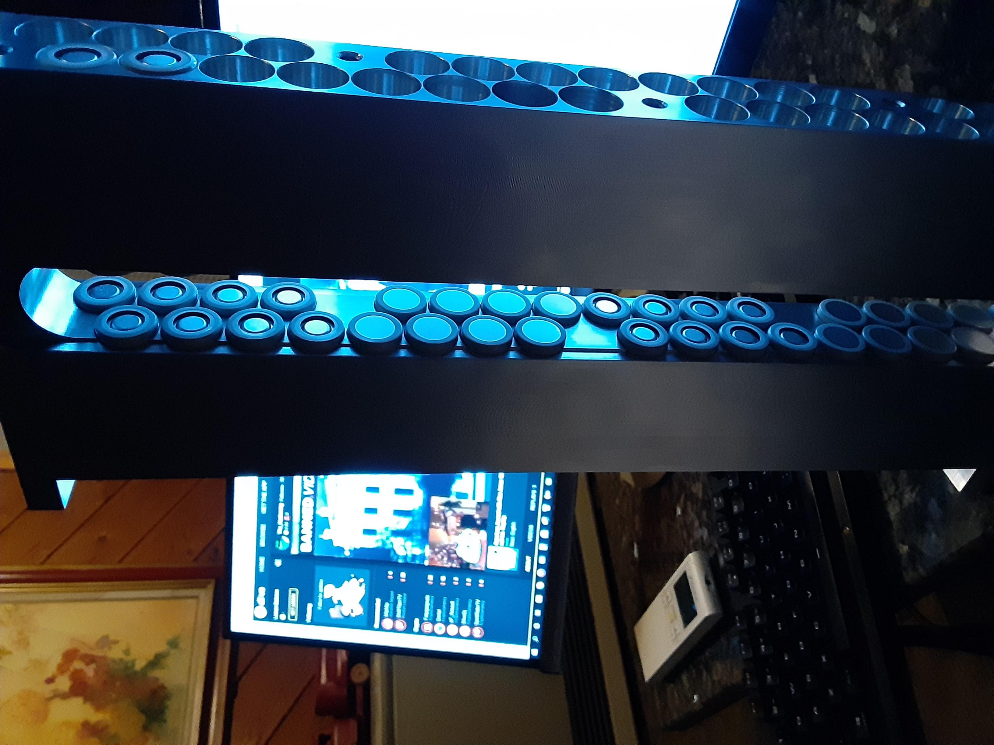

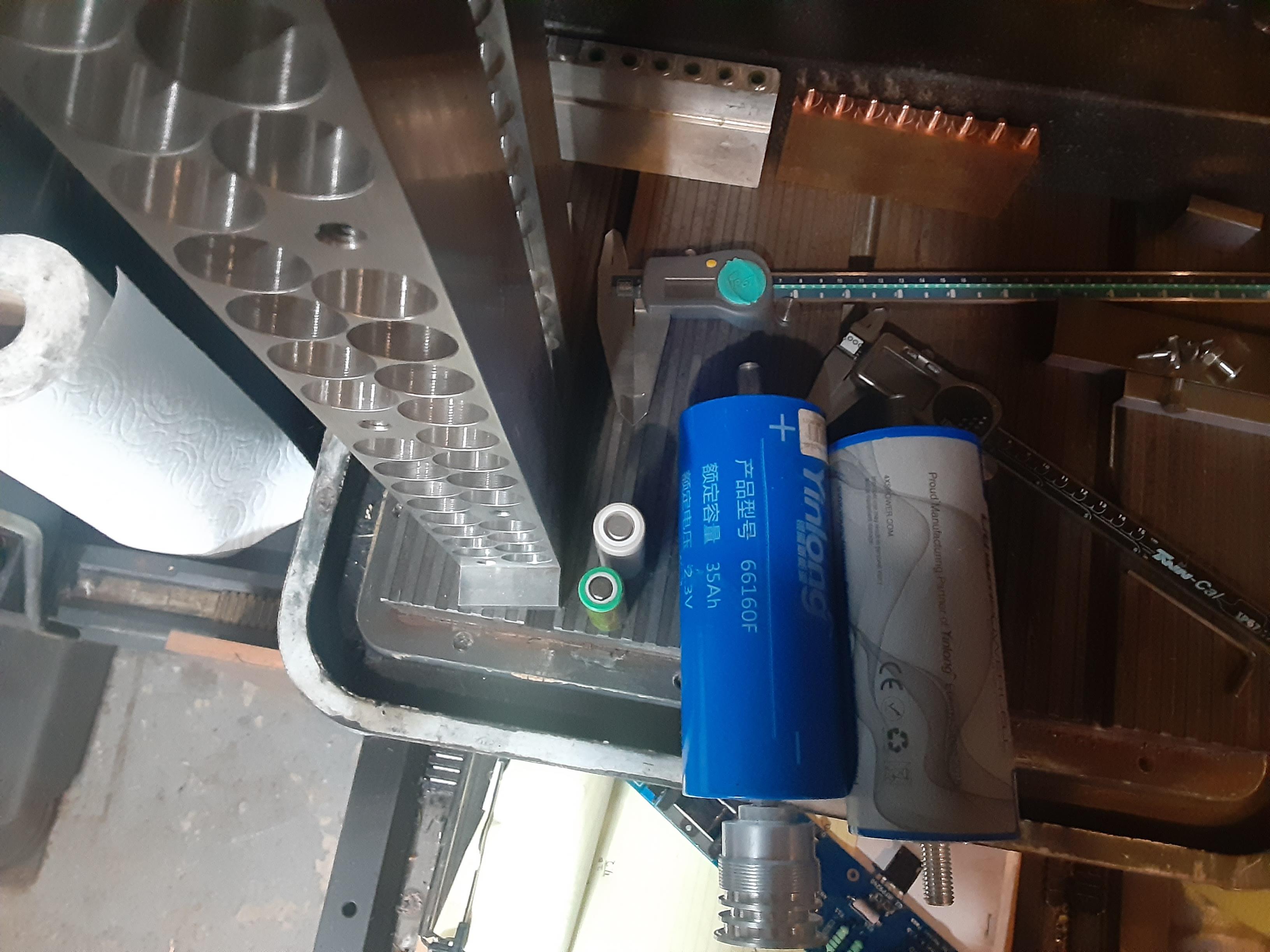

Nice to see alternative power schemes! I'm almost a year into a full system battery powered project. I was using the 2170 lipo, but lately I'm working very hard to get a LTO system developed. Here's to stored energy :cheers:

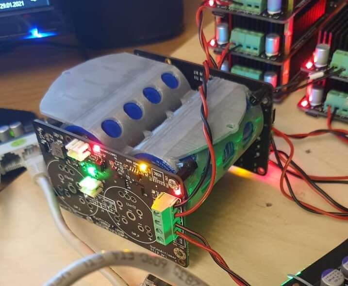

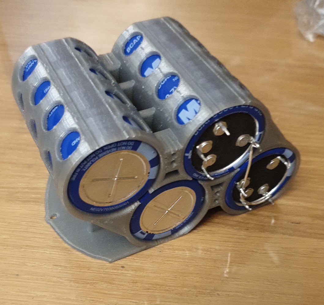

My version is for a more compact placement in the case.
A trial version, the racks are 2.5 mm after the epoxy glued.
I can share a 3D model.
