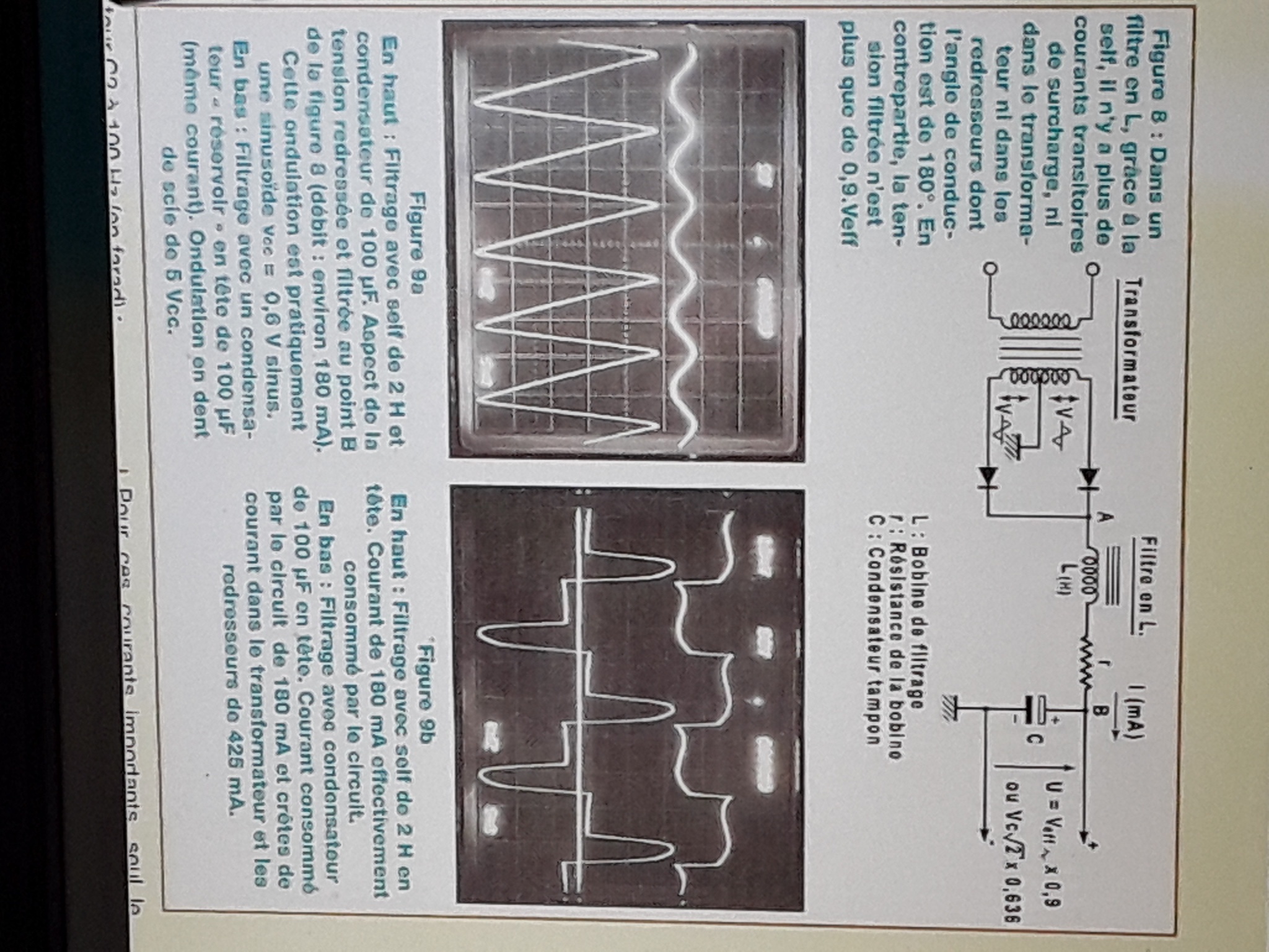

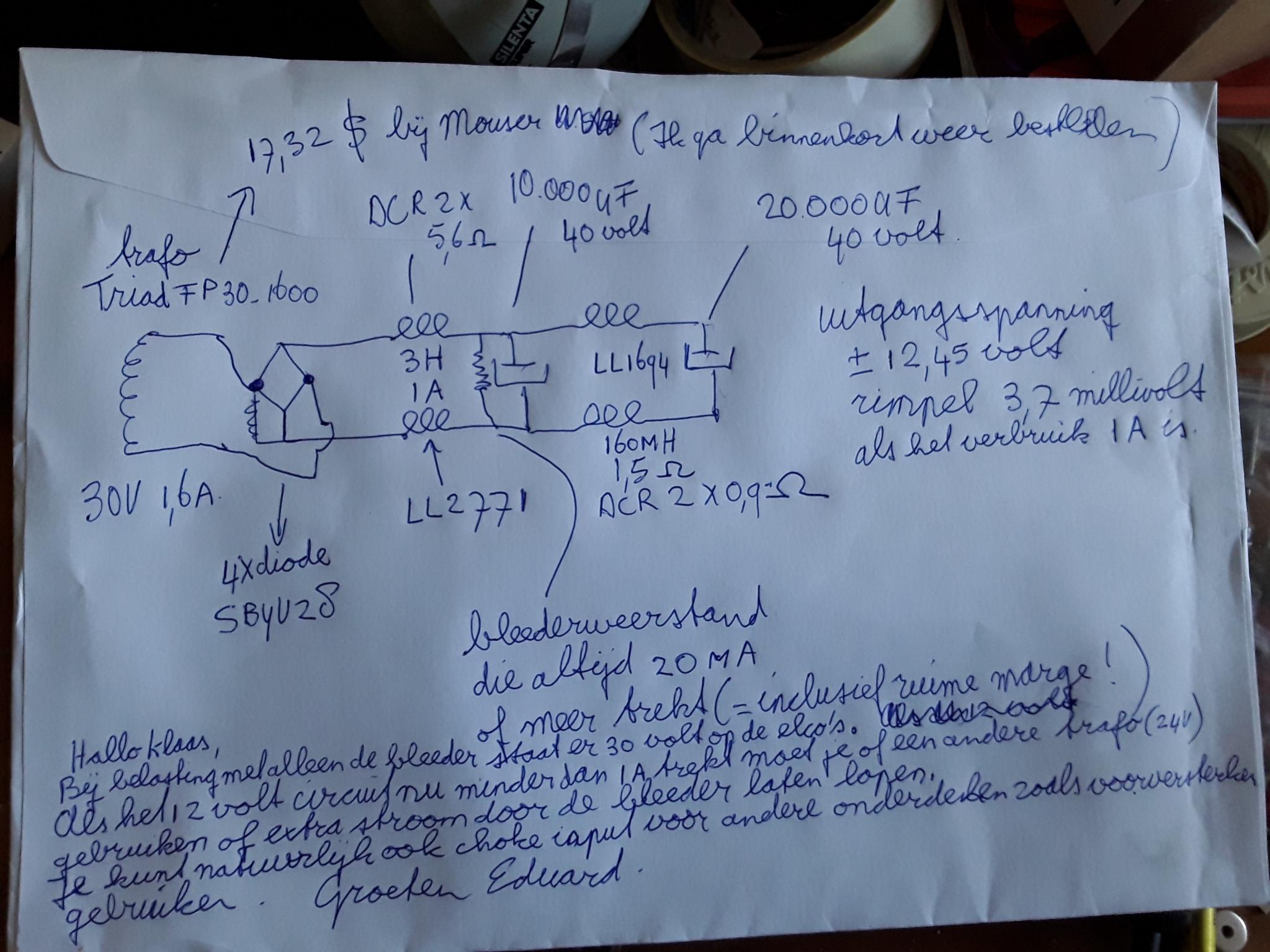

Hello,
I just ordered parts in Canada.
Because i need to order chokes anyway i decided to make an LCRC supply followed by an LM338 . Will use one for the LIfepo4 and one for a Roon nucleus.
The 350 mH 4A input choke will get rid of a lot of garbage coming out of the wall, the switching from the rectifier ( because there will be no switching) and the charging pulses.
With the Roon it will probably work both ways because it is full of switching supplies.
Psud will show a gentle rise of the voltage and a ripple close to 1 mV.
Some experts say that the amount of ripple isnt that important because of the regulator. It is more about things the choke can do and the regulator cannot.
Maybe in the lifepo4 it will be mainly the 5 volt supply that will profit because they lifepo4 could be disconnected from the charging circuit once they are '' full ''
The manual is not clear and Ian not answered . Can i create 3,3 volt each with two or more in parallel to give them a bigger energy level???
Greetings, Eduard
Hi Edurad,
I attached the schematics you sent me by email.
I think it's OK as the DC input of my LifePO4. But the only thing is that, when you turn on my LifePO4 power supply, all battery rails are disconnected from the input, so will be no business with the quality for the DC input. But still better than a switching mode power supply for reducing overall EMI noise into the environment.
Ian

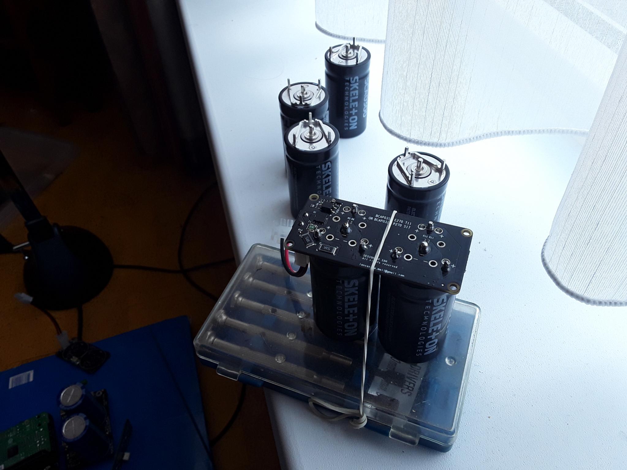

Hello,
Just a small update . I just received the Skeleton caps i referred to in post 1471.
They fit exactly onto Ian's boards and they are made in Germany . A bit more expensive than the other ones but if built quality can predict sound they are perfect.
The French already performed test with caps in the eighties if they could turn them into a electrostatic '' speaker '' by causing parts inside the cap to vibrate. Because vibration specs are often mentioned in supercap datasheets this could well be something that needs some care. The Skeleton cap has 4 soldering pins just like the Maxwell. But the Maxwell just uses two as a terminal and the other two for securing .
The Skeleton has a '' center '' connection for the negative terminal and 3 pins for the plus .
Greetings, eduard

Hello,
Just soldered the first pair of German supercaps to a 3,3 volt UcHybrid board. I held the caps and board in position with an elastic because you dont want them to move during soldering and during cooling down. As you can see the contact area for the plus side is BIG so heat will be transferred from the soldering spot quickly. So must take care of a firm contact on the soldering spot to reduce the change of a bad joint because of to low temperature. The soldering " area " is just a tiny ring to a bit difficult to get maximum heat transfer.
I think that there will be bad soldering joints around when not enough wattage is available needed for the supercaps.
Greetings,Eduard

I understand that the ultra-capacitors are now having very long lead time under this COVID situation.
But just found the new MAXWELL 450F BCAP0450 P270 S18 ultra-capacitors are still keep in stock. This ultra-capacitor will be great to work with my UcConditioner. But the footprint is different.
Now I have solution to mount them to my UcConditioner.
1. Bent the two NC pins and then cover with tape to avoid any possible short circuit.
2. Solder the two 450F UCs to the UcConditioner at the bottom side of the UcConditioner PCB.
3. Make sure + and - are at correct positions.
Please refer the attached pictures for details. Please let me know if you have any questions.
If it is required, you can disassemble the input/output terminal block connectors and then flip/solder them to the other side of PCB.
Good weekend.
Ian
Ian, if going this route, is there any reason not to break the tabs off of the two taped contacts and then tape over as well to reduce the risk of a short?
Hello,What is the part number for these cap? I assume they're working without issue? If they're not available in the US, I'll try Ian's larger solution.
They are available at Mouser. The datasheet is in post 1471.
But you need a powerful soldering gear.
Greetings, Eduard.
P.s i am happy i went for this solution.
