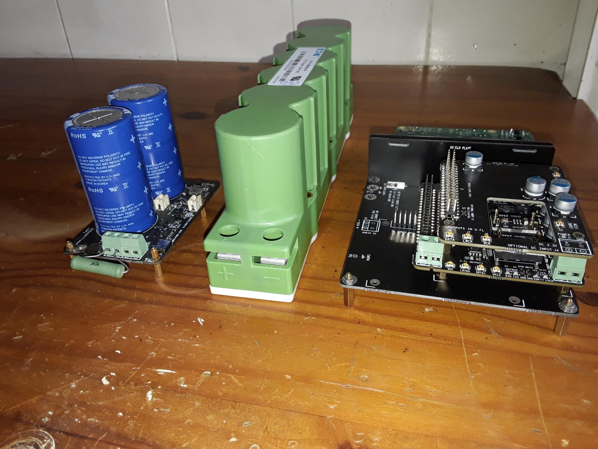

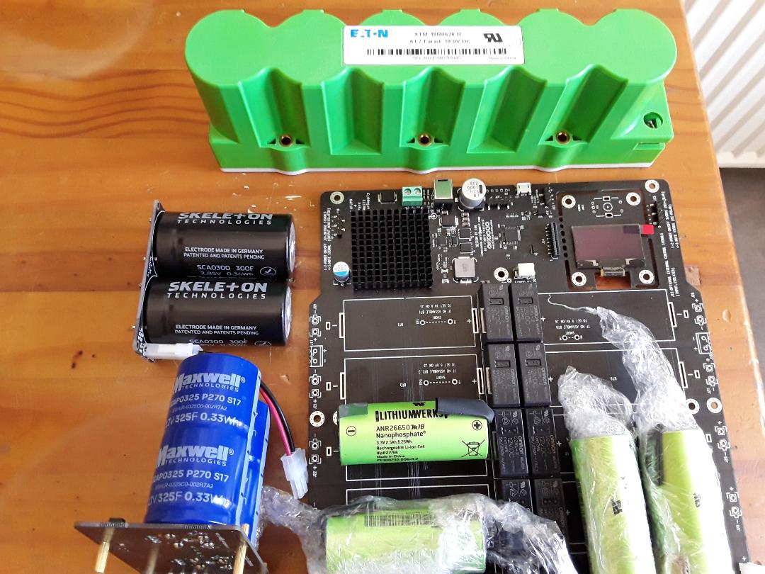

I am going to do the same. 5 volt on the lifepo4 assisted by the 5 volt UcCondtioner to feed the raspberry.
3 3,3 volt lifepo4 with each their own UcHybrid board to feed fifopi, sts and reclockpi separately
And one 3,3 volt lifepo4 without assistance to feed something more....
But i am not using the UcAdapter kit because i think it will make more sense to mount the stationpi above the lifepo4 board . As far as i can see now i will be able to have some aluminium panels lasercut that will allow me to install the supercap boards i need and the stationpi board on a surface not bigger than the lifepo4 board.
I hope you will get the support needed now the clock debate has faded.
Could it be the supply that you are using for the lifepo4 board.
Yesterday i installed the lifepo4 cells. Before mounting i discharged them because they were send to me fully charged. All around 3,2 volt or more. . The manual states you have to discharge them before soldering. Of course as safety measurement but i guess it also needed to have the charging process with connected supercaps to work as designed?
I was surprised how much energy these little cells contain.
Greetings,Eduard

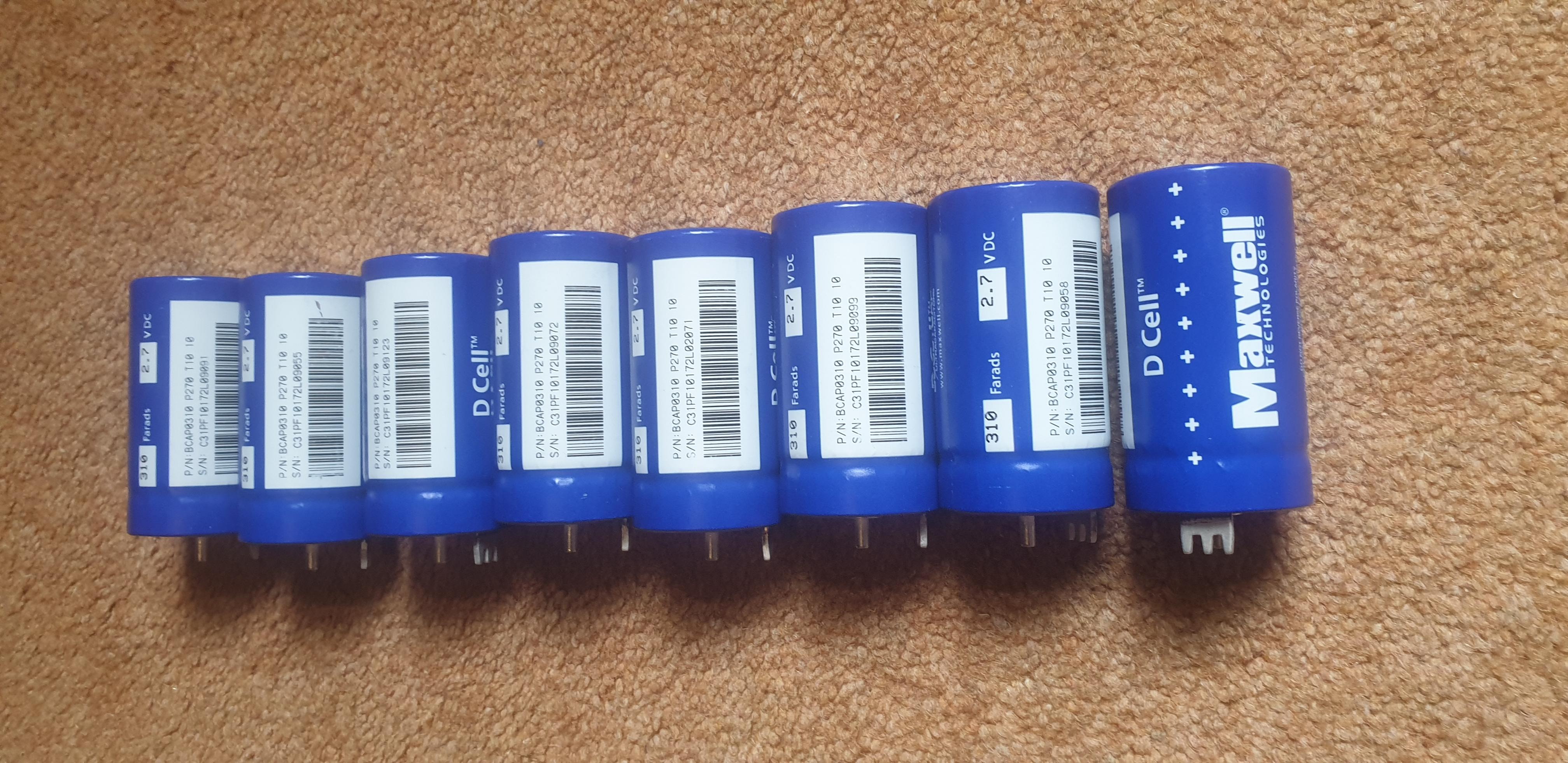

I hope you dont mind my offering these here. I bought these after getting involved with Ians products and reading this thread.
I have 5 pairs of Maxwell BCAP 0310 P270 T10 for sale.
The other pair are soldered together whilst I tried them.
I decided that discretion is the better part of valour to save me blowing up the house, wife, cat .
Purchased from a reputable seller. Genuine Maxwell.
Details in the swap meet but preference given here

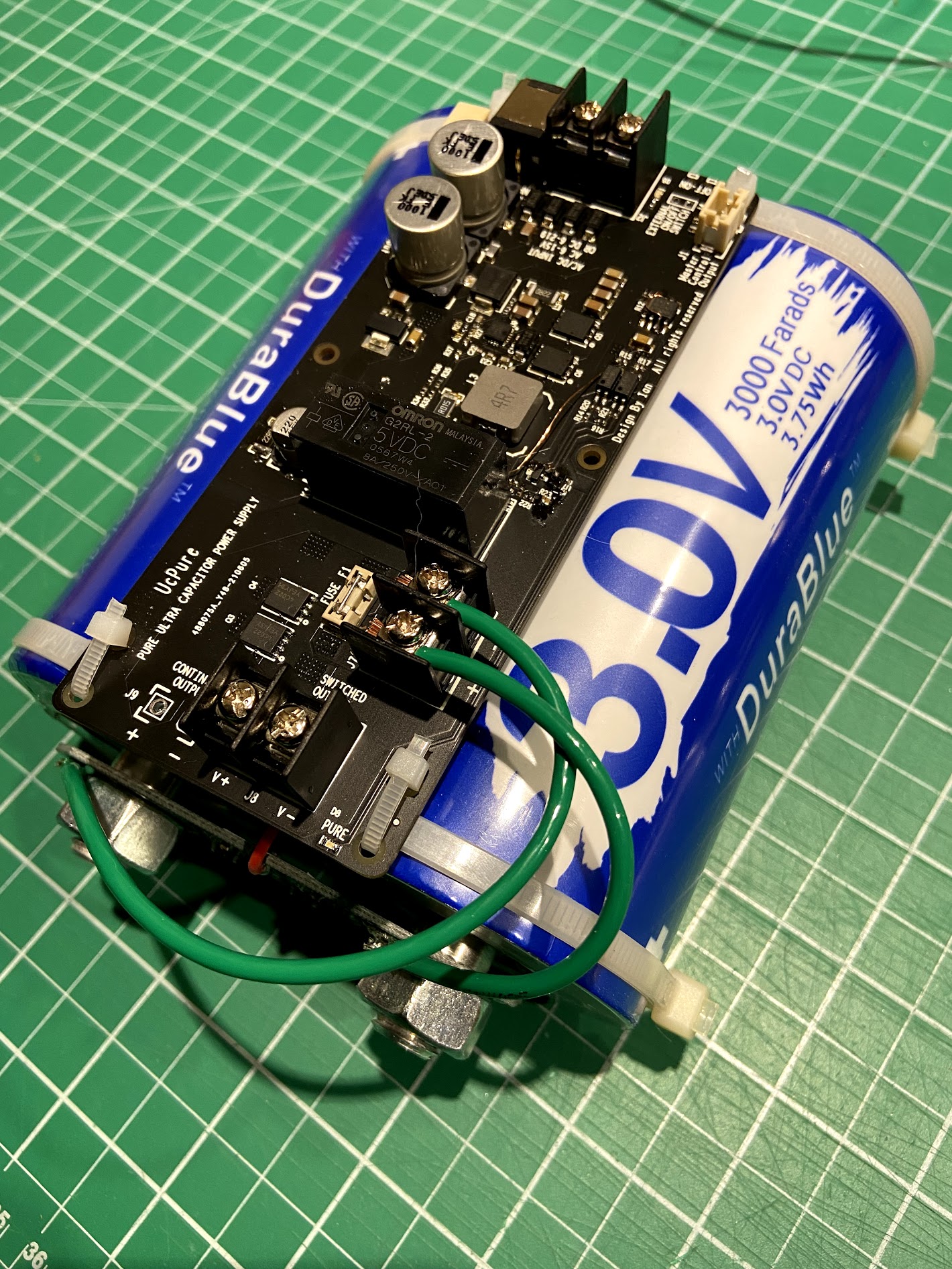

I know I'm a bit crazy too. But I have to say this could be the best 3.3V power supply is the real world.
It's a UcPure 3.3V configuration with 3000F+3000F ultracapacitors pack. Only ultra capacitors will apply to the circuit when power on. So nothing compare.
UcPure can be in three configurations:
1. 3.3V (two 3000F)
2. 5V (two 3000F)
3. 15V (six 3000F)
Ian
