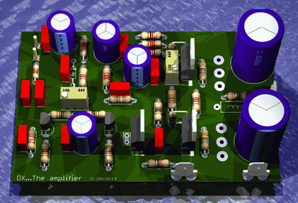

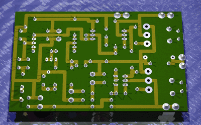

I am also producing some Artistic board with real parts over it.
To show the amplifier, in a more real manner...but for sure will not be so pretty as Greg's work.

... now we are all getting crazy about professional PCBs, - right?
I got infected end of last year.
Now you..

I really think that those things are really foolishes.
Also i think that we are not professionals, we are hobbie guys and we do not need those things....to compete with professionals....waste fo time!...no money will enter to compensate your effort and you will have only the possibility to open the amplifier case to show the unit to your near friends.
Your friends may think that you made enormous effort to convince them that you are a professional..when you are not...ahahahaha.
A little bit ridiculous in my point of view...but there are hundreds that apreciate those things...they use to say that if you have to do something do it perfect.... they are programmed alike computers, they cannot think about the time losses because of that and many consequences that will produce inside friends mind..some ideas this behavior may produce can be not so nice..
At least he will not be considered a "pig" alike i am....ahahahahha.
If you search for "full throotle construction of amplifiers ", you will see that i do not bother with those things...i love to make them fast to listen them as soon as possible and finishing to construct another one...and another one...and once more..and repeat all that maniac behavior in the next week, month and year...... i am also fanatic and sick alike many folks...i am not exception....i am crazy inside my own way.
This is something i asked Greg Erskine, my dear friend, as i want to have people constructing, and i have failed related that as i am very bad to make Propaganda about my own things....the pretty board is to atract people to construct.
I am also constructing a pretty circuit, in the real world, to show how pretty this construction can be ...a non working circuit with pretty coloured parts only...as mine working things are ugly and do not make a nice presentation of the product.
I want to give a chance to myself to show some ideas to forum friends, and also to give them a chance to realise some ideas.
That "simple amplifiers can sound so good, or even better than sophisticated designs"...but i think people do not want to face this reality...that's what i am starting to believe, to conclude.
PCboard was made...copper lines layout, professional schematic provided, general informations offered, the chance to the one make his own version was offered too...but no one had intentions to construct till today...let's see the future.
When the first one construct and evaluate positive... a boom of guys will go to do also....this is a normal "mechanic" of human behavior.

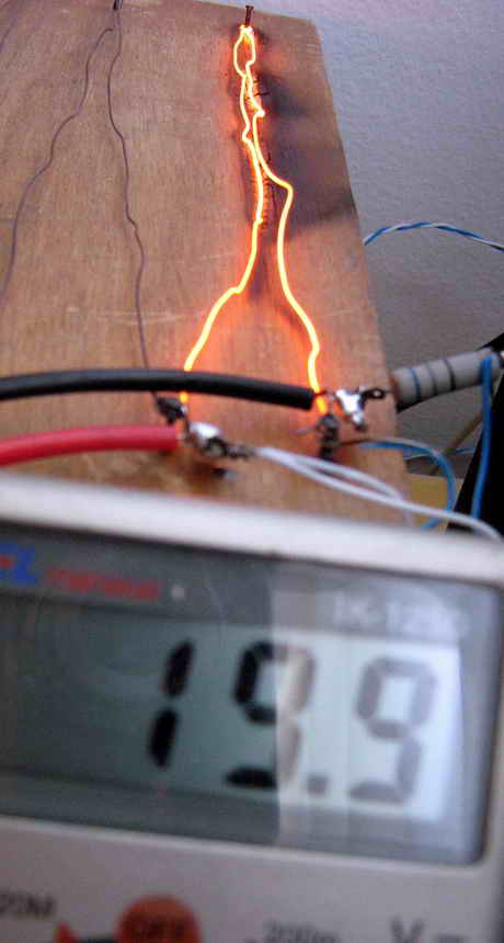

Big carefull with this amplifier, it is male, macho, stallion...be carefull if you
... do not know exactly your speaker power...hehe...carefull as this one may send your speaker to it's ancestor land.
The signal used is sinusoidal...and undistorted, as 35 hertz is hard to listen with the monitoring level i am using to the speaker...you start to listen when the audio wave start to clip.
This is pure sinusoidal, continuous, using normall transformer that loose a couple of volts (when you switch on)...and more volts when you drive hard...when you suck current.
My transformer is providing near 39 volts in stand by mode...goes to 34 when hardly used.
Attention!...this happened with the Standard DX amplifier...was not because of IGNITOR....the terrible Assassin...the Dx Turbo amplifier...THE IGNITOR...(this one is not adequated to sensitive persons, nor to sissies..if you daugther has this name...ahahahahah!)

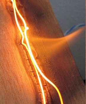

The arrangement used to ligth the fire was
an accident, as resistance wire was touching the wooden base.

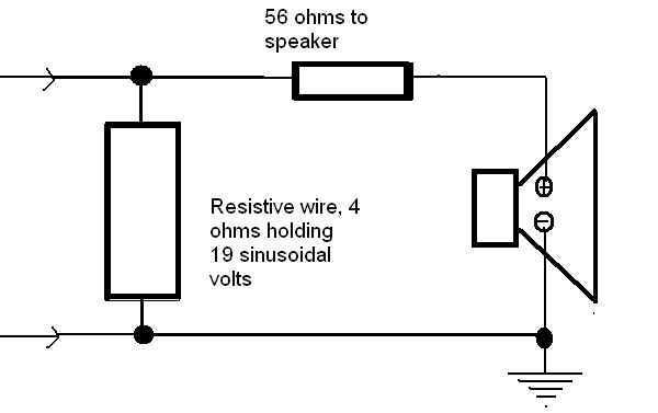

here is the diagram...the resistance wire, that measured 3.2 ohms when cold is the amplifier's real load.... a small sample of this audio is picked using the resistance to allow you monitoring the audio to see when distorting or not...when clipping or not.
attached.

I hate do dissapoint you, but unless your resistive wire is not made for resistors, but is made for heating elements, it's resistance increases with temperature. Also, if you mean 19V RMS then the power into a 3.2 ohm load is 112.8W, not 400... I honestly wish we could lay this Watt thing to rest, you would get 400W approximately into a 1 ohm load... but the amp would not last long.
ilimzn said:your resistive wire .... it's resistance increases with temperature
Carlos, I have such resistive wires at home:
One is a thin, with higher resistance/meter.
And the other is of same material, but with lower resistance and thicker = can take more power.
ilimzn,
A question about light bulbs ... lets say normal for mains, 230VAC or whatever AC
I will try to use such bulb, like Nelson in Zenlite, but for another project.
It is not as simple as using my Ohm-meter,
to determine what resistance will be under working condition.
Say I want to use a suitable bulb at 100mA. And like 20 VoltDC or so
across this bulb.
By reading catalogue before ordering such bulb
I want to know of this bulb will be suitable resistance for my amplifier.
In catalogue, I can find these data:
25 Watt for 220VAC
100 Watt for 220VAC
10 Watt for 40V
5 Watt 24V
Is there any way to try to calculate approximate resistance for such, at for example 200mA???
I am quite sure the behavor is same: Resistance will increase with current.
thanks for any helpful info
lineup
( best way is of course practical tests - like Nelson Pass did
But to avoid to order, buy UNSUITABLE bulbs = waste of my money
it would be nice to get some rule of thumb I could use )
