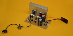

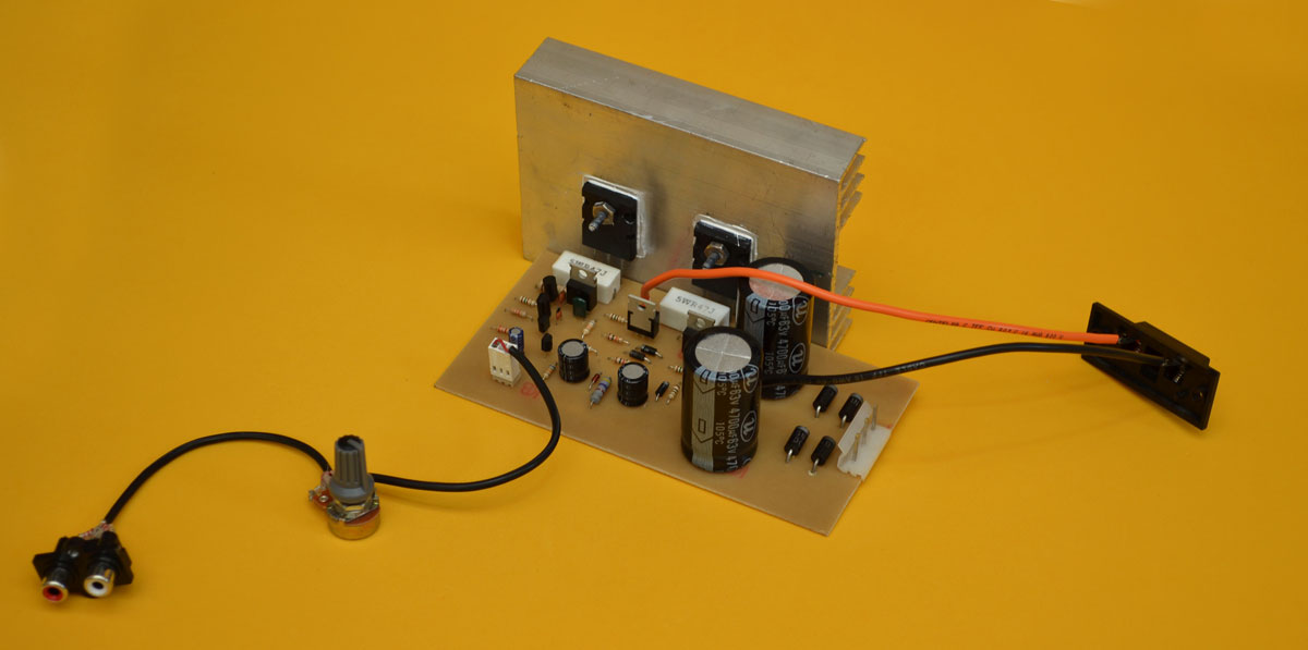

Can I ask about DX amplifier,(I know I am too late for this query) how to make this amp work with +/-50VDC 300VA transformer, I know a more advanced model is available than dx amplifier on diyaudio like dx super A, Blame ST, ES but I want to make this amp and want 100W on 8Ohm load.what changes I have to make in the amp circuit please can someone help.
recently I make this amp, photo and the link is attached below they say its 100W in 8Ohm load.But I don't think so they use a single pair of 2sc5200 on the output can it possible.

I cannot remember my dear...a long time passed and uncle charlie
Is now a days very old.
Maybe someone skilled in design can redesign it to work with 50 volts.
I am distant form this forum by several years...now i am returning very slowly.
All information was posted in this same thread.... to answer you i have to read it entirelly once again...so...makes
more sense you to read directly..this way only one will read it entirelly

I think we need to keep this section only for Dx's designs talkative subject that amplifier from Ampletos is not part of this area I suggest try other forums that talks about that particular amplifier design and they can help you if you speak Spanish try this forum they are many people there with lot of knowledge Foros de Electronica
I have seen Mr. Ampletos designs they are not bad at all just that I don't like the fact that you can not adjust bias that's all, I learn that is best to keep the same subject example if we talk about Dx amp X1 we gonna continue with that subject but if we add other designs that are not part of the main subject information then all will be really confused for the new readers I hope you understand.
