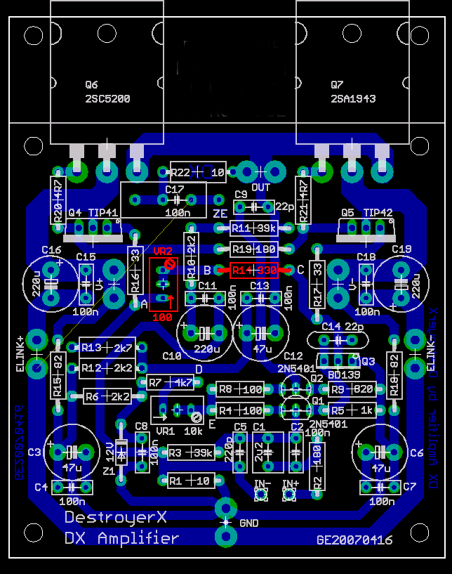

hey guys what about the solder bride is touching the trace, you guys thing it might be the reason the output blow up ?
That is just the star ground point - it is supposed to be connected. Note that a large thick ground jumper from that bridge point up to the ground point near the output transistors where the 100nF C17 to ground goes is needed.

Hallo X and cucicu.
The Resistor is R13 where i have placed a 100R now- you can located it on pic- the one
with longer legs now.
I don't know if it is the right resistance size, but it works.

Hi Bangla,
No need to change the value of R13. the problem may be with VR3 viper. Also check R24 ,Q 8,related track, any short etc. if Vr3 viper open voltage accross A-C will less than 1.8V.Voltage between A and C =( 0.6/Vr3)(Vr3+R24)
So carefully check these 3 components and related tracks. Adjust the viper and measure the resistance across Vr3. If it is not changing replace Vr3 or check the track layout

Hallo Joshvi.
Thank you for advise.
I have checked VR3 again- it shows 886 Ohm now, also the dark Halko 2k is ok.
The measured Voltage between A - C bevor change R13 was ~ 1,3V and after is now
~ 2,4V.
I can adjust via VR3 different bias current now wich is stable ringing around 50-60mV
across bias point.
Also the offset crosses to zero and runs light to - (minus)1-3mv and regulated them self.
I have running the Amp over any hours and all is stable.
With my basic knowledge i really don't know why the Amp is doing it so.
For me it's a bit mysteriously.
The points where i have to solder the thermal BD139 i have checked 3 or more times and write with pen B - C- E point, and now again.
I only could hope any other- mused about this and can analyzing the reason.
Cheers Bangla.

Hi Bangla,
The viper of Vr3 is connected to one of the end point.When you adjust the viper to one end , depends up on the point you connected the viper, resistance becomes zero.So the base and emitter of Q8 is shorted and no current will flow through Q8 (cut off).
Please check R12 also. Are you sure it is 2.2k ? if you put 33k or 22k instead of 2.2k the same will happen.
I didn't see any thing wrong with this schematics. Problem may be with your board.
Best Regards
Joshvi

Change R13 back to 2k7.
Value is not critical but should be close in value to R12. About 2k2 to 2k7 is right.
100r is far too low.
The voltages you have measured & posted look about right.
