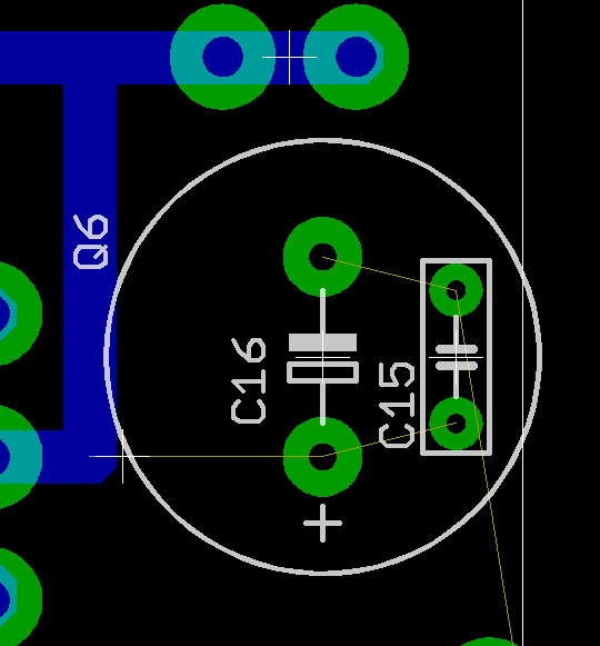

Watch the colour diagram and you will see lines..they are for electrolitic condenser connections into the circuit...optional.
If i follow the plus wire for cap C16 it is wired to the V+ and downwards via C15, +C18 to the groundconnection on the groundtrack in post 39.
Maybe i need new glasses...
Loek
edit: rotate C16 and connect the wire to the tophole and V+ is my idea

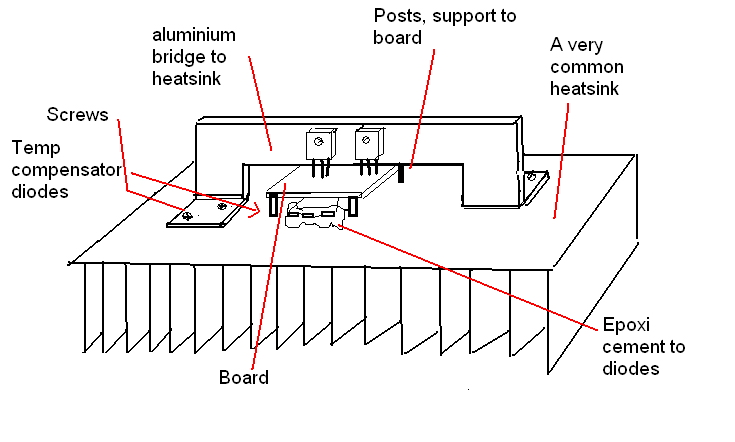

Board size is 95 by 60 milimeters
You can install output transistor over the board, in the standard traditional position....you can try them under the board twisting the leads, you can run wires from the board to the heatsink and also you can produce some kind of "bridge" blade of aluminium that will cross the board in the width direction, having 90 angles down the legs to be attached to heatsink.
Also you can remove those condensers (they do not sound with a good supply and using low speed transistors as VAS and drivers) and use an "L" shape aluminium blade to attach in a heatsink alike Aksa.
Well, depends your imagination.
My supply, i think it is good enougth...having snubbers and big condenser...near to 15000 each rail...it is using coils in series with positive rail..also in the negative rail.... 6800 uf before the coil and another 6800uf after the rail (each rail)...it is discharging after 15 seconds after the shut down of the mains supply...low volume without bass of course.
Attached the most complicated option...let your creativity free boys!
This one has not "That" good heat transference...even using heat compound...the contact area is not so good.

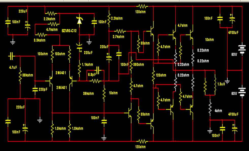

This is current version Dx-Amp schematic
http://www.diyaudio.com/forums/attachment.php?s=&postid=1134970&stamp=1171455661
Is there anything me would change, if I build this amplifier?
No, not much.
It is basically a good amplifier.
I have no doubt it will work good, in this Original Version!
A few details I possibly would try to tweak, to see if they would improve anything.

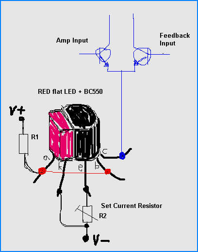

1. Use constant current source instead of ZENER in input.
I avoid as much as I can to use ZENER Diodes in my amplifiers.
There are very good alternatives.
( See my attchment )
2. Use a transistor VBE Multiplier, instead of R14 + VR2.
I like precision and good control of bias.
3. I would like to use BD139 and BD140, to replace TIP41/42.
This is because I know these better.
Good to use components that you are familiar with. Have used before.
4. I would try MJL21193 MJL21194 for output. THEY ARE GOOD!
Most because I can not buy those super 2SC5200 / 2SA1943, at my suppliers.
5. I would use 22-47pF for C14. In my version Q3 would be BD139
6. I would remove C10, 100uF and C11, 100nF
It should be possible, in this amplifier, to TRIM any DC-offset Voltage in output.
Very close to 0.00 Volt.

loek said:
plus C16 is short to ground....
Loek
Hi Loek,
Thanks for having a close look. It just a optical illusion. 😀 I moved C15 a little to the left so you can see what happened. It's hard to make mistakes once the schematic is right.
Carlos is thinking about leaving these caps out as he has found little or no sonic improvement with them. That's why I haven't routed them in yet. I tried to keep the layout close to the original hand made layout.
Wow, thanks Greg, that is saving me a lot of money for not spending money for new glasses. I will invest it in DIY now!

Lineup...VR1 is wrong, correct is 10K...the adjustment will be bigger than 5000 ohms
R9 can be 1K
To easy off adjustment, as the total resistance there will be 413 ohms...the bias trimpot can be 100 ohm, it was 500 ohms in earlier schematics...just details...the amplifier works fine the way it is in the schematic.
Also you can use BD139 in your output simulator...it will works..simulator do not burns transistors when power is too much to them...hehehe
Thank you by the pretty CCS....sketch is good...made by my friends hands.

lineup said:
Is there anything me would change, if I build this amplifier?...
If I was building it, in order to keep as much as possible true to the original design, but also to be able to sleep soundly 🙂 this would be my list of minimum changes:
1) Replace R14 & VR2 with a Vbe multiplier (and bypass it with a small non-inductive cap)
2) Remove R9 (replace with a short)
3) Increase C3, C6 and especially C12 to 220uF.
I would also probably use BD139/140 instead of TIP41/42, like Lineup, I have used them before and I like them for rail voltages up to +-40V. I don't think i would want to change 2SC5200/2SA1943, or, if i did, it would probably be for a similar construction transistor (LAPT). I think that choice is the one enabling easy removal of emitter resistors, as LAPT constructions effectively contain a distributed 'emitter resistor' insde the transistor itself. I don't have much against zener diodes provided they are for voltages between 12 and 33V and temperature drift is not overly important - so I would probably start of without a tail CCS for the input stage. Finally, i would probably use a fixed resistor for VR1 and R7, once I figured out the adjustment.
