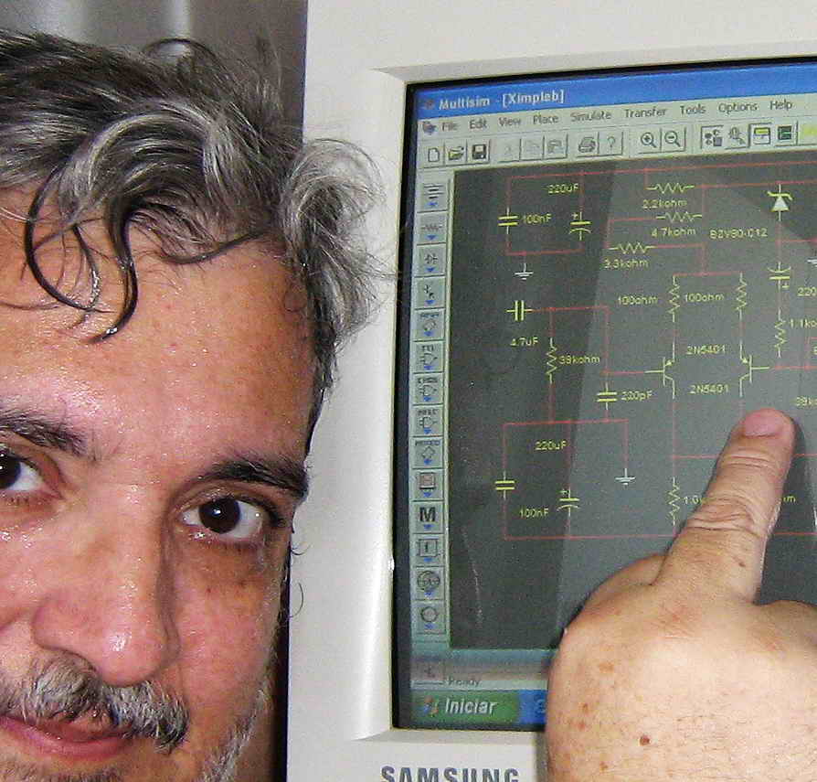

Here you can see how much i apreciate Simulator results...you can see by image details as my smile....or, the more important feedback capacitor.
They cannot sound.... and you go to construct and you always find surprises, as parts are not so precise as the Mathematic formulas the simulator uses....real world is different....for instance, the Jet i will take to Amazon is very fast...near the sound barrier, i will be there soon....but....something happened with instruments...they are delayed 4 hours!.
This is real world timing...the rest is our imagination.

Carlos, you're in need of a shower.(me thinks he's showing +30C sweat with intent)
