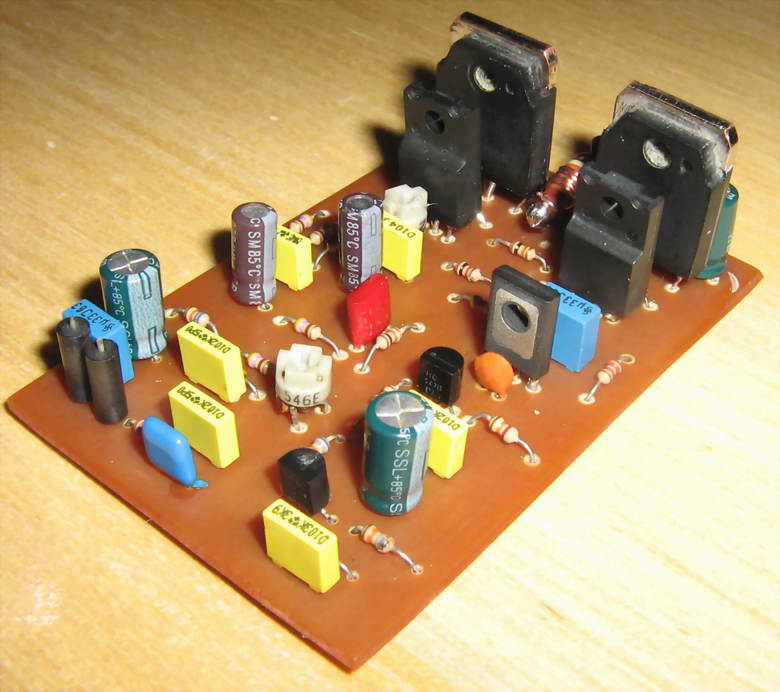

Well, friends ordered as they have listened today....400 bucks entering as profit
Because of 4 circuits i will finish in two days...or less than that...nice!
This is the artistic vision...a real Greg Erskine board was used, the one made to DX amplifier, were i assembled some parts...not the real parts...some resistors, condensers and transistors.
A model....this is the name...a non working model to show how will look the amplifier when ready.
Off course resistance values and condenser values are not correct, as this is not important now..this is to show, and result in orders made by two friends, 2 stereo boards paid in advance.
Friends have listened the prototype and they decide very fast... of course..sounds great!
they will have the work to construct case, find transformers and all stuff...i will give them only working and finished boards, they will have to give me those transistors tomorrow or the day after.
here is non working model image.

Looks neat and simple enough to be hard wired
But in last schematic its not really clear if crossing traces have connection or not

tinitus said:Looks neat and simple enough to be hard wired
Yes, looks very 'neat'
What I like is that there is some space between components.
This makes it easier and hopefully reduce risk for shortcut errors.
Also if you want to add some extra component later
it is wise to leave some room and air in between.
Some boards are so small and components so tight
that mounting becomes a bit tricky
and you can accidentally get a solder-leftovers shortcut.
Good work!
Hi tinitus,
There are a couple of neater schematics on page 1 by Sparkle and myself that will clear up any confusion.
regards

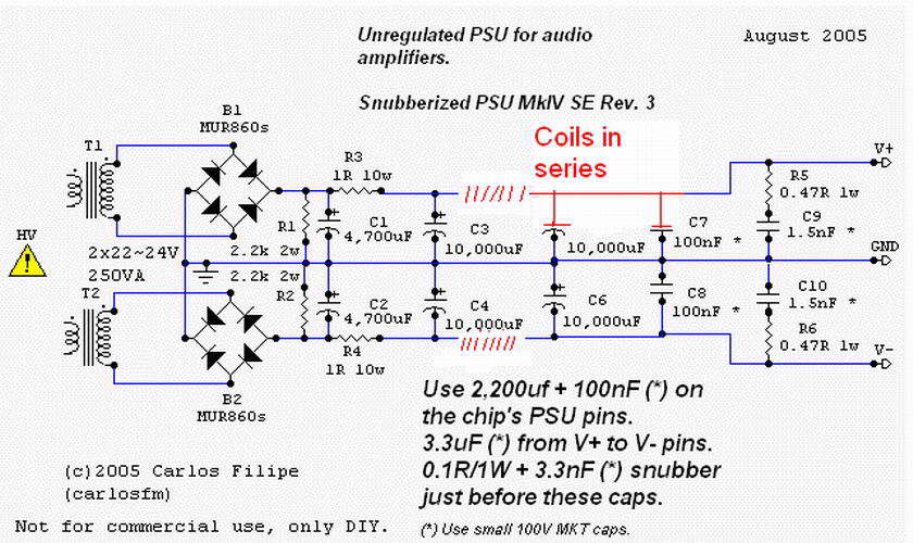

What type of PSU should be used with this amplifier? destroyer x talks about carlosfm's snubberized supply - is that regulated or not? is it the chipamp one without any modifications?
also: what value of psu output voltage is required? carlos said that he uses 39V, but that seems a little too much for my needs..
sorry if these questions seem silly.. and thanks for any answers 🙂
Max
Max

Vurkuuz - The amplifier was tested with 22 volts, 35 volts, 39 volts, and something alike 55...the 75 volts unit was only simulated, also 16 volts was simulated.
The amplifier can work with the voltage you have up from 16 volts simetrical supply....but off course many adjustments will be needed....using it with 16 volts, for instance:
VR!, the off set trimpot, will need a 10K unit, it will be adjusted around 8300 ohms
R10 will need to be replaced by 5K6
The bias trimpot, a 100 ohms unit will be adjusted to mid range
The resistor will need replacement to 820 ohms
Bias will need some adjustment, output current may be 15 to 20 miliamps
Big transistors will not be needed anymore
Input should be replaced by BC557
Voltage amplifier and drivers can be BD139 and BD140
Output can be TIP3055 and TIP2955...or others alike TIP41 and TIP42 and many others..hundreds will fit.
The output power will be smaller than 20 watts over 4 ohms...and near 10 watts over 8 ohms.
High power versions...as i have published the turbo version and the Ignitor was made only to Sparkle, will need diodes (3) in series with the bias trimpot...pointing down the component arrows, they will need to touch the heatsink to control the temperature...but small power versions... under 22 volts may not need, as small heatsinks will fit.
To use it to produce 20 watts over 4 ohms, for instance, with a 16 volts simetrical supply...you will need an aluminium plate of 20 centimeters long to 10 centimeters ...and it can be twisted the way you want to make it smaller...U shape, L shape and others.
When using small voltage, your electrolitic condensers will be small in size...alike the Model i have post...the amplifier will turn more pretty will smaller condensers
You have just to inform me the voltage you have...and if you have some intentions to construct, i will re-calculate, and test real world the voltage you need....re constructing it, customized to you.

This is the Snubber supply he made...he told that sounds good..well...i tried comparing and i perceived more punch...maybe the condensers, those big ones are making that job...i do not know...this is something to test once more.
I am using...because if not good sonically, for sure is not disturbing my amplifier..working fine..i can switch amplifier off and it delays 15 seconds to cut the audio...playing without bass and a very small audio volume of course.
I have included, in my supply, because of Bob Cordell, an inductor...extra series components...as you already have low value resistance that use to present some inductance too.
Mine has 30 turns, 1 milimeter diameter wire over ferrite bar...those ones used to portable AM radios antenna, and FI oscilator.
I do not think...well...at least i have doubts, that a simple supply, with just a rectifier and 2 electrolitic condensers....2200 each one for instance.... will create sonic problem...maybe you will have some small ripple when the supply was hardly used during bass periods....maybe in the scope you will find awfull things...but reall life...hummm..... it will work.

Thank you destroyer X and sparkle 🙂 I can get 2x25V 4A or 2x35V 3.2A transformers for the same $$.. And leaning towards the former, is this correct? I'm also at a loss as to what circuit would be best to use for the power supply. Having had no previous experience with building them it's difficult to form a personal preference 🙁..
once more - but it can't hurt to much - Vurguuz - you can find more informations here at this link - it is very good and related to this power supply that Carlos presented above...
http://www.tnt-audio.com/clinica/ssps1_e.html
i have tried it and it is very good... follow the links at the bottom of this first one to go to the Part 2 and to the Part 3 .... it will help You a lot...🙂
my humble opinion is that the first transformer (2*25V/4A) will be more suitable for You .....
