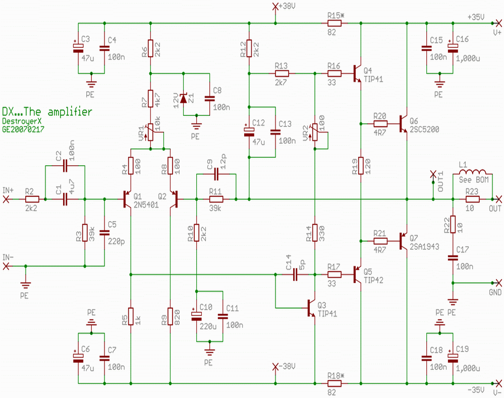

All rigth Sparkle..here the information
Using the bigger supply..this one with 35 volts x 2
Your output power will be 188 Watts Rms over 4 ohms
94 Watts Rms over 8 ohms
R14 will be 220 ohms and bias trimpot in the middle range.
Vr1 will have adjustment around 7700 ohms
R10 will be 1K8
Current will be 34 miliamps ...the output will hold a very small current...something near 10 miliamps (you can adjust)
The other transformer...that one with 25 volts x 2
Your output power will be 98 Watts RMS over 4 ohms
49 watts RMS over 8 ohms
R14 will be 330 ohms..and bias trimpot will be adjusted to 82 ohms
VR1 will have adjustment around 8000 ohms to correct the off set.
R10 will be 2400 ohms (to match 750 milivolts in the input)
output current was adjusted to 100 miliamps. (you can adjust)

in my opinion that transformer that has 2*25V would be much better choice for the amplifier.... nice power, nice size of the transformer....you can use one of them - or even better you can use two of those 2*25V - one for each channel and also separate each power supply for each channel if You can Vurguuz...
if You can't than use one power supply and one transoformer - it would be o.k. too....no problem.....
edit : well one may be sufficient but hard on the edge .... two will be much, much better ..... 🙂 oh, it would look nice - everything separated - 2 transformers, 2 bridges, 2 filterings, 2 channels.....well if he can do that of course....

Mr Greg Erskine produced an updated schematic.
Mr. Greg, a good friend and a very cooperative man, is trying to keep the amplifier schematic updated.
In the reality the circuit show is excelent.
But i have made modifications...small increase in sonics...really very small one...so small that i have to remove and install once again to have sure...in the moment i have only one Dx board working...so i cannot compare instantaneously two Dx circuits.

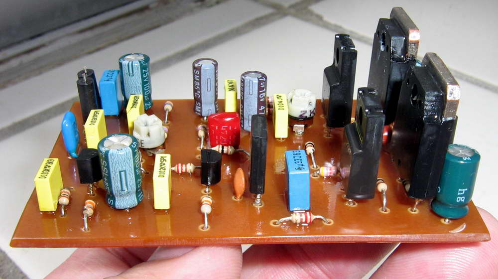

The amplifier is playing full time and i made some small things:
C1 was increase to 10 uf....more power into bass deep end only...increase in quality was small.
I have removed R1.... Graham suggested that...and really the treble had some increase...checked...this worked!
I have increase C3 and C7 to 1000 or bigger...humm... the sound seems to result more dense...but i am not sure.
I have increase C10 to 1000uF.... bass turns better...clearly.
Normally those things happens because of Graham..as he know that if something cannot be clearly perceived in sonics that i will banish the modification and will not even try.

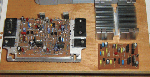

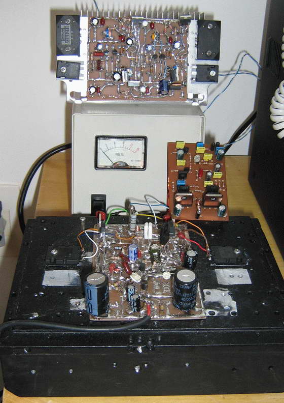

All rigth Vurguuz....needing informs..just call us
Dx amplifier is not a simulated amplifier...not only simulated..but also simulated.
It exists in real life...produces sound..was tested, adjusted and worked fine.... to work fine and to sound great i can give you Guarantee.
here is some images.
regards,
Carlos

good luck and send us some pictures and informs to see how everything turned out.... it would be very nice....🙂
A model was made..also a stereo unit was started.
The stereo circuit was stopped...needing only some wires and adjustment to work.
Was stopped because i realize.....hehe....that it has not the Epupa holes to screws...really they are a need sometimes.
regards,
Carlos

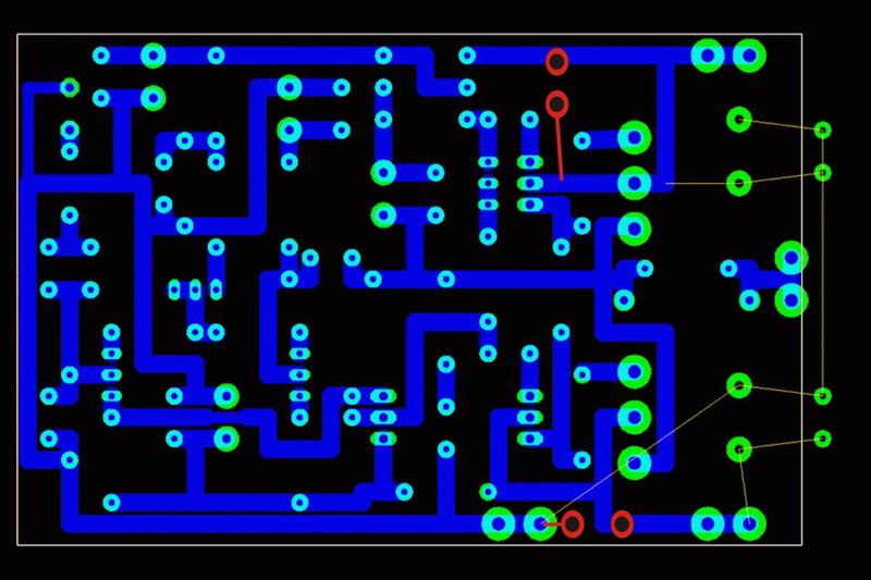

Carlos - there is only one problem i can see here on the board.... only one small detail that i personally do not like - if somebody would like to use C16 and C19 that are really close to the output transistors they will not be able to use them other than to put them under the board because if you use them from above like every other part there will be no way to install output transistors on the heatsink ... it a small problem...
it would be better to install them in front - before output transistor - and this would require a little bit of a change on the pcb in order that you can fit them there and put some pads and trces there.....
i know that Greg will probably run arround screaming because of the additional work he might get....well, it is not my intention to make you turn crazy - only to perfect the design and to leave posibilities here for the people to decide if or if they don't want to have those two caps.....🙂
in post 107 this problem is clear to be seen......(green electrolythic capacitors near the otuput transistors)

In that latest schematic I see some changes.
But not ALL the changes you mention, those GrahamM ones.
Some caps still have the OLD value.
I am sure you will fix this, when you have time.
So no reader here get too much confused.
Thanks, lineup
Thanks, lineup

Well...this last schematic works great!...those last things i told you, about sonic
increase, i told you also that the increase in quality is very small.
so, doing the one you have in the schematic will be all rigth too.
I do not know if Greg will have time to go changing, as i am always doing some small modification.
Was my fault to tell you those modifications....really not so important, and turn confused.
So...keep Greg Erskine, last schematic published as the standard schematic.
I have mentioned that problem related output position before.... when Jacco asked me if was a handle there...the heatsink was alike a baggage handle.
You can remove this condenser to use the amplifier same way as Hugh used in Aksas.... really a beautifull way...i was trying to avoid connections with Aksa, because i think that thopologie is already alike the old 55.
Also the output condensers were not made with copper traces because they are optional...ou can use and connect wires or not, this way you can bent transistors to a L shape aluminium heatsink.
Transistors can be installed under the board, also using some remote location with short length wires..well..there's any obligation to use them over the board...just keep them short, as much as possible.
I cannot, dear Sparkle, ask Greg to customize the board design to each one of our needs...he made the board small, simple and let room to options and creativity.
This is not a food instructions...has not a formula...creativity will be needed to use heatsinks when transistors are in the show position..of course, i hope to see many creative decisions about the transistor placement....i can think in 5 or 6 options...and i will be happy to see other options too...as i want to learn with friends ideas...you Sparkle, for instance, is that kind of genius related those problems..if you took to yourself the responsabilty to find the better solution..for sure you will do it.
I think that Hugh solution is the best one...no other one better..but Hugh amplifier is superior related mine...has better treble and sound stage...The 55 is a professional amplifier, when this one is a diy home made amplifier...Hugh did researche for years long, and he found solutions that i am not using, that certainly increase the sonics as he did.
There are room to research in those amplifiers...i simply cannot go further not to invade copyrigth and not to behave bad with my friend hugh..another good friend i have..this one never failed with me, always kind, trying to help and beeing always cooperative.
My intention is to produce something cheap and simple...that i can use here, in my country, to produce kits to my place only, to produce some to friends and customers locally...and the main important, to have other guys testing it..constructing it...listening it and evaluating it.
If Greg, by himself, decided to make modification..i will feel great with that option...but will be one more board, and people is already confused with this one..try to imagine with one more board!
regards,
Carlos

You can do...all of you, whatever you want..including modifications
But i want you to put your name over...to be responsable related the modifications you have done.
I cannot take care of all possibilities...so...if someone wants..alike i have suggested to Mr. Lineup.... make your own version, publish schematic, simulations and take care of it like a baby, answering questions about it, and not to create confusion...can open another thread.
The name can be, in Lineup case...LineX amplifier...or other...also you can do that Sparkle...i would be happy..at least having dozen amplifiers, around the same thopologie, the chance to have more guys listening and evaluating will be bigger...may result good.
But you can see..if i go changing one condenser value, and it is not in the last schematic, ...people start to think that another amplifier exist...and this is not true...just a variation around the same theme...all amplifiers can be changed in resistor values..you will move operation point,..some currents..and base to emitter junction will take care to maintain a reasonable VBE..you can reduce or enlarge condenser and the amplifier will be almost the same in sonics...it will be the SAME..but a lot of people turn confused and think that is another one..when it is not another one...just small variations....in electronics 20 percent up and down will still work fine.
All i do not want is that the amplifier turn very different...because it will be another amplifier...not beeing the Dx amplifier anymore... in this case..if people want to install Fets and CCS and mirrors and fully differential input...better to give another name and to install another thread for that...to avoid confusion...mess.
This circuit has not copyrigth....it is beeing offered to all of you..it can be yours...make your own version and Charlie will be happy...just do not try to change my violin into a common one...mine is Stradivárious...yeah...not so shinning as others made by industry...not so perfect in shape..but the sound...heheh
