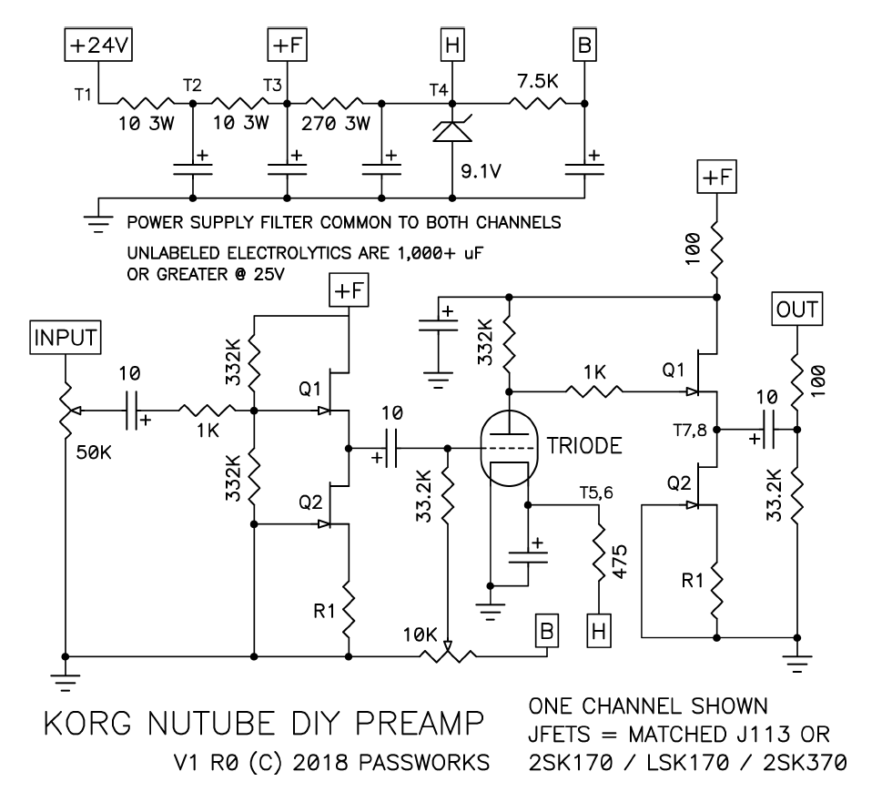

Nutube Balanced Amp
Combining anode CCS (or even better a gyrator) and high input impedance of the following stage I am pretty confident it can be even less THD at 2X output!
Ok, need to be more specific about the design targets: The front end should be low-distortion. 2nd harmonic in opposite phase than that of the output stage would be preferred. [I just expanded the list in the first post accordingly.]
How can a NuTube be biased to swing ±15 V at low distortion?
The lower distortion is obtained with a suitable load. This is nowadays almost normal practice with tubes too, especially when large swings are needed with limited supply. A CCS or a gyrator as plate load + a high input impedance following stage can provide such load. With this "trick" one can get low distortion even from tubes that are normally labelled as poorly linear. I don't see why the NuTube should be an exception.

I doubt that the NU tube can cut it.
In the B1 Korg circuit the tube sees an easy load with the JFets. Still, the distortion figures.....
When i wanted to use the B1 Korg for Mofo i wanted more swing and i raised the question on 4th july 2018 in the Forum

The voltage gain and swing characteristics for the Nutube circuit that I
used were the load-line that I preferred. You can get more or less gain
and more or less distortion by playing with the loading and bias figures,
but it becomes a different animal (one that you might prefer).
If you want to increase the voltage swing I suggest a gain stage after
the Nutube, and while you're at it, you might want to make it inverting,
as that Nutube circuit inverts phase and requires another phase inversion
after it to get the whole thing right. Previously I have just inverted phase
at the speaker when using it.
Again. It's several times we are going back on this. The JFET followers as driver and buffer at next stage are NOT a guarantee of high plate load.
The effective plate load is the parallel combination of the value of the plate resistor and the input impedance of the next stage. If the plate resistor is, say, 200-300K and the JEFT follower at the next stage provides 1M input impedance then the actual plate load is 170-230K, respectively.
In this case, it's not surprising at all that distortion is poor because the effective plate load is smaller than the internal plate resistance of the NuTube which is rated at 330K.
With such a low ratio between load and internal plate resistance ANY triode will perform poorly if large ouput signals are required!! The only application where it works fine is a phono preamplifier....
If the plate resistor is a proper CCS or Gyrator with several megaohms impedance then the 1M of the next stage becomes the dominant load. That makes a lot of difference. If more even better...
With traditional vacuum tubes a ratio of 5 is generally the minimum to get good results with intrinsically linear devices.
A ratio of 2 is typical for the power tubes in the output stage for maximum power output!
P.S. A gyrator is an electronic choke and is better than any actual choke given the crazy values in play, IMHO.

Why do you want to swing 2V peak? That would mean 17V rms out. The VFET cannot deliver 36W output power. It will go into wild clipping before the NuTube hits that limit.....
Instead 1.4V peak at the NuTube grid will result in 12V rms out and 18W power output which is the onset of clipping, looking at the Pass article.
I know the 3V4 is a lot cheaper, that's why I suggested it. I never advice expensive tubes. 🙂
However the 3V4 has other disadvantages....you need a socket with careful mounting to limit microphonics and a dedicated filament supply. At this point I would consider using a proper transformer which would not be too big or heavy. A good Antek toroidal or R-core of suitable rating will be good.
To cover the dropout of the CCS / gyrator plus the pk-pk voltage swing, seems that 36V rail would need a boost. Using a dedicated B+ supply would open up a world of possibilities.
If you wanted to try to use the 36V rail and give the NuTube a better load, perhaps this actual choke from Lundahl? A grid choke, LL1670, rated at 540H at 0.8mA 4.8K DCR. $62 USD each though, so not cheap.
