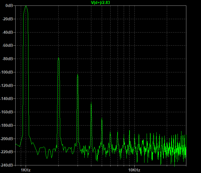

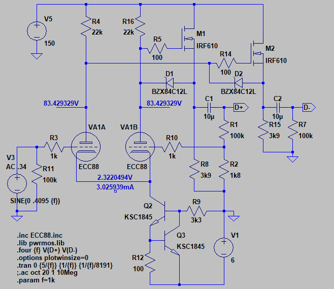

How about an ECC88 cathode coupled amplifier?
Predicted THD <0.013% and H2/H3 > 20dB.

Fourier components of V(d+)
DC component:-3.88492e-006
Harmonic Frequency Fourier Normalized Phase Normalized
Number [Hz] Component Component [degree] Phase [deg]
1 1.000e+03 4.000e+00 1.000e+00 -0.05° 0.00°
2 2.000e+03 5.136e-04 1.284e-04 -89.90° -89.85°
3 3.000e+03 2.831e-05 7.078e-06 1.71° 1.76°
4 4.000e+03 2.099e-07 5.247e-08 89.73° 89.79°
5 5.000e+03 1.602e-08 4.006e-09 -174.48° -174.43°
6 6.000e+03 1.627e-09 4.068e-10 -8.50° -8.45°
7 7.000e+03 7.060e-10 1.765e-10 -162.82° -162.76°
8 8.000e+03 1.035e-09 2.588e-10 144.67° 144.73°
9 9.000e+03 2.095e-09 5.237e-10 113.19° 113.24°
Total Harmonic Distortion: 0.012861%(0.012860%)

Hmm, input signal is -9.4 dBv with respect to GND (Figure 1), and D+ output signal is +10.2 dBv with respect to GND (Figure 2).
So gain is (10.2 - (-9.4)) = 19.6 dB to the D+ pin: 9.55 volts per volt . Presumably gain to the D- pin is equal and opposite: -9.55 volts per volt. Total gain is thus 19.1 volts per volt.
That doesn't seem compatible with a max input signal level of 3V RMS.
