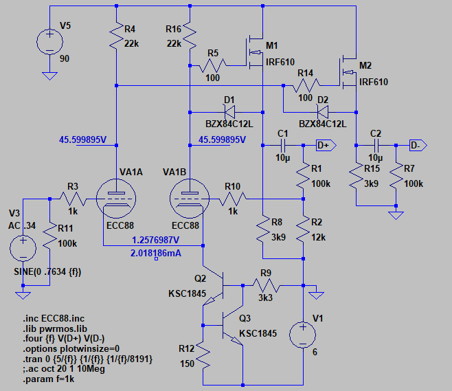

This input stage design does a better job of supporting preamps with a lower max output signal. Which is exactly why I like it.
It's an idea, I posted something I already have in my sim archive. R2 can be increased to reduce gain. 🙂
I'll pitch in my help if the design is to meet a certain target, as is the circuit can drive bridged AB100 output stage 400W into 8 ohm with ~8Vpp input.
Bulwark, Marauder, and Dreadnought also support preamps with a lower max output signal. By changing their NFB resistor ratio, you can increase their gain to whatever value you like.
Let's stick to the design targets in the first post for now. I set the gain target such that it will be similar to the standard VFET front end, and work well with most line-level sources out there.
The ECC88/6DJ8 is a nice tube. It's linear, has the balls to drive pretty much everything, and it's not difficult to find. However, it would needs a plate voltage of maybe 130 VDC to work well here (Vg = -2.5 V, Ia = 8 mA). Would this voltage be okay for rookies?

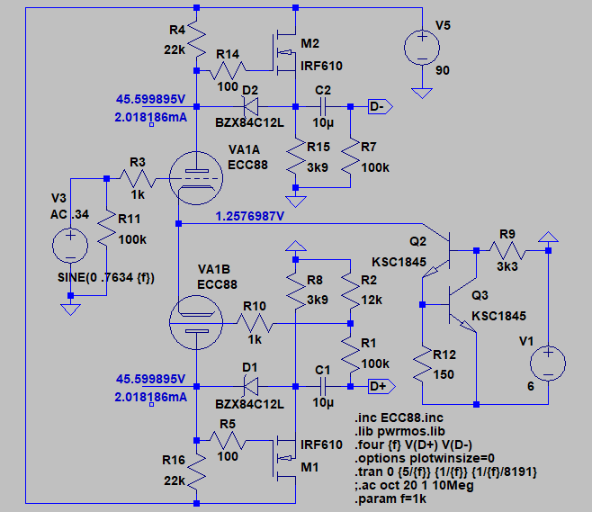

In this schematic, ECC88 will work just fine in A1 with B+ = 90V, Vak 45V, Vg = -1.25V and Ia = 2 mA. Please note revised R2 = 12k and R12 = 150r. Output voltage Vd = 10.48V rms at Input = 2V rms.

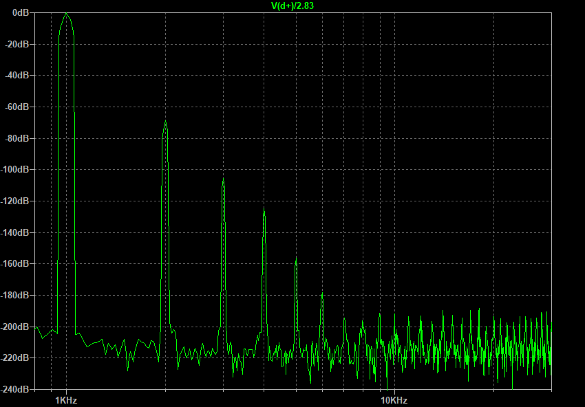

Ltspice asc and associated include file was zipped and attached to post #118. I did not enter the lottery hence can not properly test prototypes.
Code:
N-Period=1
Fourier components of V(d+)
DC component:0.00120064
Harmonic Frequency Fourier Normalized Phase Normalized
Number [Hz] Component Component [degree] Phase [deg]
1 1.000e+03 4.000e+00 1.000e+00 -0.05° 0.00°
2 2.000e+03 1.464e-03 3.661e-04 -90.02° -89.96°
3 3.000e+03 2.098e-05 5.246e-06 176.08° 176.14°
4 4.000e+03 2.244e-06 5.610e-07 88.71° 88.77°
5 5.000e+03 8.986e-08 2.246e-08 -1.87° -1.81°
6 6.000e+03 2.421e-08 6.053e-09 -7.83° -7.78°
7 7.000e+03 2.259e-08 5.647e-09 -1.56° -1.51°
8 8.000e+03 1.945e-08 4.863e-09 -0.00° 0.05°
9 9.000e+03 1.634e-08 4.085e-09 -0.48° -0.43°
Total Harmonic Distortion: 0.036614%(0.036614%)

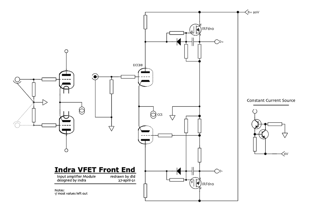

I had trouble wrapping my head around your drawing so redrew it in a more conceptual manner. Could you check for errors please?
Why don’t you take full advatage of te CCS and derive the bottom tube input as shown in the snippet i’ve dropped on on the left?
dave
Hi Dave,Why don’t you take full advatage of te CCS and derive the bottom tube input as shown in the snippet i’ve dropped on on the left?
I redraw the Rev1 schematic for you and hollow state folks, hopefully it becomes a bit more legible. 🙂
The circuit use R1 and R2 as feedback divider to adjust gain as desired. Short R2 if no feedback is desired to become as the snippet you made.
I think a source follower will perform better considering 90V B+, cathode follower should be doable with a 150V B+.
I actually prefer the first set of schematics. They are quite readable and show the common cathode connection effectively.

In this schematic, ECC88 will work just fine in A1 with B+ = 90V, Vak 45V, Vg = -1.25V and Ia = 2 mA..
The design target asks for +/- 2 Vpk input voltage, so the grid needs to be biased lower than -2 V. As it is, your suggested bias point wouldn't work out. However, since the gain (33x) of the ECC88 is quite a bit higher than the target (about 7.5x), we might get away with adding some degeneration via the cathode resistor (i.e., without a bypassing capacitor), thereby reducing the headroom needed for the DC grid bias. I'd need to look into this a bit more.
I had trouble wrapping my head around your drawing so...
As far as I can tell, indras suggestion is just a long-tailed pair (LTP) with a CCS in the tail. I like LTPs as phase splitters, but I don't quite see the point here. We just need a single ended output from the front end to drive the VFET output stage.
It is preferable to have a circuit that drives both the D+ and D- outputs. This allows one to experience the effects of phase reversal in the front end vs output stage, if one is so inclined. Or even to drive a suitable chunk of iron 😉
