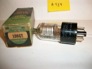

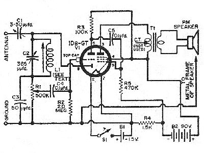

1D8-GT is $6, impressive for the price, not very popular, gives two sections for lots of open-loop gain and possible NFB (though this may be difficult with the pinout limits). The filament power is so low you get 100 hours (3 hours/night for a month) on one D-cell, maybe avoiding a 3rd power supply. Here is a snip from a radio, output converted to R-loaded. The coupling caps are barely big enough for 30Hz, you could go 4X bigger easily. The volume pot can be 100k for extended treble. The other resistors are good as they are, pending an actual build. 2nd image has alternate values to try. 3rd image shows a squat Octal with a kewl top-cap. (That's no-voltage Grid, not a shocking electrode.)
