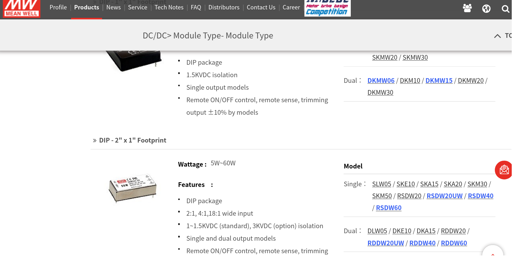

If the filament supply must be floating, would a simple isolated DC-DC converter be good enough? How about one that converts the 36 VDC rails to +/- 15 VDC (floating), which then feeds the 2.8 V filament via suitable dropping resistors?

If your DC to DC converter uses inexpensive parts and a streamlined minimalist design, you might be able to beat Marauder on BOM cost. That would be amazing! You could click on the "one click" Mouser shopping cart to get today's total price per Marauder, just scroll to the bottom.
