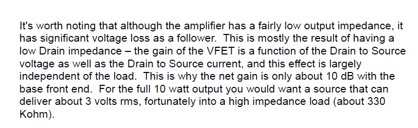

A couple of math observations that arise when reading this paragraph in Nelson Pass's design document .pdf ... If you prefer to view it in the original document, Search within Acrobat will locate it instantly.
  • "10dB gain" == 3.2X gain
  • "3 volts RMS" input signal = ±4.24 volts = 8.5 volts peak-to-trough
  • "3 volts RMS" input signal, times a gain of 5X in the front end card, gives 15V RMS output from the front end. That's ±21.2 volts = 42.4 volts peak-to-trough. Don't worry, the Edcor transformer can easily create an output signal that swings beyond the 36V power supply rail. A transformerless front end will have to employ other contrivances.
  • 3V RMS input, times an end-to-end gain of 3.2X for the VFET amp as a whole, gives a 9.6V RMS output at the loudspeaker

Then, with 330K easy load, the 3S4 in triode mode without any cathode follower can do the job. It doesn't come any simpler than this. 3.2x or 5x not really a big deal. With 5x it would need 0.6Vrms at the input which is still a power amp in my book...that can be used as integrated amp with high output sources.
The 330k value assumes the capacitance of the SIT/VFET gate is negligible. Is it? I'll try to do a measurement using the SITs I have at hand.
This normally happens with tubes too. Normally power triodes have Miller capacitance in the 30-100 pF range. If the load stays 10X or better than the tube plate resistance (about 3K for the 3S4 in triode mode), distortion increase respect to higher values of load resistor will be modest. If happening above 20KHz it will be ok, especially because of the modest swing required.
It's a good idea if you check. You could save some money, time and space.
If the reference max power is 8W as pointed out earlier, then with 5x it will need 0.32V rms which is a proper integrated amplifier.

A couple of math observations that arise when reading this paragraph in Nelson Pass's design document...
I read this article at least five times. It seems this was not enough. I missed the part that says that the follower output stage as voltage gain substantially lower than 1. This means the input/driver stage would benefit from a bit more gain than what I thought initially.

Since this thread is appearing in the Tubes / Valves forum and not the Pass Labs forum, some extra background information is probably necessary. Here is a copy of the DIY Sony VFET part1 document that Nelson Pass provided with his introduction of the amp.
Note that the input resistance of the output stage is over 100k Ohms, and the gain of this stage is less than unity. That suggests that a good target for the gain of the vacuum tube input stage would be from 17db to 20db, depending on the output capability of the preamp one is using to drive this amplifier.

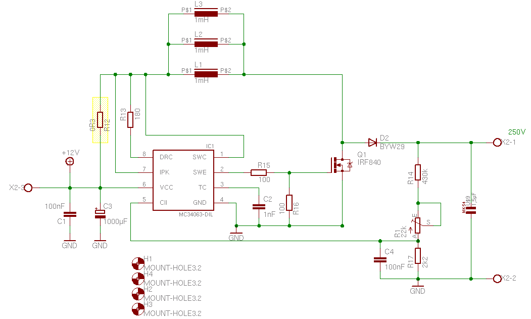

Could you show a circuit or example?
Get both ST datasheet mc34063ab.pdf and On Semi mc34063a-d.pdf.
Set frequency using Ct and max switching current using Rsc. Output voltage is determined by 1.25V*R2/R1. But you need an external switching device such as an IRF610 to allow output voltage > 40V as shown in the last example on ST datasheet. Attached is a schematic I saw from Probleme mit MC34063 step up - Mikrocontroller.net as an example but you need to determine appropriate values for Ct, Rsc, L1, feedback resistors R1 and R2 for your specific need.
Would it be possible to design a smallish board containing both the DC converter and the audio circuit?
Sure.
