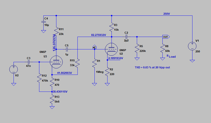

Another way to get it done is in the picture: common cathode + bootstrapped cathode follower. Gain of 4 and THD at 0.03% for 10 Vrms output driving 50K even with a modest ECC82/12AU7. But there is some feedback (which is not the evil if properly used, IMHO).
More details at this page (section 8): Preamps
