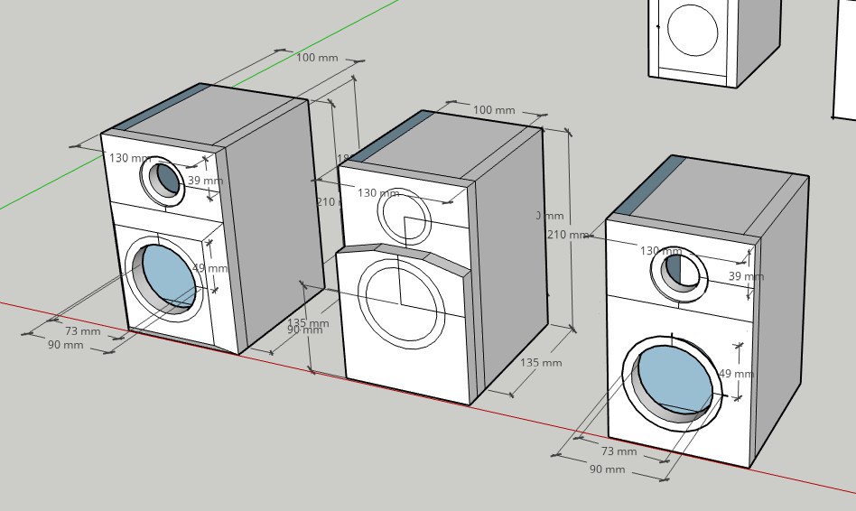

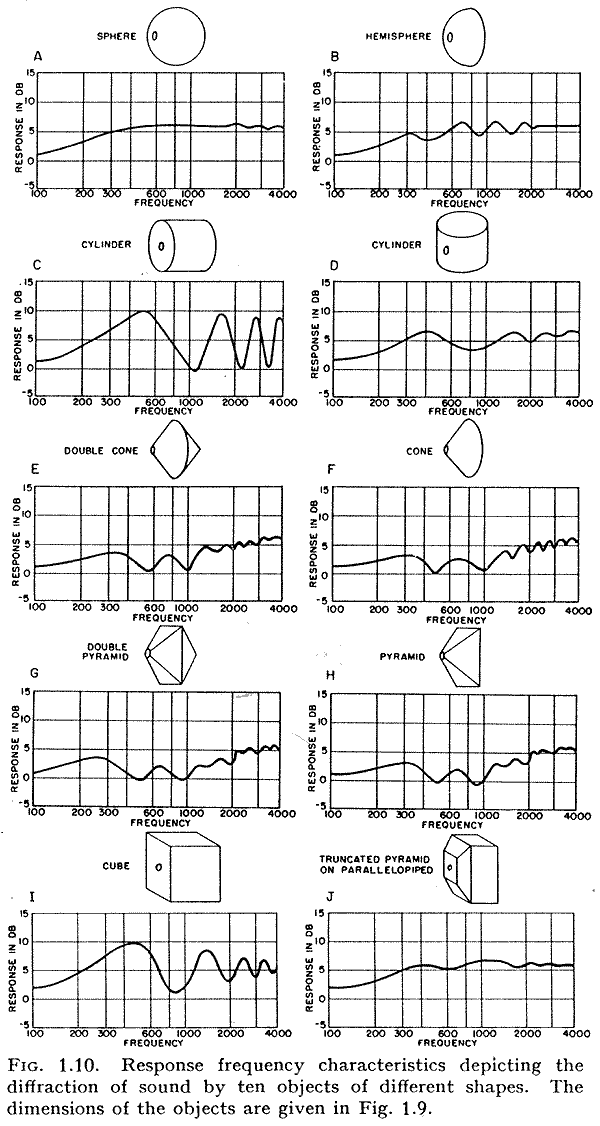

Fellas, these are the drawings of three possible designs. I'm pretty much sticking with the main chamber proportion (already built) but I can play around with the baffle design. Here's what I think about them, from left to right:
1. Double baffle on the midwoofer, supposedly aid with rigidity? The wider circle is how big I will cut out the "main baffle" behind the additional baffle. The chamfer around the edges will supposedly reduce baffle diffraction effects (as shown in exhibit J in the attachment)
2. Again, double baffle on the midwoofer for the rigidity. I'm a bit ashamed to admit I don't know how the baffle shape will affect the tweeter's response. It looks really stout and cool to my eyes 😎😎 Inspired by Troels Gravesen's Discovery-12W
3. Just one layer of baffle, the advantage is simpler construction, and I can put the tweeter closer to the midwoofer to aid better integration of the two drivers.
Across the board, I am planning to measure and then design crossover using XSim accounting for the acoustic center of the drivers.
Any suggestion you guys want to share? As always, I greatly appreciate your kind support. 🙂🙂

I think if going with a stepped baffle then number 1 as well. You will likely get some pretty big anomalies in the tweeters response with option 2. I would think you would get them with option 1 as well but less severe (everything is a compromise when building a speaker 😉 ).
Yes to bevel all round as well, but I'd not do it at the bottom. I found out that the hard way 😉 If the speaker is sitting on a surface it will likely cause some nasty diffraction, if it was on a stand (that does not form a V with the bottom of the box) it is probably ok to bevel the bottom.
Tony.

I vote for case #3 because it has fewer steps/edges. Every edge can cause diffraction and effect the speakers off axis response. I would also put generous round overs on the edges and top. The small gain in time alignment from the tweeter step is not worth it IMO.
The Olson graphs need some context. Olson used a small special driver in a relatively large baffle to demonstrate the effect. Linkwitz and Dickason also published some graphs with similar (but not as extreme) effects. I second the many suggestions to simulate it one of the many s/w packages mentioned.
Hey - little did I know, there’s an opening to sneak out and move forward with the project. 😀😀
Thank you guys for suggesting to go with flat baffle, I took your advice to heart! 😉

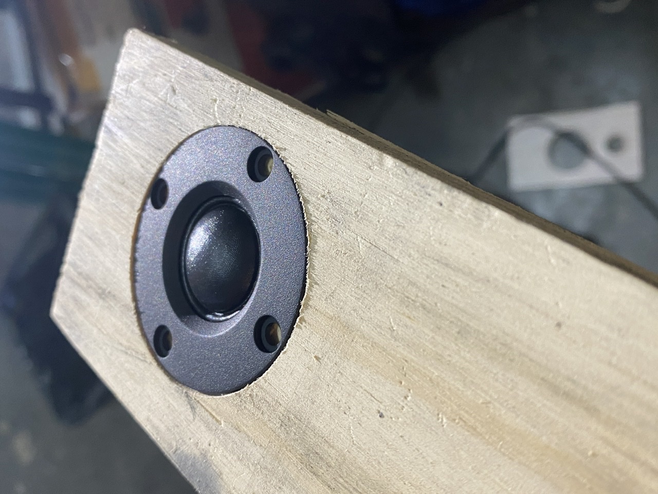

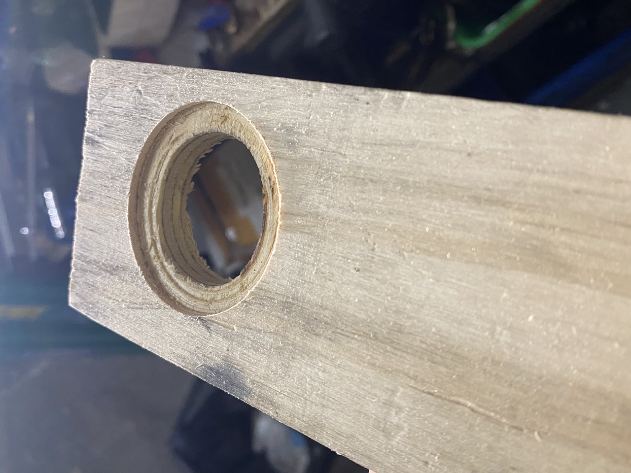

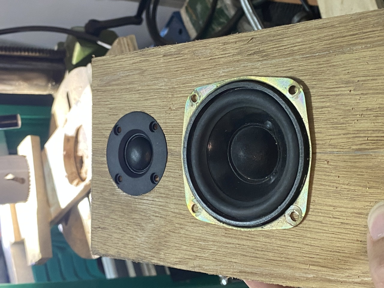

Since I have no access to a router, for this nominally 52mm tweeter, I first made a 3mm ‘score’ with 51mm hole saw, then another 3mm ‘score’ with 44mm hole saw, then drill all the way through with 38mm hole saw. Cleaned up the countersink with a cutter knife. The tweeter sits flush with a tight, press-fit. First time I did this 😱😱 I will line the back of the tweeter with some foam to make airtight and flat fitment.
The woofer center is positioned 4/7th of the baffle height. I made sure it’s not in the middle of the cabinet.
Lessons learned: I’m glad I took the time to with the practice jig, and took the time to secure the piece on the drill press when drilling the woofer hole.

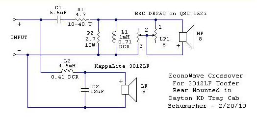

I am not sure if this qualifies as "designing my own speaker from scratch", but I am trying to take take two different Econowave designs and merge them together.
I am trying to incorporate these speaker designs / crossover designs:
EconoWave SR Compact --> Summary
EconoWave Deluxe --> Summary
Deluxe uses same compression driver, but different waveguide. Compact SR uses same waveguide, but different compression driver. Deluxe and Compact SR use different woofer, but the Deluxe appears to be closer aligned with the Eminence Beta 12a.
From looking at the FRD on both the DE250 and the Beta 12a, it seems the logical crossover point should be around 1000-1250Hz. The Deluxe crossover seems to crossover at a similar place.

Crossover design
I have no idea how to design a crossover, but did some reading on the Introduction to designing crossovers without measurement and from what I have read, the main purpose of the crossover it to cater for the tweeter, or in this case, the Compression Driver. Given the crossover on the Deluxe has been designed for the B&C DE250, I am off to the races (ignoring any effects the waveguide has and taking a "no measurement approach").
The woofer side of things also seems to be similar with both the Kappalite 3012LF and Beta 12a having a hump around 2k, same nominal impedance (8), Re (5 vs. 5.6), Le (0.98 vs. 0.64mH), Sens (95.5 vs 98).
Resistor
I have calculated based on the tutorial a resistor impedance difference of 6.25 (Beta 12a) and 7 (3012LF).
Capacitor
I have calculated based on the tutorial a capacitor difference of 16.38uF (Beta 12a) and 20uF for the (3012LF).
attachment.php
Conclusions
What I can't figure out is why they are using a 12uF cap and 4.5mH resistor and if they are so far off what I was expecting, is my math wrong, and/or are the differences negligible and I can build the crossover as they have spec'd it.
