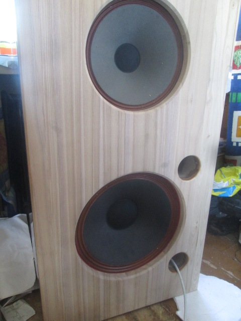

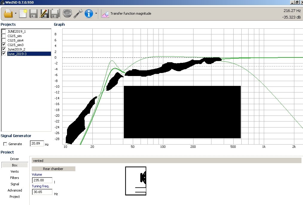

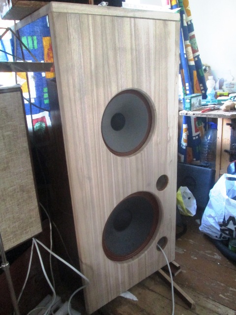

I made my own "monster" speaker a year ago.
The thing is 250L and the size of a large 1950s fridge.
It weighs a lot, so much it takes 2 to move it.
I used a lot of theory and some hunches + an excellent local wood workshop who could calculate sizes on the fly in his head to cater for wall thicknesses and who knows what.
The basic material was an old soviet veneered cupboard being thrown out, which got cut up within an hour to precise sizes and pieces.
I figured as I wanted a +10dB jump in performance over anything ever seen before between 27-60hz, it would have 2 ports of different lengths, with a 12" & 15" driver with massive magnets.
I figured to get the required stiffness would entail making a FRONT MASK, then have a solid 1" thick birch front bolted down over the top of it.
That appeared to tame the various shakes and vibrations when fed with 60W at 27-33hz for testing.
(race car suspension & chassis theory seems to have helped quite a bit here, but I can't get honeycomb style C-F material cheap and it would be too light with weird undamped resonances!)
Some fairly long fasteners had to go through the front mask in order to hold it rock solid, so basically what you get is an absolutely rigid sandwhich front about 2"+ thick made of 2 enormously thick plies.
I don't think I have ever seen a front panel that thick and that rigid ever, so I guessed if you are gonna do it, it's best to be completely over the top anyway!
The holes were cut by the same wood workshop with nice chamfers on (they had to buy the tool specially).
The ports came from an industrial printer plotter cardboard roll, which I took home on the local tram before cutting it to the right lengths. (from calcs).
They were then inserted into chamfered holes and glued i n with thick silicon sealant until it went hard.
I couldn't be bothered to put terminal board outside, so the wires went straight in one of the ports....quite thick 20amp sort of stuff...
It has exceeded all my expectations quite wildly.
If you can imagine a 10dB SPL hike in power would entail the equivalent of going from about 20W to 500W+, it's been a revelation.
Organ music is reproduced totally effortlessly to the point it makes the concrete walls and wooden floor vibrate, but with very low distortion.
I have never heard anything quite as realistic as this - which is why it was designed as a studio monitor system.
People do come from miles around to check out their recordings on it.
It has made expensive things like Tannoy WM look totally weak kneed rubbish.
I have yet to find anything quite like it in my tours of "hi end shops"...
(for which I have calibrated figures from studio microphones).

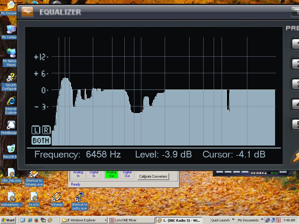

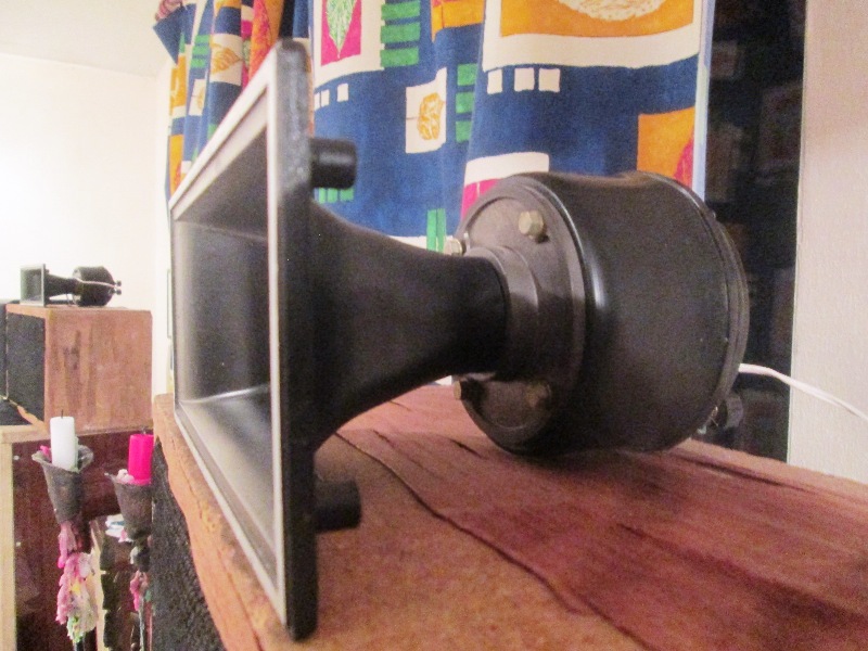

There are seperate mid ranges in other cabinets but the other secret element was finding a LOMO horn driver of the various last developments ever made. (resembles very much a 288B).
This gave another 10dB boost above the 1st order 2.5khz crossover which seemed to work best.
I used a simple DSP correction to tame a sharp 6khz resonance on the horn tweeter.
Those are truly impressive, even showing up significant noise in the studio sound card.
You can see the various corrections I made to the responses on the enclosed images.
They were something like I expected although the simulation sw, clearly has limitations and can't cope with 2 drivers in the same BR design.
The whole thing is powered by a pair of large (100W) US made valve amps, with the multi taps and windings serving to bi/tri wire the whole array to the point that (a la Brosky), the crossover is included into the output transformer windings,so that can't interfere with each other in any way.
A number of people have asked me how much to make some more... 🙄, but I am not so sure I want to start that whole lot again. It would have to be a tad more manageable in size.
Dunno what you think, but I enjoyed the whole experience.
You can always be proud of doing something yourself..especially if it's much better than any commercial product.
The neighbours hate it, but hey, that's another story!

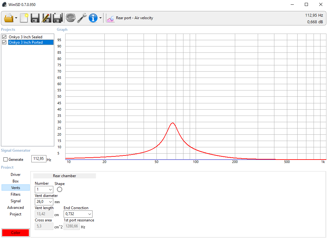

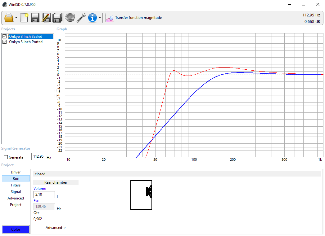

Dear Tony and gentlemen here,
I've been thinking and decided to take a look again at my WinISD sim. I had decided to go with sealed box because (1) During my earlier sims, the port air velocity is too high, I fear chuffing might occur, and (2) I read somewhere in this forum, for boxes under 4 liters, a ported box will have compromises, especially around the midrange.
But now that I've found this thread, I'm decided to take a fresh look ("from scratch" 😱), and simulating from the start, the driver really wants to be in a ported box with EBP=129.7 😉
I found a combination that might work, and these are the conditions:
- The port air velocity below is simulated with 10W input signal, which I think is the loudest real-life listening I will enjoy with this driver.
- The speaker is being XO'd actively above 110-140Hz so in real life those high velocity around 60Hz might not be audible much, if at all?
- The port will be on the rear side.
- Both enclosures are simulated to have lining on the inside (Qa=50)
On sim, the ported box offers much advantage especially in the lower region. But, I'm curious if it's true that for this small of a box, midrange will suffer on ported designs?
Any input on my "design" will be much appreciated.
Thanks AllenB. Sorry I might not have presented that accurately, but this is the post I had in mind, from the thread What's the best 5 inch driver for a small sealed box same as the LS3/5A. SPH-135TC ?

Here is a small BR speaker I made SB acoustics SB12MNRX25-4 "full range" Build thread These actually sound surprisingly good. I didn't have any concerns about the midrange. They are a little harsh up top, but the drivers were never meant to be used this way. If you don't care about the low bass output because you are going to crossover to a sub anyway, I would definitely change the tuning to something a bit more flat than your winisd plots show. The transient respsonse should be a lot better too.
