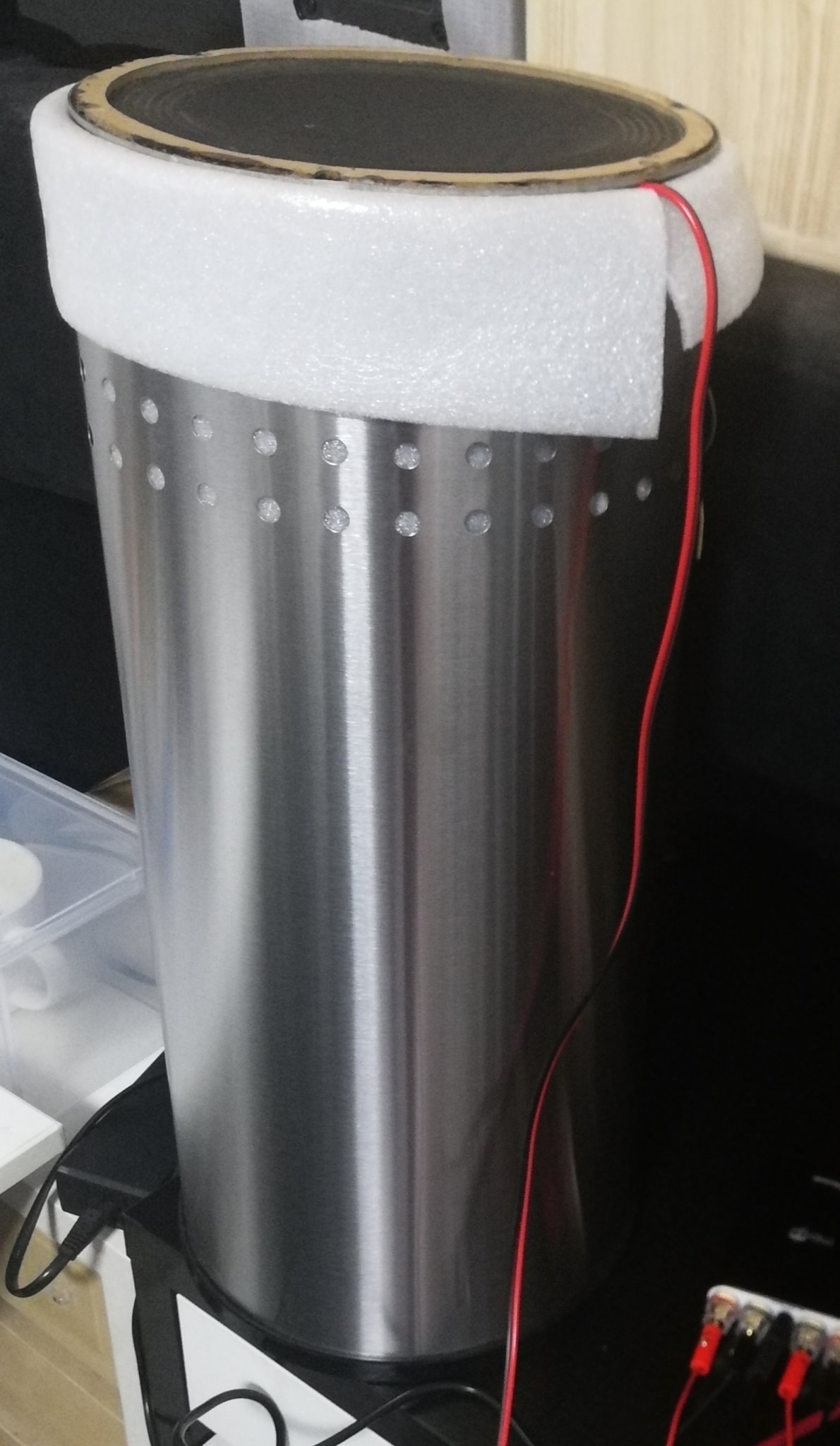

I don't design my speakers. I design the experimentation that would yield the results I wanted, empirically and efficiently. Yesterday morning I took delivery of two different 8" vintage fullrange drivers (old German, were they a pair would more than double the cost). After a quick listen (tone-sweep and reference music) I planned out what to try over a two-hour window in the evening. The 1930s Telefunken sounded fine and flat-responsed except it had resonance around 90hz; it was placed over a steel umbrella stand (21cm diameter tube 50cm high ~17L overstuffed and slightly leaky). The (later) Siemens had a very big hump 2-4.1khz and associated distortion. Without measuring impedance curve, I simply tried two each L C R in combination and notched out the hump while balancing the two drivers; it went on a 14L aperiodic box stuffed with a woolen jacket. That left only ~110hz ('funken) vs ~320hz ('mens) tone-sweep minor humps to be dealt with later. Crystal clear neutral "German" sound, 75-10500hz very well covered, the Funkmens!
(Actual cabs will take another round of experimentation, aperiodic vs TLonken etc.)

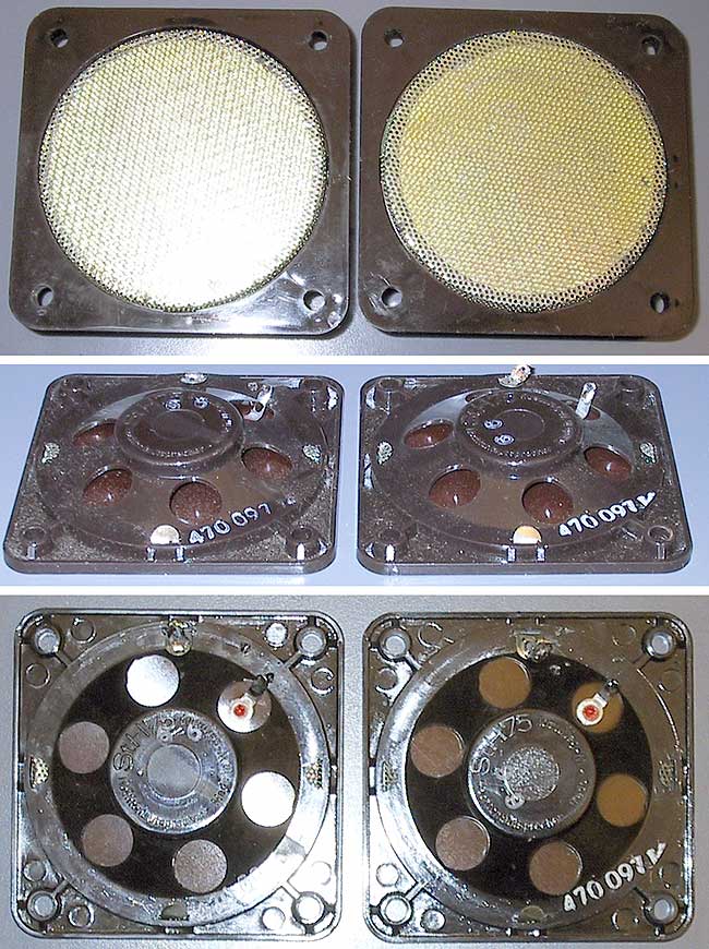

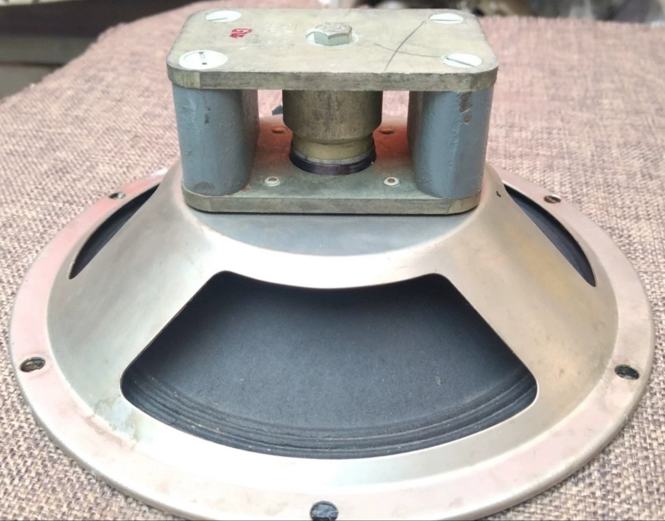

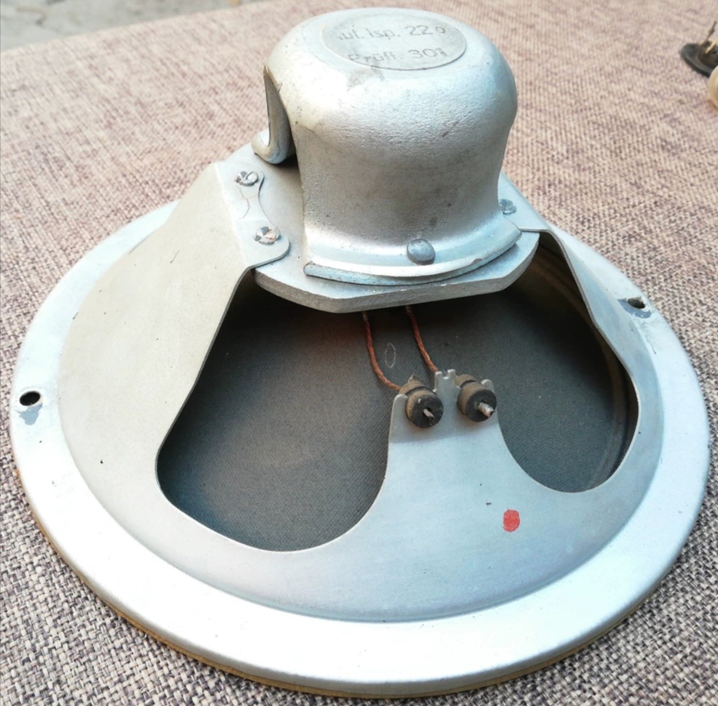

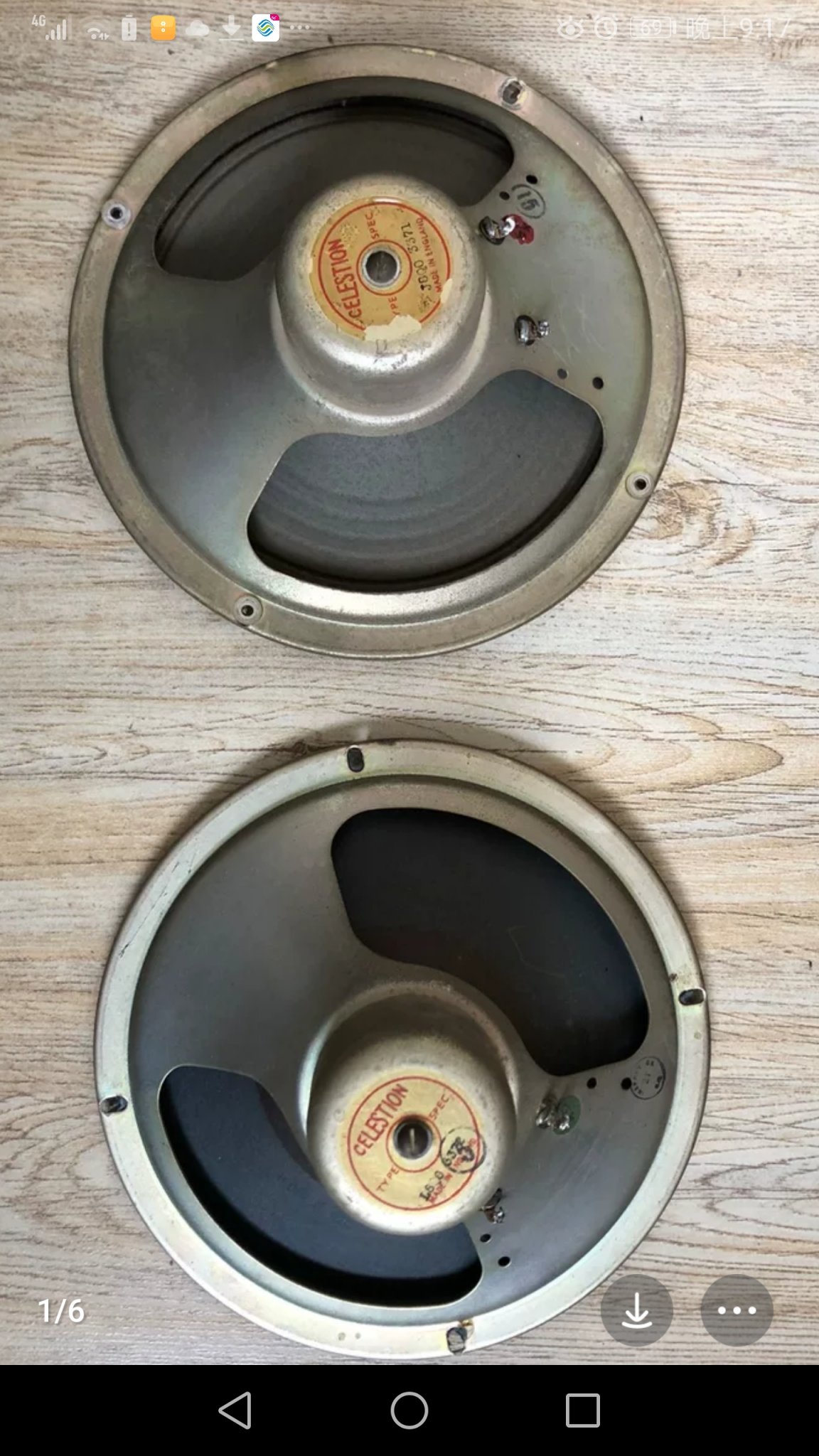

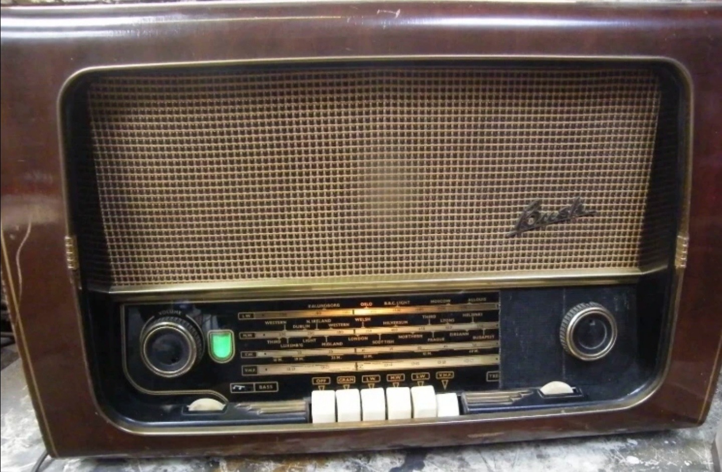

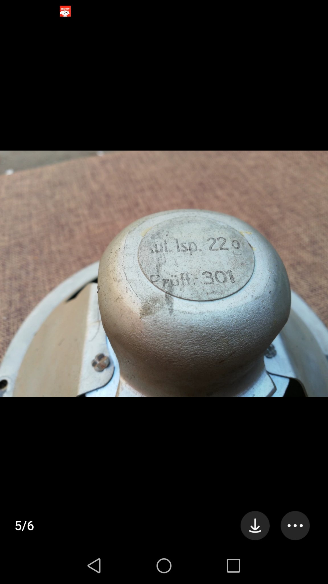

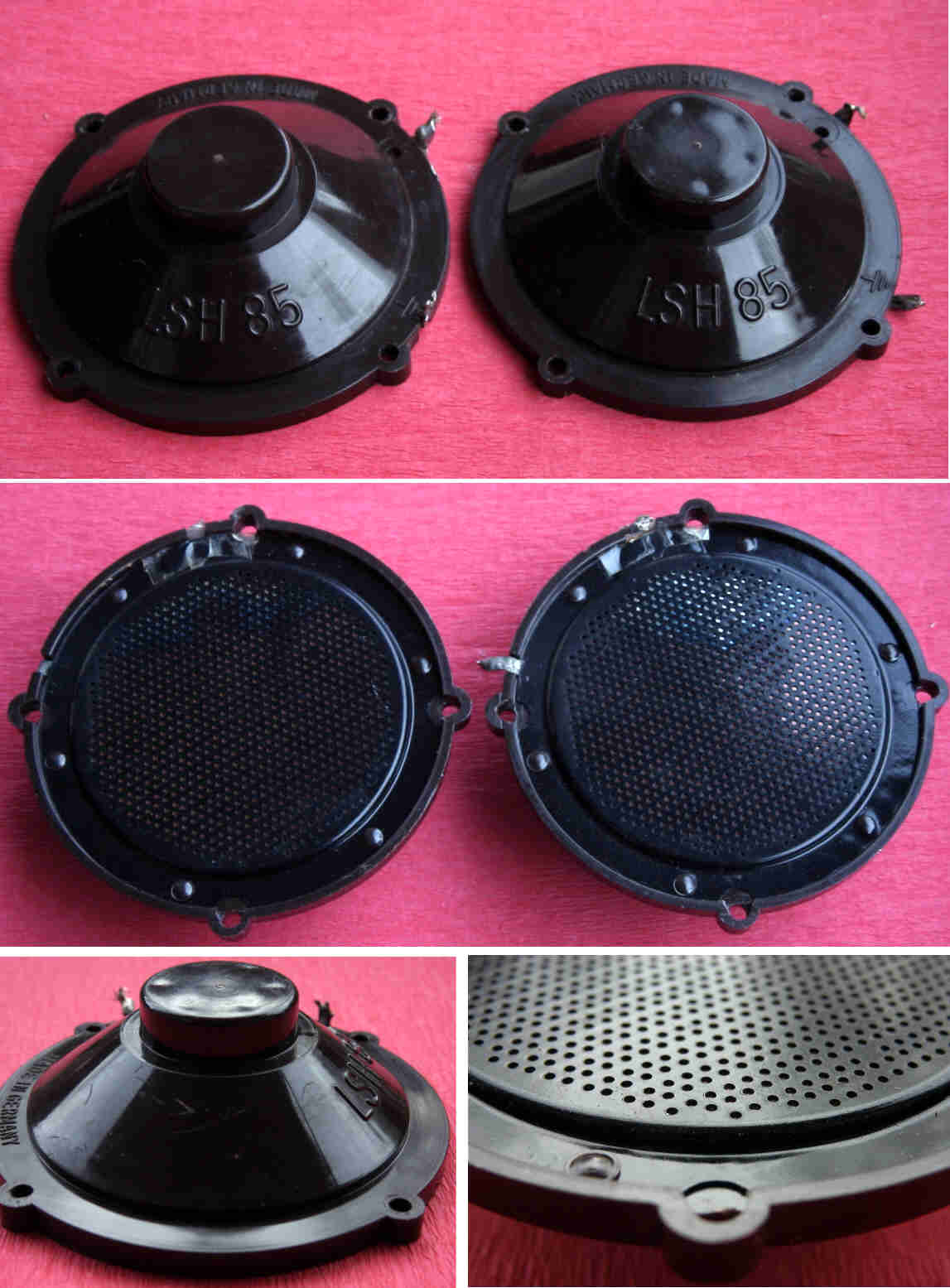

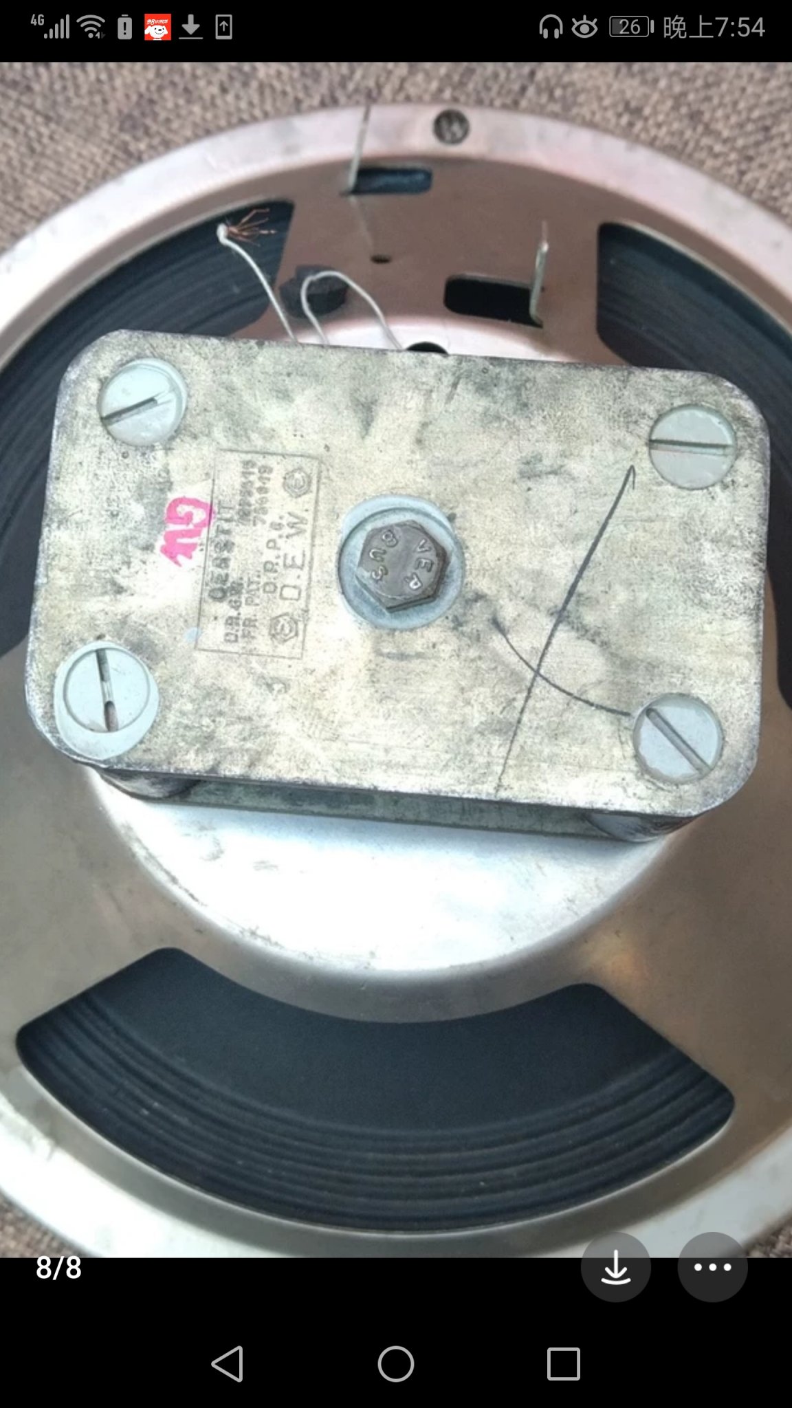

Good question actually, neither driver explicitly labelled. The rectangular magnet structure older driver was represented as Telefunken, the other as Siemens, by an Idlefish Market seller (i.e. bulk importer) of old German speakers and tubes etc. Soundclips were promising and price was right, I guess 🙂Who’s German drivers?
The 1930s "Funk" is quite unusual looking; the Siemens shape is pretty commonplace (on Idlefish Market anyway) except for different magnets.

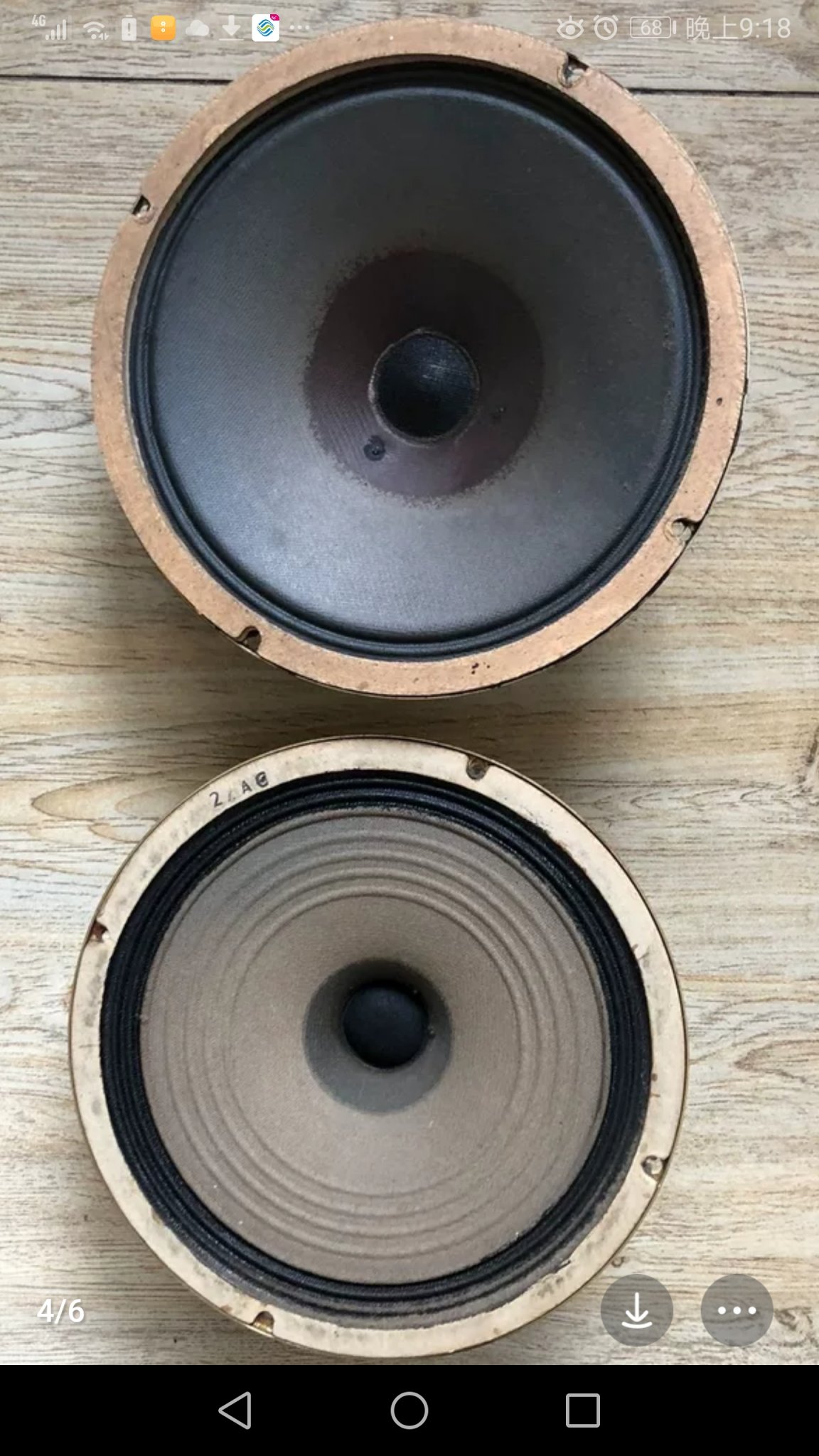

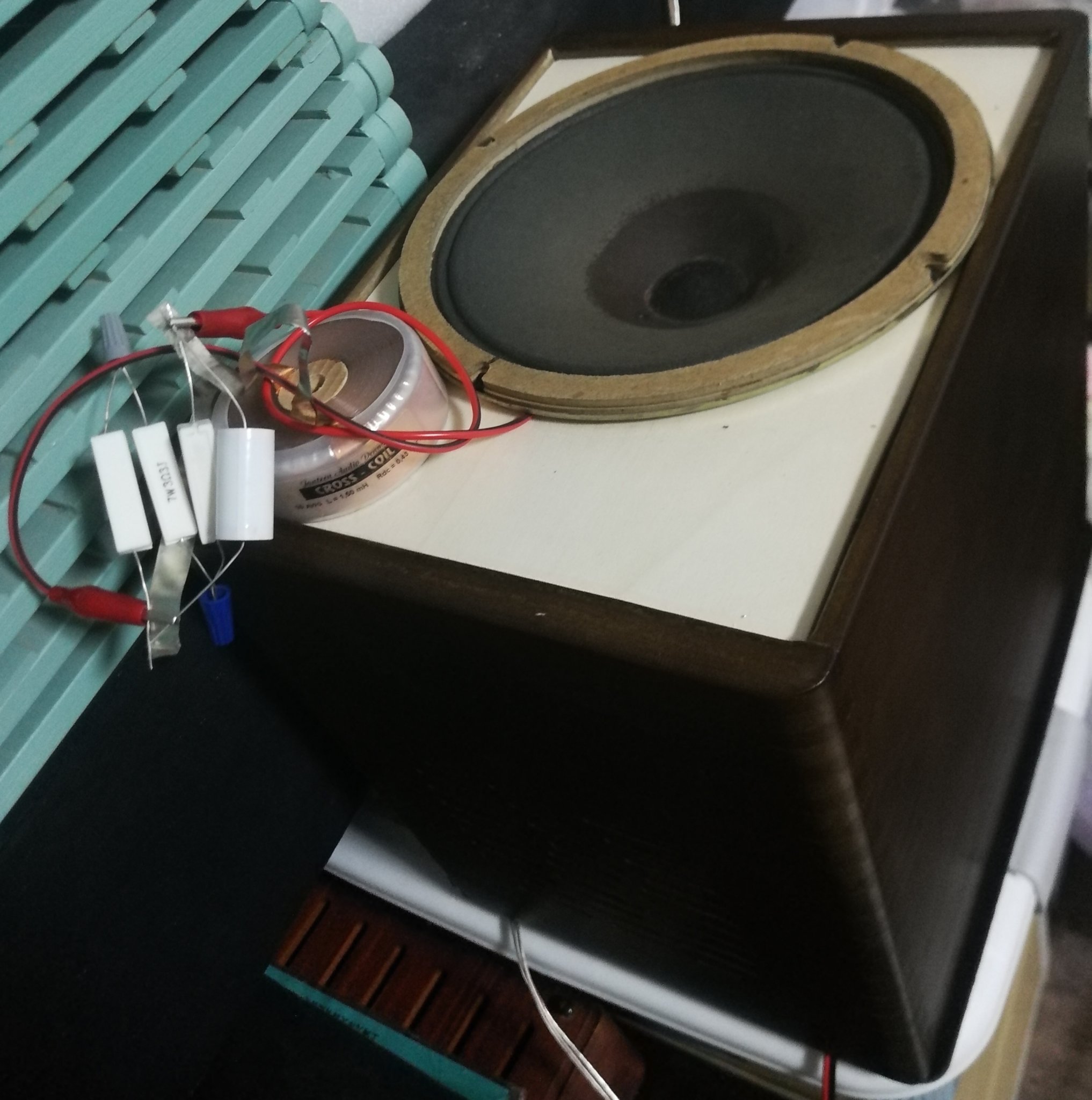

But... encouraged by the old Germans I quickly snatched two 8" Celestion taken from one vintage radio console -- 15ohm mid-woofer and 5ohm mid-tweeter so to speak. If midrange covered 80-8k. Long story short -- I made them close-enough sounding by levelling-off the mid-tweeter's HF using (1.5mH||9ohm||2.7-3.3uF? yet-to-be-finalized), in 14L aperiodic. Now each sounded basically flat 75-9000, extending to 60-11000. I really like vintage Celestion's mellifluous, faintly-glowing sound, but they are rather hard to find and somewhat expensive. So I finally have a "pair of eights" for $90.

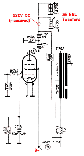

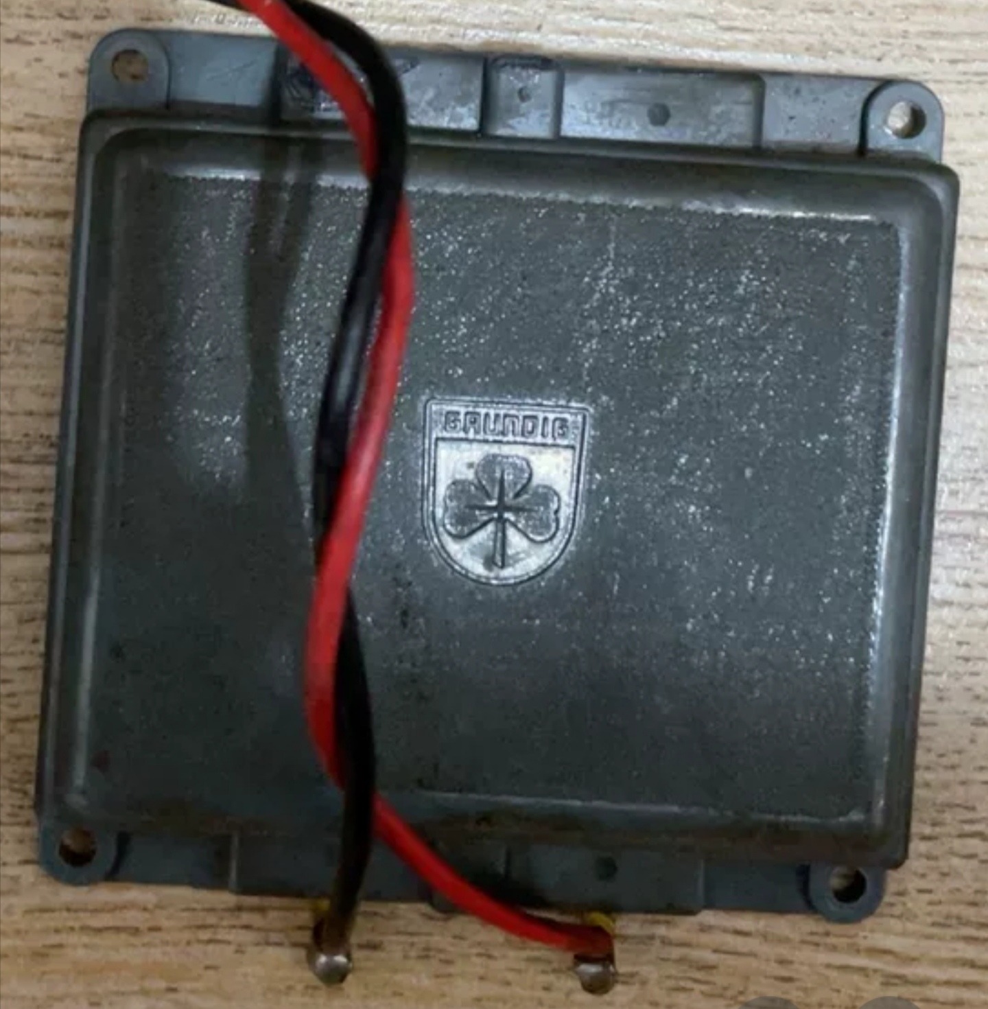

An electrostatic supertweeter (labelled Grundig) was part of the set, but at normal max voltage was way too faint to be heard especially above 9khz. Ideas anyone?
Interestingly, the two eights played straight-through wired in parallel sang gorgeously together -- as originally designed. Like my "stacked pairs" of complementary speakers (stereo bipoles).

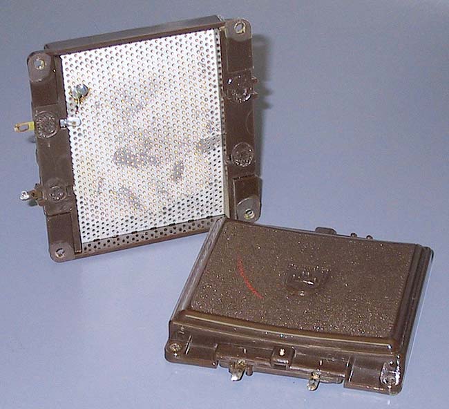

The Grundigs are an example of the very common use of single ended ESL tweeters driven directly by the output stage bypassing the OPT. The bias also comes from there.
There is a whole thread on them i believe, i know i have posted. alot of pictures and some information at least a couple times.

Much thanks. I could only find 2006 and 2021 mentions, a "used FR drivers second life" thread for cones (ID by fuzzy picture wow), and a couple of occasional pics and circuits, one pic matching the Grundig. With only two wires red & black coming out of the ESL twitter unit, I'm still at a loss how to supply plate & bias high voltage from my EL84 (if and when I decided to try it for the experience).
The radio console from which it came did have a junction plate with two small-size resistors (the seller forgot to send) either for the ESL HV or for balancing the cones. He's going to try to get another console from the UK....
