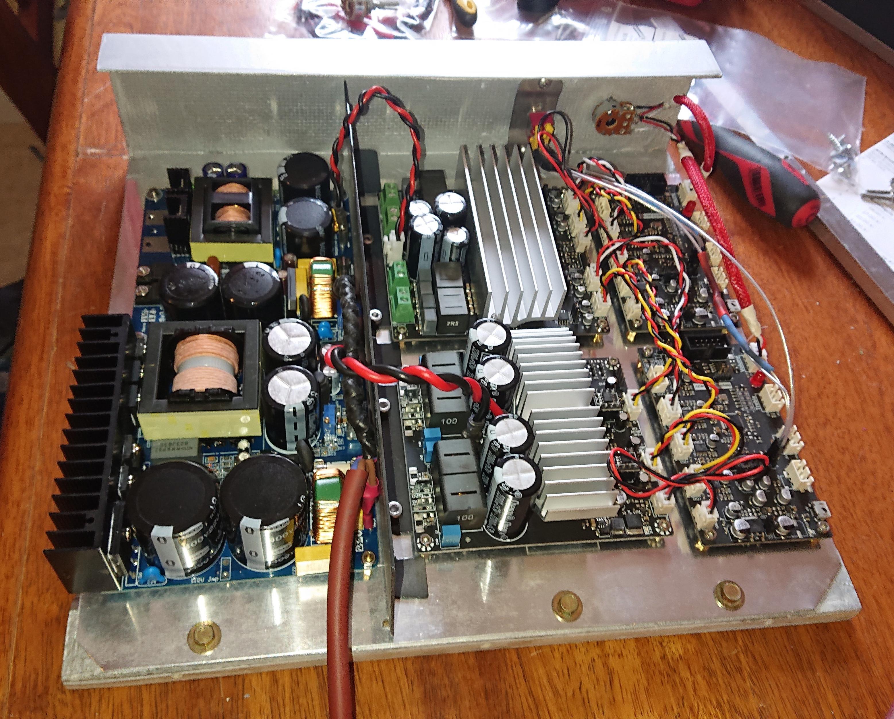

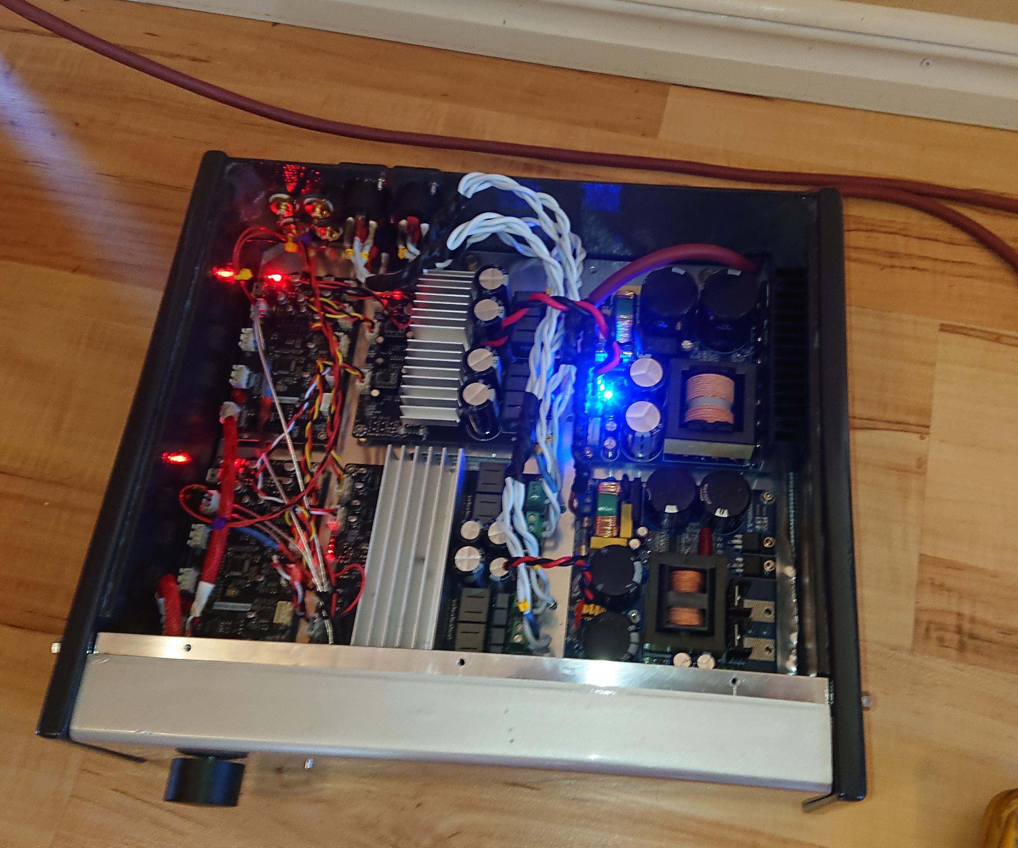

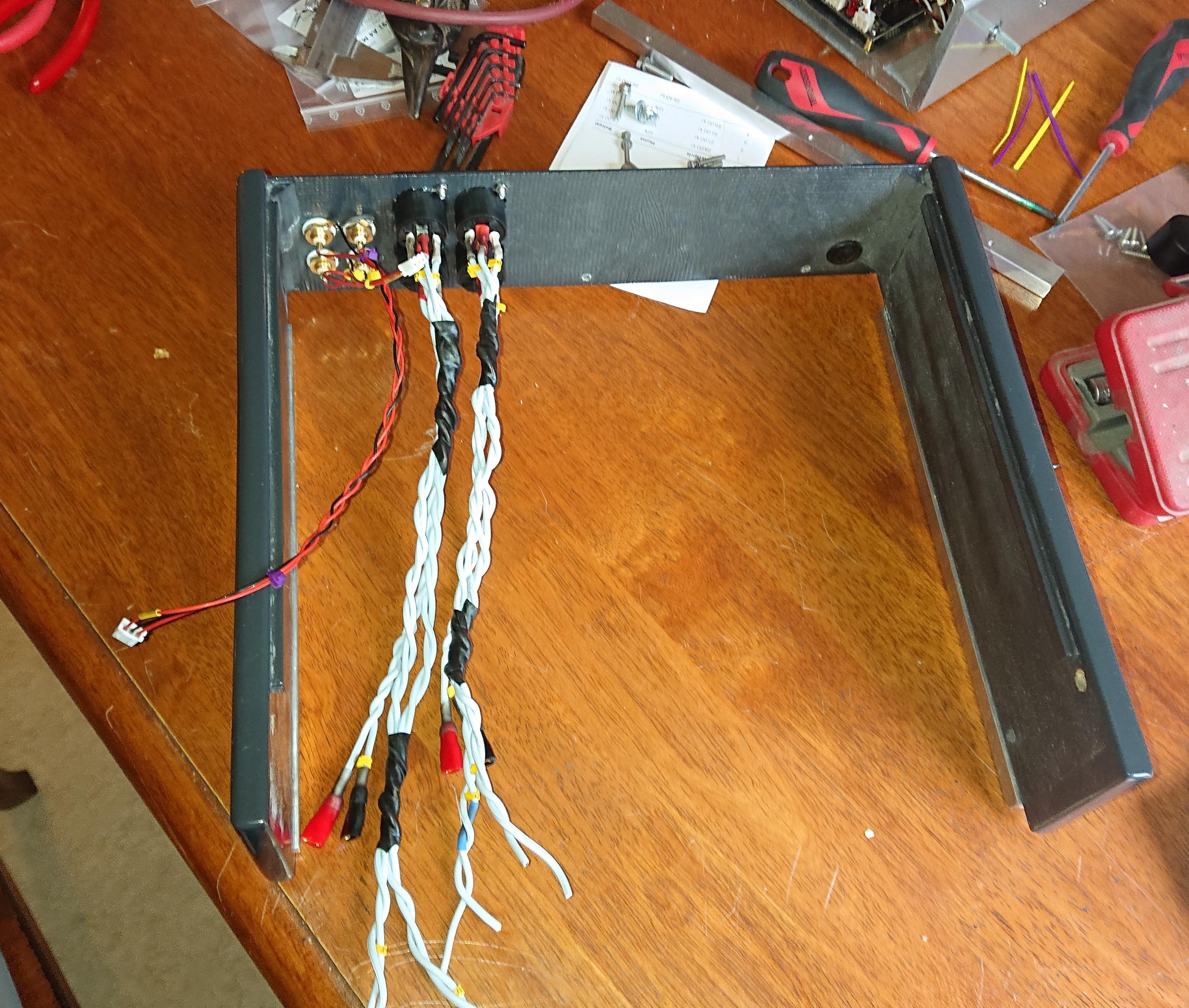

Here's a photo, I figured I'll tidy up the last bits when it's time to close the lid more permanently. 🙂
It's a 3E DSP/Amp setup, with Connex PSU (in that order left to right on the picture as well).

From your source to your speakers please, and can you describe the signal ins and outs as well as the physical ins and outs?
I'm sorry if that sounds like a lot. I would do it in a simplified way while staying relevant..it's not easy to communicate that though.
The source is my PC, usually an upgraded soundcard but for measuring the external soundcard is used. (cable connection)
The RCA in on the box is to the far left on the picture, I use one DSP board for left and one for right channel. So I used the extra input for one added source to select by I/O. (Top RCA to one DSP, bottom to the other)
The DSP is then wired balanced to the amplifiers (2 channel TPA3255, 4 channel TPA3251).
Power is supplied by two Connex PSU (28V/300W + 55V/600W), the amplifiers then supply 12V to the DSP units.
Speaker wires are soldered to Speak-On.
On the outside the wires goes directly from the Speak-On to the drivers, cap for tweeter is in the box 10cm from the driver.

I'm feeling a problem with the way you've connected this. I'm wondering about DC, where the amps are referenced, connected to the same supplies, is something not connected.
If I were you I'd stop using it and start a fix thread in line level. I'd begin by measuring for offsets at the outputs, including your amps.

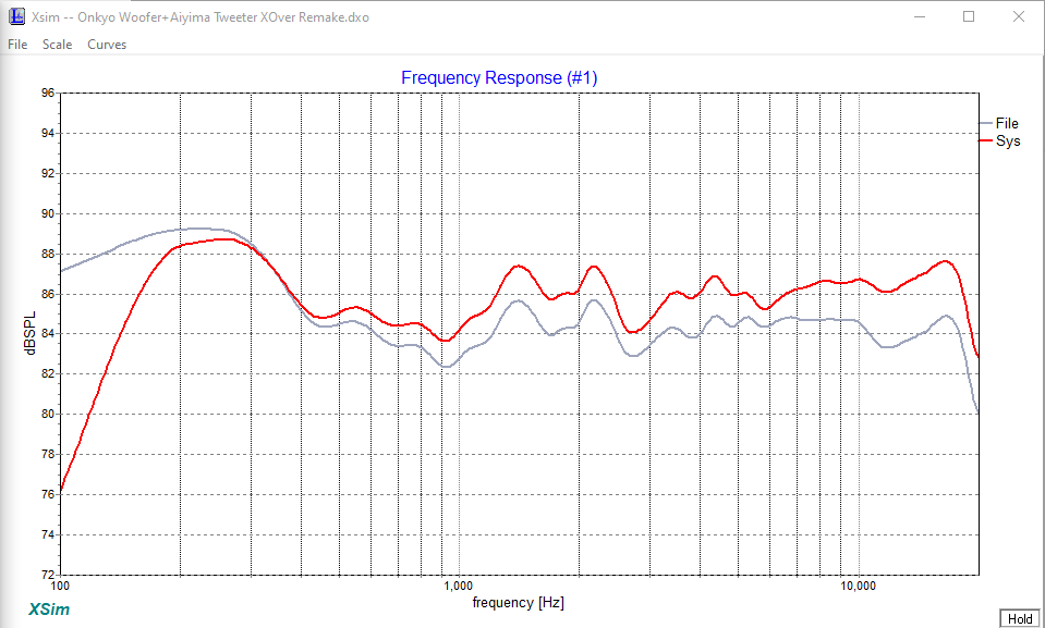

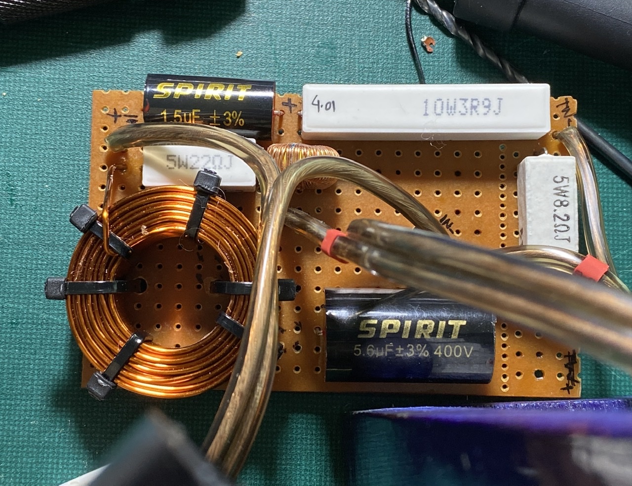

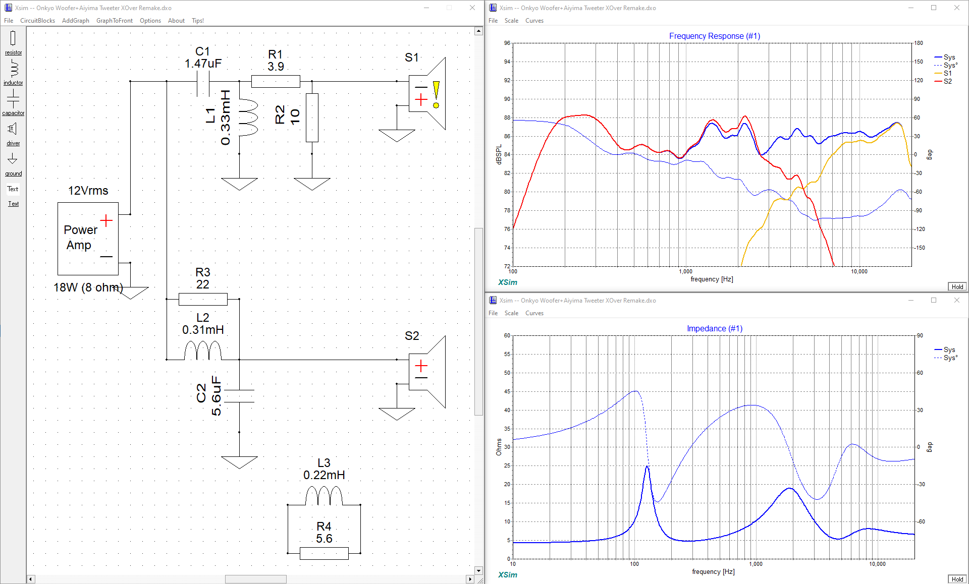

After some months listening to the blue speakers, I feel they are kind of “dark” in their sound. I decided to redo the crossover, running simulations in XSim from scratch. The original crossover design and layout can be found in the quoted post, and the new crossover is attached below. In the frequency response graph, the red graph is the new one, and the gray one is the modeled response of the first crossover. I do feel this reworked crossover takes the build to a new level.
They are actively crossed over at 90Hz to a 12 inch sub.
That's the way.
So it seems you've removed some of the baffle step. Normally I'd say this shows that the 'lost' 6dB is actually still in the room and having an influence. It's a frustrating phenomena when you first encounter it.
