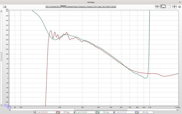

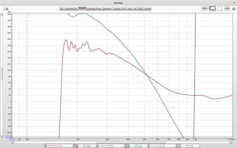

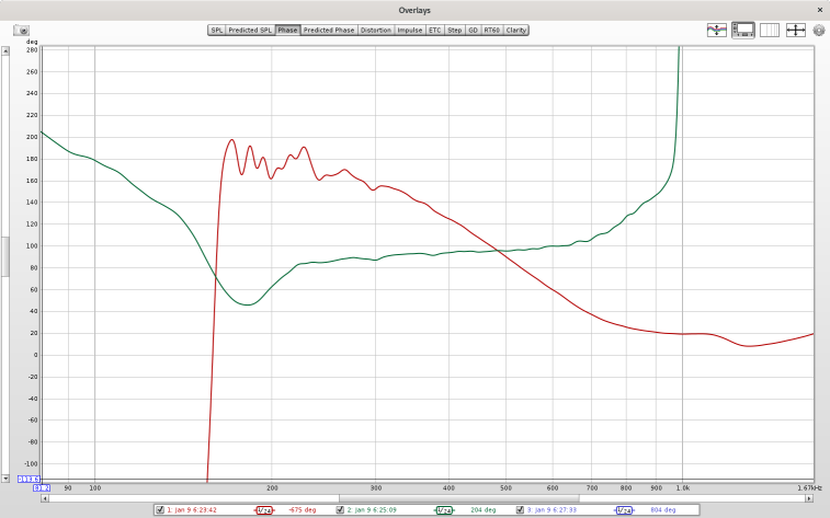

Take this example of time from the last post. These are phase plots for two drivers that I was crossing. I gave them complementary response slopes (not shown), so phase should be able to line up.
Next I've shown three examples where phase meets at the crossover frequency. In each case I made an adjustment to time, and to polarity. The correct one is easy to see and now they are in time.
Yes it's time consuming work more than anything I guess, well with a passive crossover it can get expensive and 'a bit' more complicated as well.
