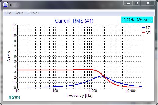

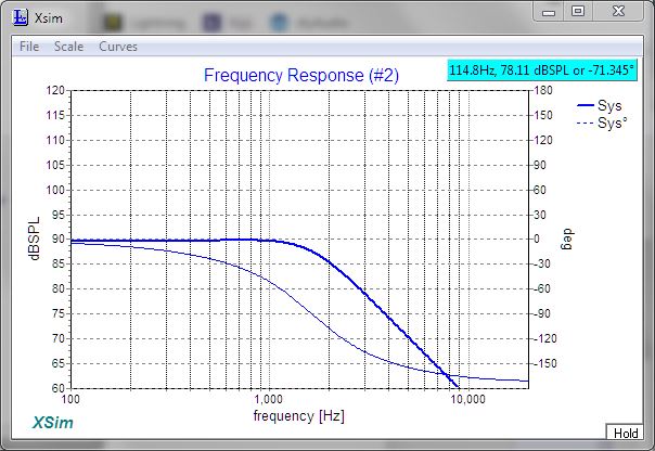

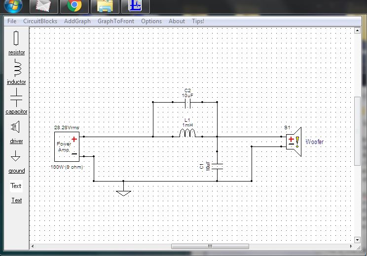

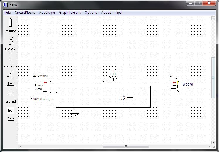

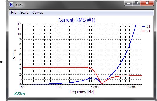

What is missing when simply looking for a given effect is the analysis of the entire circuit, and it's side effects.
As an example: lets take a look at one simple circuit, a bog standard low pass filter for a woofer.
The first image shows you the XSim schematic. Note that in the second image the frequency response is as expected, the output rolls off with increasing frequency. The third panel shows the currents through the woofer (red) and the capacitor (blue)... both as expected.
Now lets add what is often mistaken for a baffle step capacitor. The fourth image shows you the schematic. The last image shows you the current through the woofer (red) and the shunt capacitor (blue) ... Wait a minute, how did that happen?
Well, the answer is that when you added C2 you created an accidental path to ground through C1, which is drawing some pretty significant current from the amplifier... potentitally enough to damage it.
The missing element in avoiding mistakes like this is the knowledge of how these parts operate ... Capacitors pass more and more current as frequency increases. Thus C2 is able to bypass L1 creating a new path to ground through C1.
