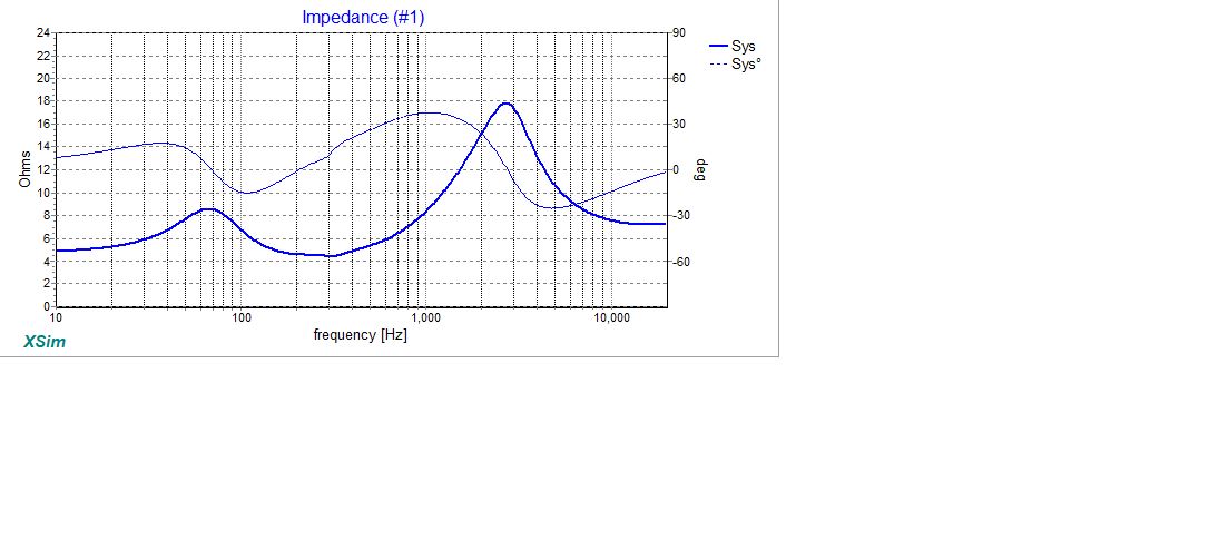

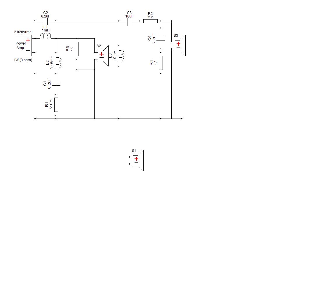

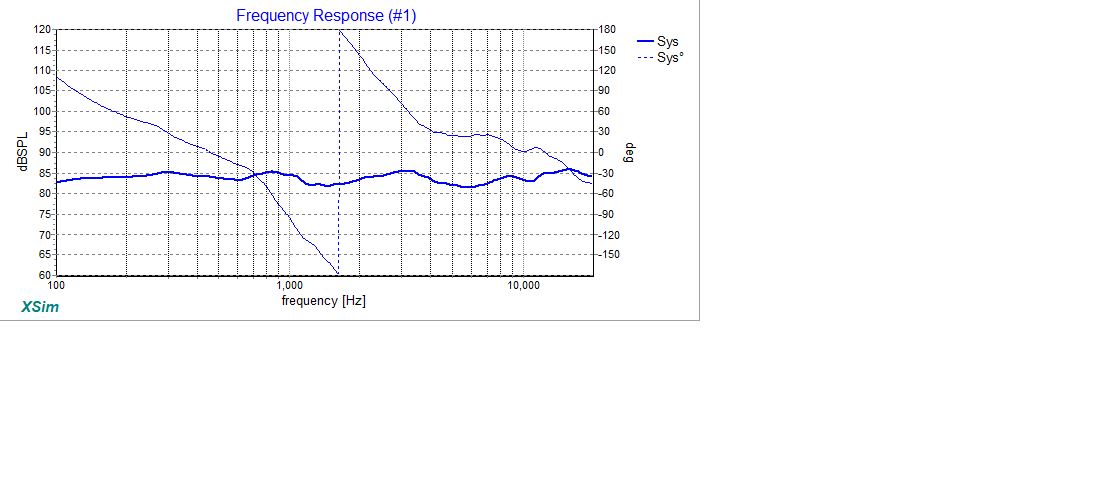

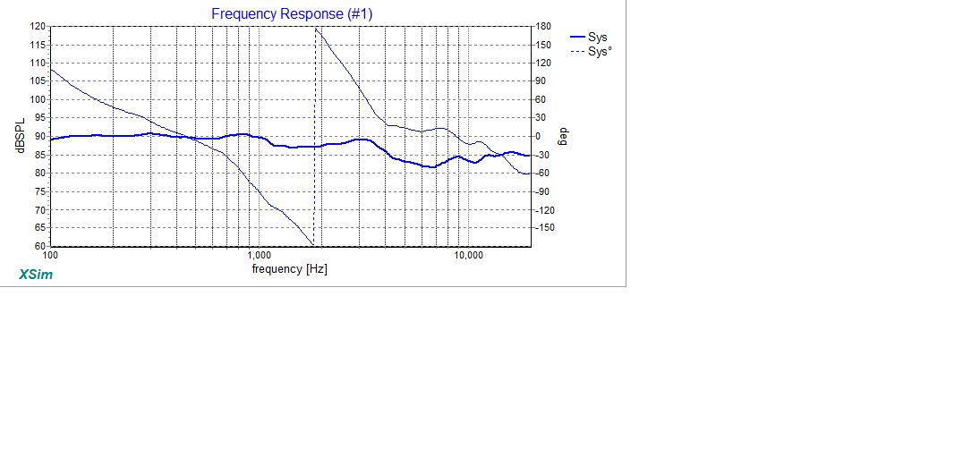

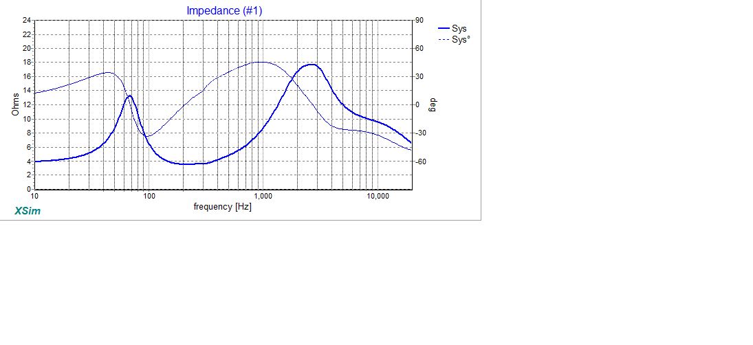

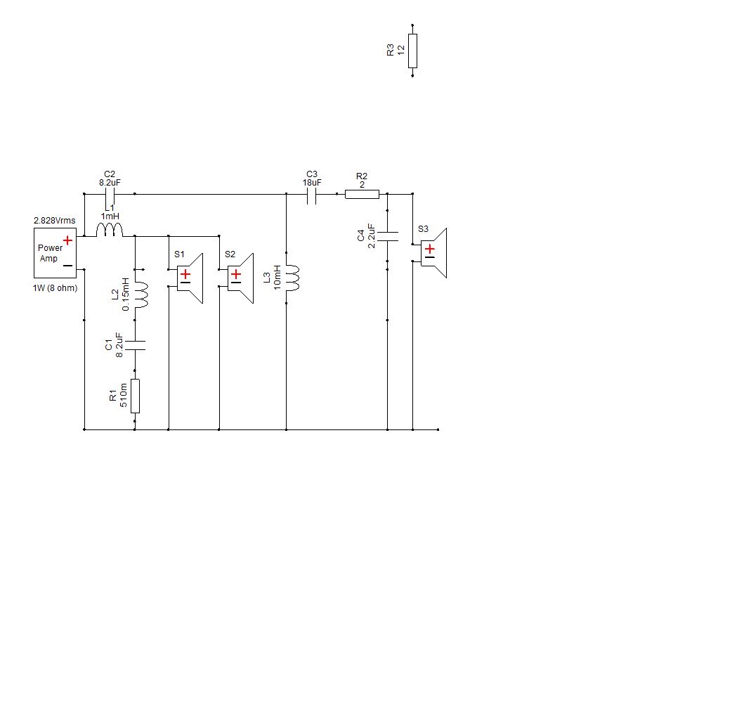

first crossover design help
Hi I have some components on hand from a set of thor speakers the mag drivers are corroded so I am replacing with seas Nextel speakers. After reading the design your own speaker from scratch I have been working on using the existing cross over with modification. Attached are two options one is to use the small thor cabinets the other is to build a smaller TM cabinet the two crossovers and graphs are attached. I read about the impedance area and have reduced it but I do not know what the max impedance should be or what the impact is of having high inconsistent impedance is I understand low impedance stresses the amp. I would also feel better if I knew that neither crossover will destroy the tweeter. I would like to reuse as much as possible and buy as little as possible. Any help would be appreciated. Cabinet suggestions would also be appreciated. All of my rooms are relatively small and we listen at low to mid volume. I would like to line up the drivers by moving the mid or mids out if that would not hurt anything
thank you
