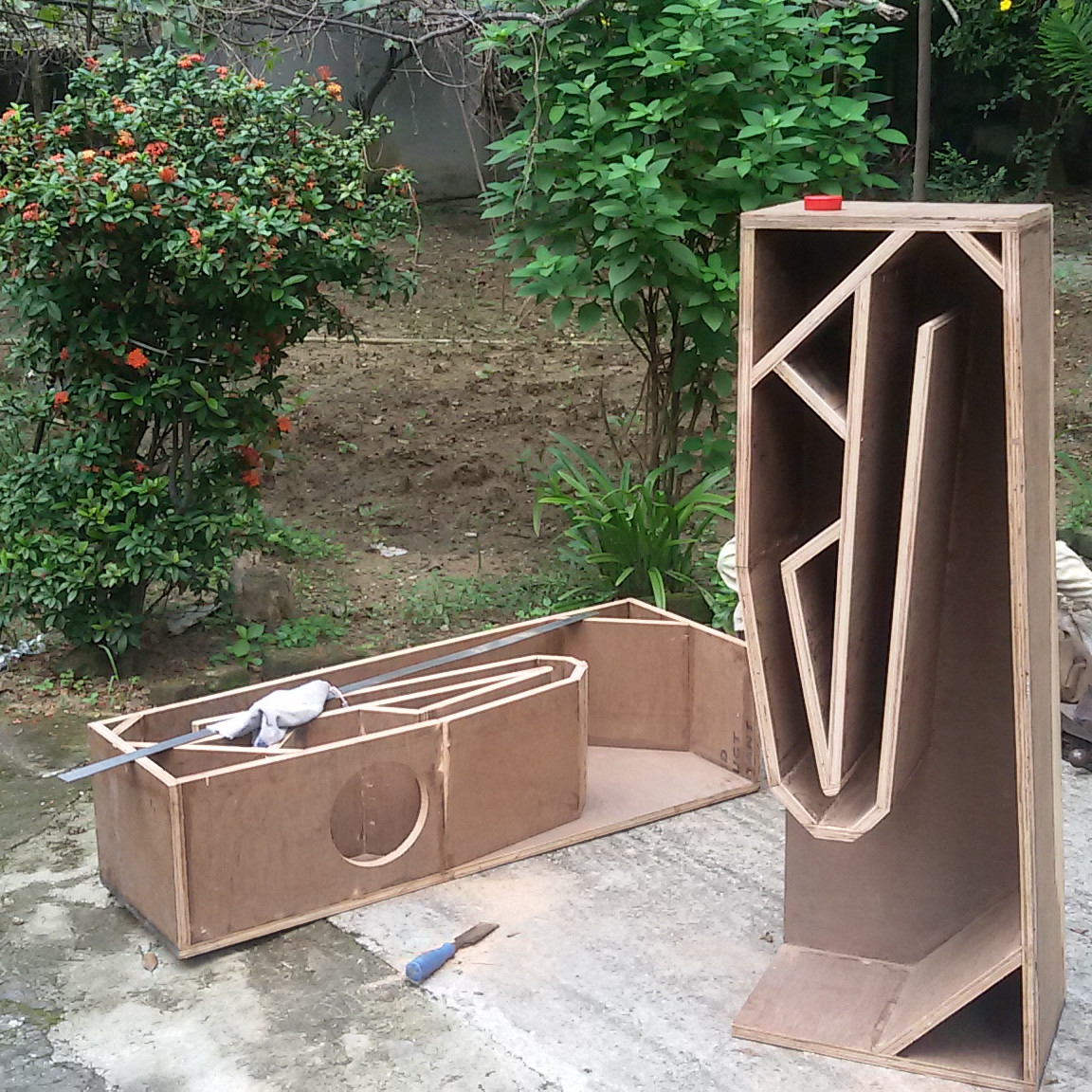

Hey wintermute, here's a sub-section you may want to add to the box construction post. The point here is to show how some boxes don't need bracing. They're already too well braced. This is a photo of an under-construction enclosure at FM Corbato's place. He's permitted me to use his photo.
Some boxes are self-braced
Some boxes require the construction of sophisticated internal chambers or pathways to handle the rear wave of the driver. Two examples are back-loaded horns (BLH) and MLTL (mass loaded transmission lines).
Here is a photo of a BLH under construction:
This sort of speaker needs the enclosure to have a long and tapering channel to guide the rear wave of the driver. The most convenient DIY way to make such a channel is to make a folded channel by placing partitions inside the enclosure as shown. These partitions are made of ply sheets which fix against the two sidewalls, thus bracing the sidewalls so well that no further bracing is needed.
Therefore, the entire challenge of bracing for inert enclosures is bypassed for BLH or MLTL enclosures most of the time.
