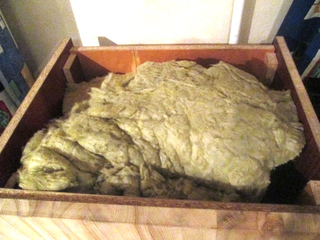

Designers of vented enclosures note that if you damp so effectively, it also takes a little of the sting out of the main (wanted, bass-reflex style) lowest frequency box resonance.. and now it's compromise time regarding how much to use and how.
So along comes the myth that ported boxes should have only a thin lining of damping material. It is often missed that the higher order (higher frequency, unwanted, standing wave style) box resonances still occur in vented boxes as well.
In conclusion, I think it comes down to your damping strategy in any case.

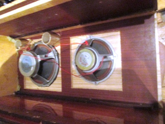

I ended up using lots of rockwool cos the local hardware shop had loads of it on discount cheap...

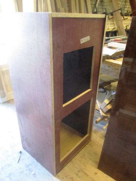

You can see how the cab has been constructed first with a front with 2 templates in (large square cut outs), then a detachable front which is bolted into place over the top of the template.
I have never seen that done before, and it has carefully made chamfers all over to try to mitigate reflections.
The ports are just above the lower (15") driver, of different lengths to cater for the different sizes of driver (12 and 15")

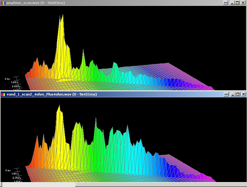

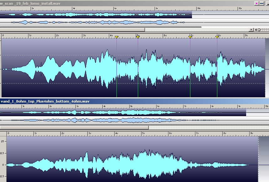

Basically I used the same studio microphone for tests to measure scans 20hz-20khz over a 10 sec test.
distance was less than 1m to try to reduce room effects.
It was possible to measure 2 "hi end" speakers in the local shop.
Vandersteen 2cx including a back to back test using SINGLE and genuine Biwire arrangements.
I also tested Amphion which turned out not to be 8ohms (very much) but more like 4 most of the time.
Matching the speaker to 4 ohm taps rather than 8, therefore seemed to make little difference to SPL but changed output spectra recorded on the DAW. 🙁
Then the Vand speaker of course, which had a flatter response curve...

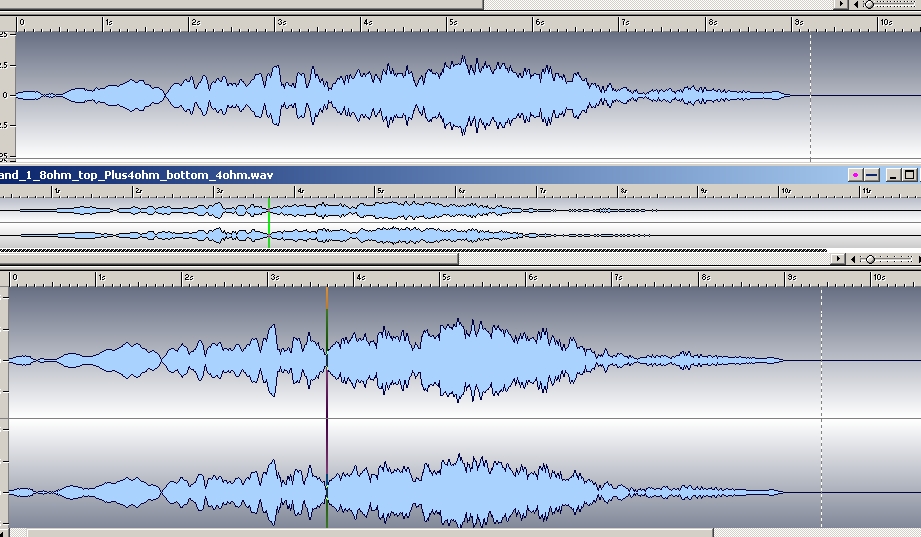

(the bi wire back to back test with seperate taps on the output transformer proved beyond doubt, bi wiring changes the spectra).
The KT8 amps used were 50W amps which we know have quite a flat output across the entire audio spectrum (known entities).
I don't think they are vastly different from the home studio system.
We used the same methodology to test the AMPHION speaker (Finland).
Amphion think a lot of themselves, but we proved it suffered a devastating "boom" period, and apart from that has little treble and poor bass. As you can see compared direct with the Vand.
The Vandersteen type test was repeated back at my studio, AFTER I had added the Lomo horn, so we could directly compare the spectra seen by the same mics at close range (but in a different room with wood floor and good damping)
Ahum.
Well this is a quite valid test which demonstrates the horn has tremendous performance right off to 20khz.
The vandersteen had at least -10dB at the bottom end and pretty much the same at the top.
Another graph shows the principal consideration.
Getting linearity at 40hz.

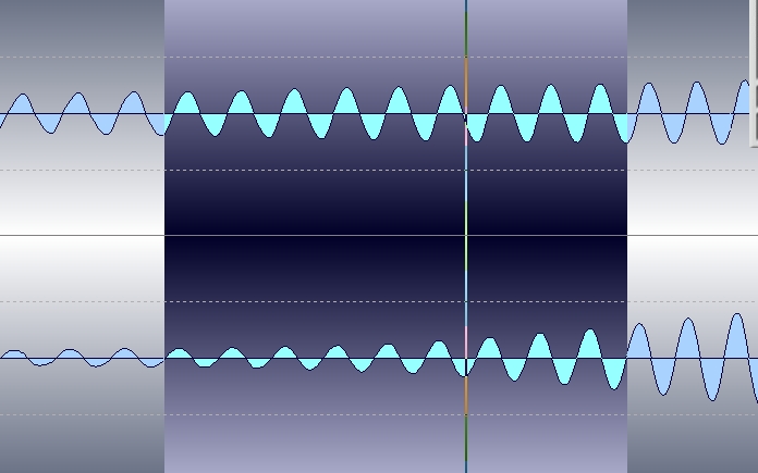

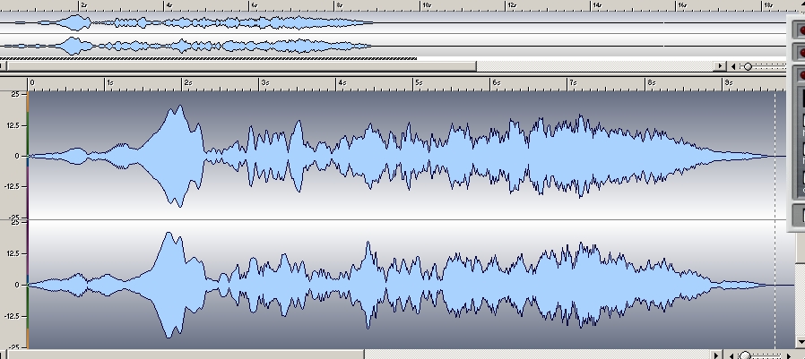

Below this you can clearly see distortion in the recorded waveform, in the "monster" but of course the ear is relatively insensitive to this.

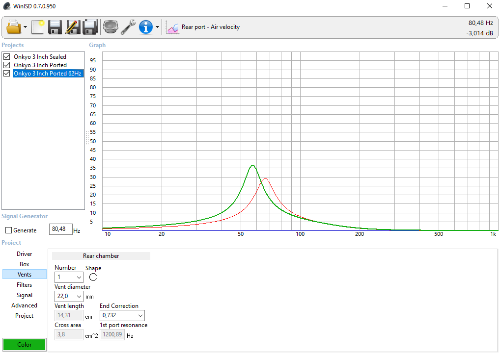

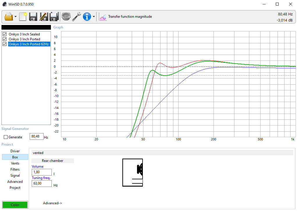

Thanks Allen. That pushed me towards the ported box again. 😉 I share my findings below, please feel free to share your thoughts, Allen.In conclusion, I think it comes down to your damping strategy in any case.
Thanks Tony. I've read your thread all the way through. Nice drivers from SB Acoustics, I see.Here is a small BR speaker I made SB acoustics SB12MNRX25-4 "full range" Build thread These actually sound surprisingly good.
If you don't care about the low bass output because you are going to crossover to a sub anyway, I would definitely change the tuning to something a bit more flat than your winisd plots show. The transient respsonse should be a lot better too.
Tony.

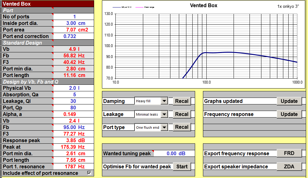

Thanks for the pointer. I ran all the different ported alignment on WinISD, and it seems for this driver, the flattest I can get is actually close to EBS3 alignment.
Unfortunately (and sorry for not mentioning earlier) I'm stuck with 2 liter net volume max, since the box is halfway built. Counting for the port and driver displacement, I got a net 1.8 liter. With the box dims and this tuning, I'm stuck with approx. 1 inch port ID.
Red= 2 liter volume, 72Hz tuning, 26mm port ID
Green= 1.8 liter volume, 63Hz tuning, 22mm port ID
Any comments on the frequency response and air velocity for the green graphs? Thank you again. 😱😱

Johnathan, don't be scared to try arbitary alignments, you don't have to use one of the established ones. They are all on a continuum really, and some other tuning may work better with your particular driver. Since your volume is already fixed, try moving your tuning frequency up. keep increasing it and see what it does to the response curve. As you are going to be crossing above 100Hz you have a fair bit of room to play with.
Can you post the T/S params of the driver?
Tony.

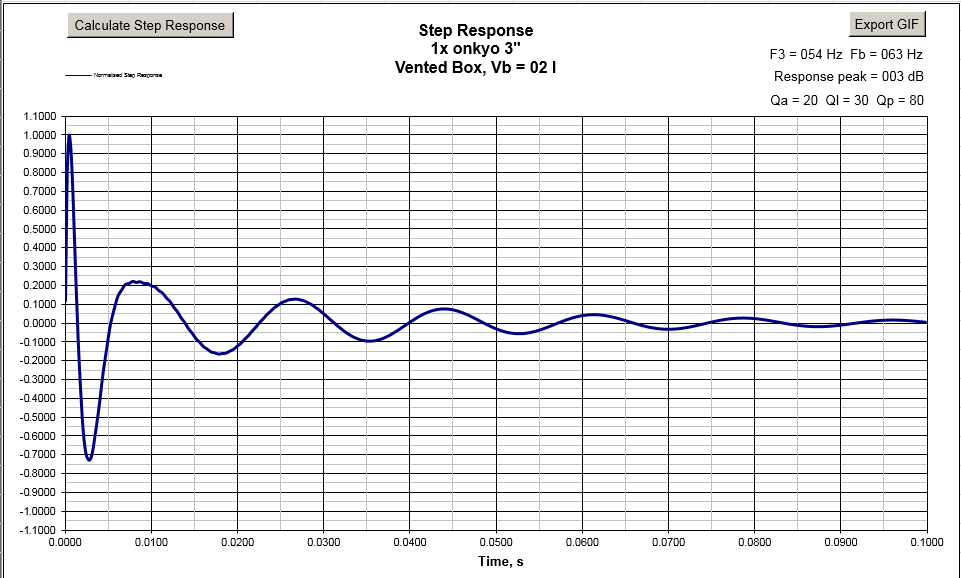

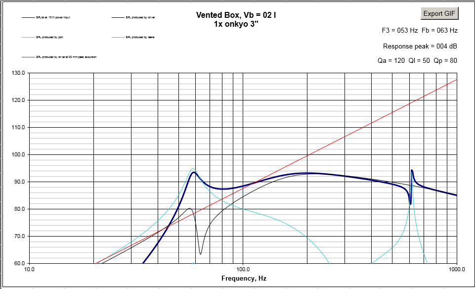

Many thanks, Tony and everybody!
Ported boxes are often used to push down in frequency. If you push too hard you get an uneven response that can be troublesome. Look at group delay in the sim and try to be gentle. This should look better with a smooth response. You may not reach the lowest frequency, but the upper bass is more important and you can always add a sub or two.Thanks Allen. That pushed me towards the ported box again. 😉 I share my findings below, please feel free to share your thoughts, Allen.
Since I'm not an English native speaker, I'm afraid I have to ask: which area is the "1st derivative of the FR curve should"?
It is in the universal language of math, so it matters not what your native language is :^)
The easiest way i can think of translating this is that the curve should only have at max 1 place where the curve goes from movin gup to moving down in the LF. You have 2 in each of your sims and i have found that designs not following this rule are the ones that give BR a bad name.
dave

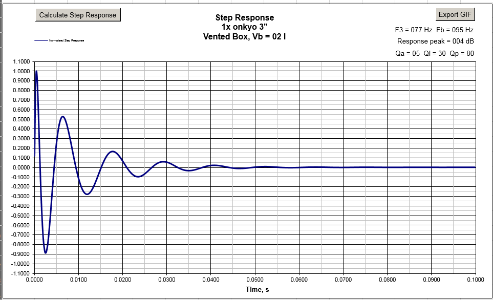

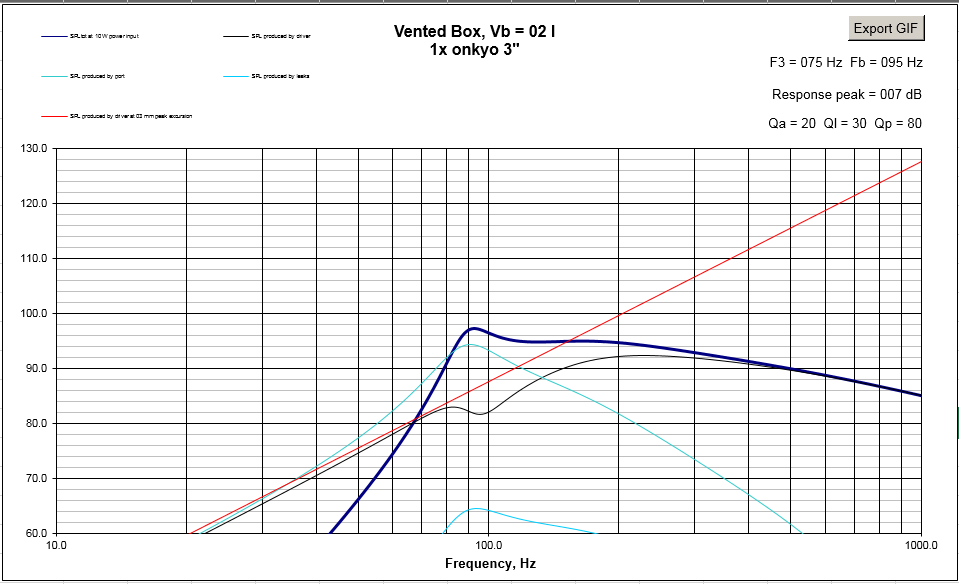

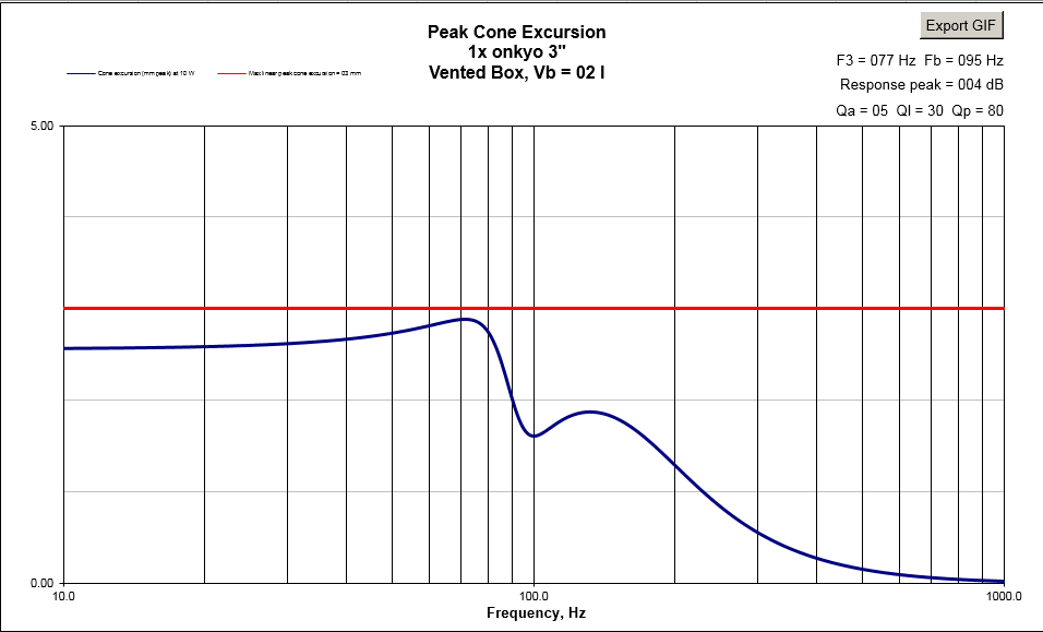

OK I had a play in unibox, it's not easy getting a good FR curve with this driver. Totally ignoring convention, this is what I came up with. Not sure how the heavy fill will go in reality, maybe will make it a bit more aperiodic than vented, but it was the only thing that seemed to work to get rid of the hump at the end. May want to go even a bit higher tuning freq, perhaps 100Hz to get rid of that slight dip around 120Hz.
Should be able to handle about 10W without issue (assuming the 3mm x-max I guessed is reasonable).
edit: added comparison of sealed vs vented.
Tony.
Tony.
Thank you dave for this point, I will keep in mind for my speaker builds! 🙂The easiest way i can think of translating this is that the curve should only have at max 1 place where the curve goes from movin gup to moving down in the LF.
dave
Tony.
Tony, thanks a lot for taking the time to simulate in unibox. That does look like a nice tuning, I think I will go ahead with that.
So volume is 2L, port ID 2.61cm, port length is 7.55cm, line the inner walls and heavy stuffing?
I've tried 2L/90Hz in WinISD before, but it resulted in an unsightly hump. Is there a known discrepancy between the two softwares?
Thank you again for taking me through this process.
I hope I didn't lead you to feel that a box needs to be heavily stuffed. The only time you need that is when you are trying to damp the fundamental (wanted) bass resonance, such as in lieu of making your box larger. This is a popular move with closed boxes.
20% of each dimension has been shown to work sufficiently on average, against box modes, when using an effective damping material such as fibreglass or rockwool. 40% can be better for modes, but this is the compromise range.
That's probably more come from me Allen, just a happy coincidence I suspect 🙂
Jonathan, the port is actually 3cm the 2.61 is what unibox says is the minimum (based on the 10W I put as input)
On the difference between unibox and winisd there are quite a few things you can tweak in unibox, it is possible that some of the parameters are different to what you have in winisd. I never really got into winisd, I've relied on unibox. Can you specify stuffing in winisd for a ported enclosure?
Below is how it sims in unibox with 1.8L and 63Hz which is what showed on your last winisd sim. This is with no fill and no leaks. Note the step response! It shows both the much worse transient response and also the port resonance. edit: actually I see you had a 2.2cm port diameter, that completely removes the port resonance, but will also probably get chuffing if you push it. I added the sims with the 2.2cm port as the 3cm port ones are pretty ugly in comparison! 😀 oh and the 2.2cm ones also have walls covered, not bare.
The third is the 2L 95Hz tuning but with walls covered rather than heavy fill.
Tony.
Tony.
Hi Allen: Yes that came from Tony's post before my last one 🙂 Thanks a lot!
Hi Tony: Yes we can play with Qa in WinISD, I used the guidelines below when I do my sims. These figures seem to be circulated around the web, but here's one post on DIYAudio forum:
I'll play some more with UniBox and WinISD to have a better understanding, will catch up with you soon. Thanks a lot!
Just as a FYI, I use the following rule of thumb for Ql:
Closed box, small < 30-liter : Ql = 20
Closed box, medium < 100-liter : Ql =10
Closed box, large < 300-liter : Ql = 5
Vented box, small < 30-liter : Ql = 7
Vented box, large < 300-liter : Ql = 5
For Qa (box stuffing) I use the following:
No fill : Qa = 100
Minimal : Qa = 50
Normal : Qa = 10
Heavy : Qa = 5
Best regards,
Sander Sassen
Hardware Analysis - Computer hardware news, reviews and forums that provide help and assistance with problems.
Tony, I agree, the port resonance and those squiggly step response are ugly.
It seems 2L 95Hz with walls covered is a nice starting point. I will line the walls, and listen/measure. I guess I can always add some stuffing later on, right? 🙂
P.S. sorry I meant to edit my post with this addition but was unable to save, it seems I juustt crossed the 30 minutes mark..
