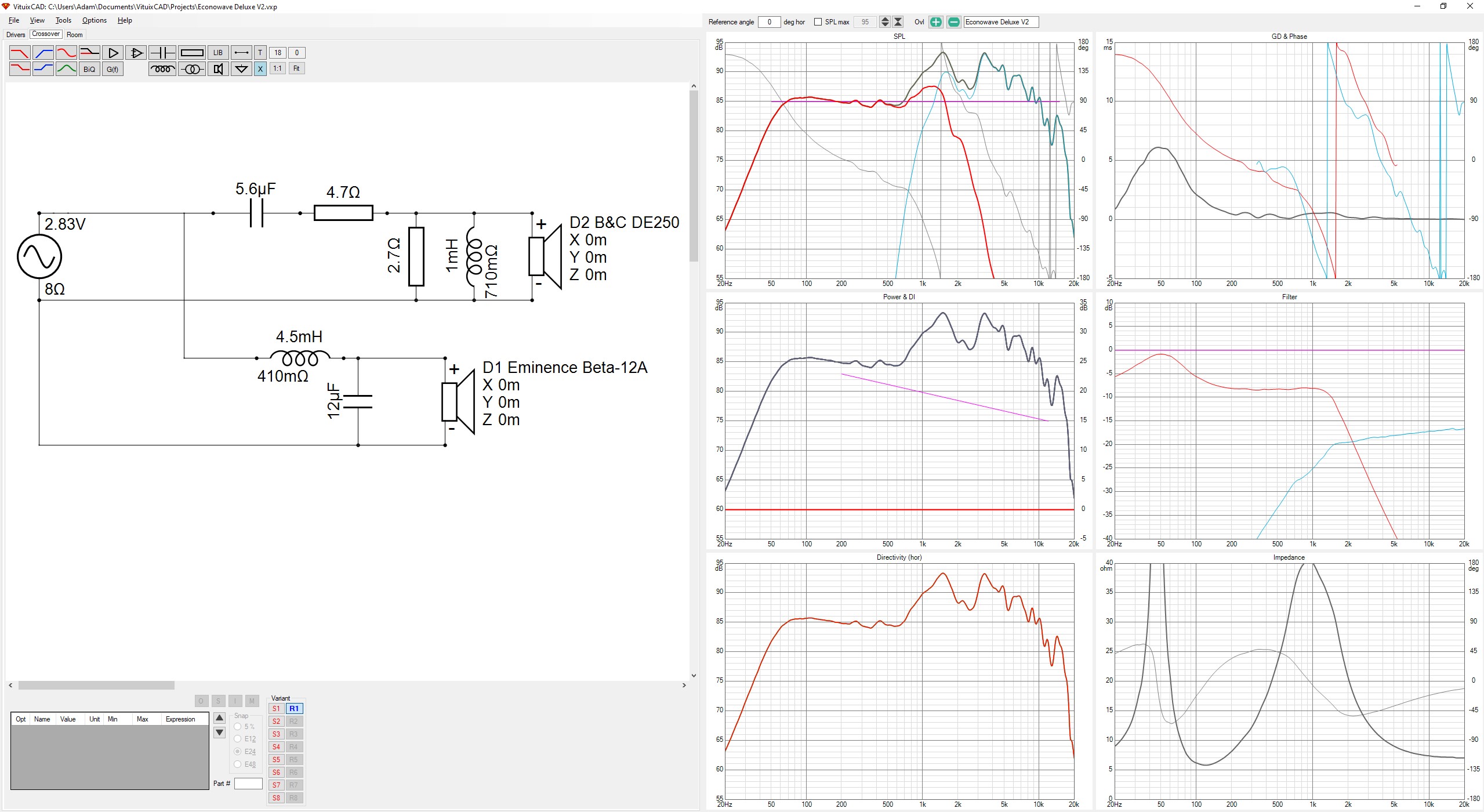

Thank you @AllenB for your thoughtful response! I know I have made a real challenge for myself.
Gainphile has done some work on this specific waveguide and compression driver. His design uses an active crossover though, so he hasn't detailed a specific schematic as such. Essentially what I was trying to achieve is what he has done with the active in a passive model.w
What he has said is:

It looks as though gainphile started with a generic filter type, hit some peaks, pulled down the level and adjusted the phase.
There's not much in that to help here, other than the approximate frequency, and the need to have no less than second order filters to keep the woofer away from breakup. The question is, how do you intend to do yours? Will you set up an L-pad to reduce the level and use a second order filter, or will you try to measure and sim?

Not sure if this helps any further, but I have managed to get FRD/ZMA data for both and after trying XSim, Engauge Digitizer and VituixCAD, I have come up with the following crossover and graphs.It looks as though gainphile started with a generic filter type, hit some peaks, pulled down the level and adjusted the phase.

Hi all, I figured out the issue with my crossover network and it is now looking really good! Thank you so much for your support and I will keep up the study and reading. Really keen to buy a UMIK and MiniDSP to start taking some measurements.

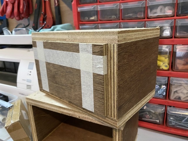

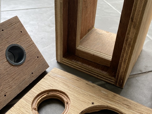

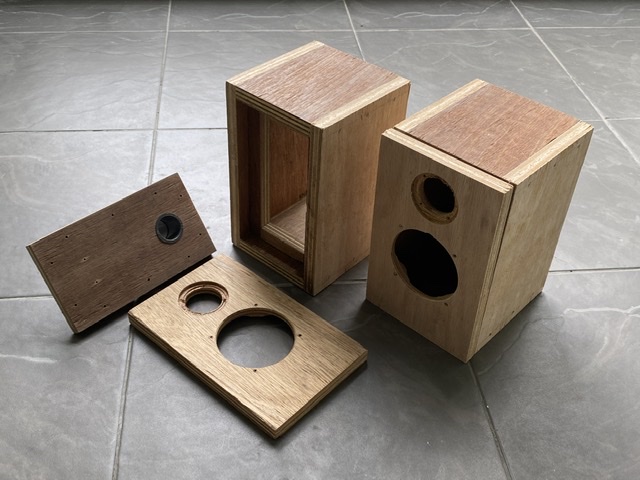

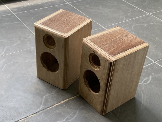

Hello Folks - another progress report.
- The baffle has been drilled and chamfered - the difficult part was chamfering with a router without seeing much, I had to go by feel to leave some "meat" around the screwholes.
- Mounting battens and back panels have been trimmed to size - Easy enough but requires a degree of care with the miter saw. Very satisfying when the back panel slides in and holds itself by friction

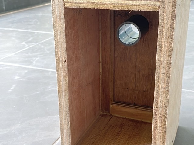

- I was thinking of using two 22mm ports but I was afraid I'm not gonna have enough space for crossover in the back panel. Another consideration was, the two port holes closely spaced to each other posses a risk of tearout with the material I'm using. I end up with single 26mm port, which according to Unibox limits me to about 90dB SPL before chuffing is introduced.
As always, here's some questions:
- Is it now okay to glue the front to the main enclosure? Or do you guys suggest I do roundover first, or install internal lining first? Then glue it to the main enclosure? This is a 2 liter enclosure, mind you.
- Should I fix the port now to the back panel, and consider them as one "unit" when it comes to finishing? I am planning to glue them in place with some epoxy glue, and afterwards do some roundover to create port flare.
Thank you again.

Looking good It's always a bit tricky deciding when to do the final gluing. I in the past have held off on the final gluing, doing some tests first with the baffles held on with picture frame straps The one area that could be difficult would be if you decided you needed to tune the port length. It may be better to not glue it in till you are certain the tuning is how you want it.
Closed cell foam tape can be used for a seal when temporarily holding things together for testing
The main thing is going to be, will you be able to do anything through the main speaker cutout. It's fairly small so will limit access.
Tony.

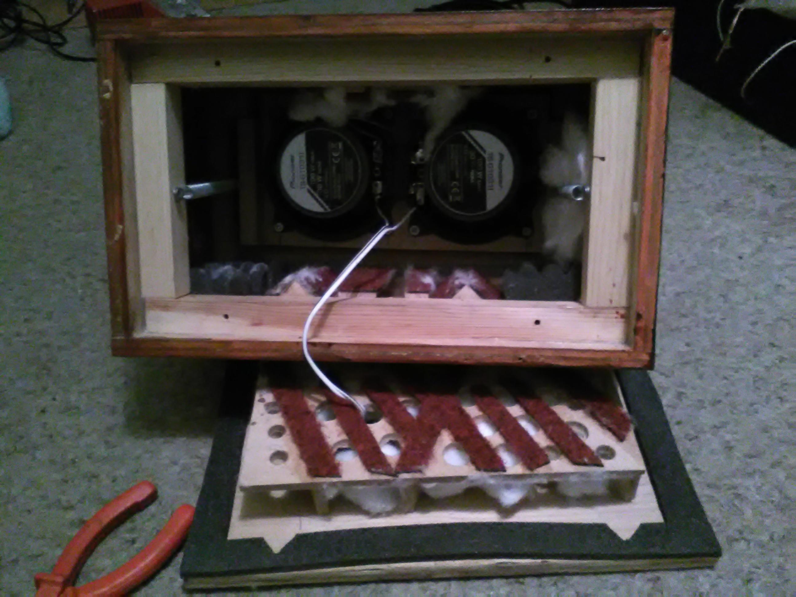

Thanks Tony, sorry I forgot to mention, I designed this so the back panel is removable
Is it now safe to glue the front?

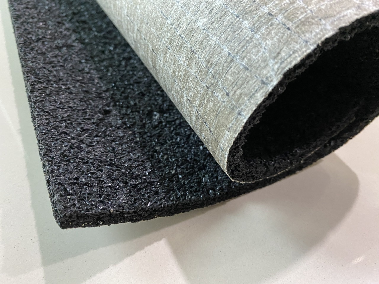

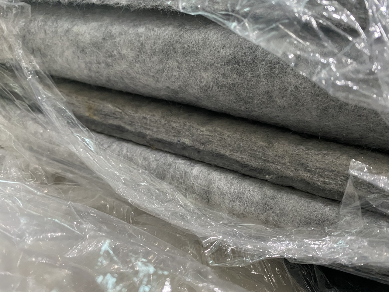

Regarding lining, I have the option to use either the rubbery carpet underlay (as attached) or standard 12mm wool carpet. Any pointer on which one is better? I can also double them up, or maybe in certain spots.
Thanks again for all your kind assistance
Ah in that case then yes. I routed my front baffles after they were glued on. As I had veneer I veneered right to the edge and then routed.
On the lining, experiment and see how it goes, that's what I did. Just make it tight fitting and sit it in there. I did nearfield measurements to see the effects. They are good for showing reflections through the speaker cone (and how well they have been suppressed).
I did nearfield measurement of bare box, then with different types of linings, some worked much better than others.

If the backs are removable, perhaps you could fit a diffuser ( just a bit of mdf with holes drilled in and perhaps covered with something like carpet tile, the red stuff in the above picture ) to the back. This can help reduce return reflections from the back panel and possibly stiffen it.
