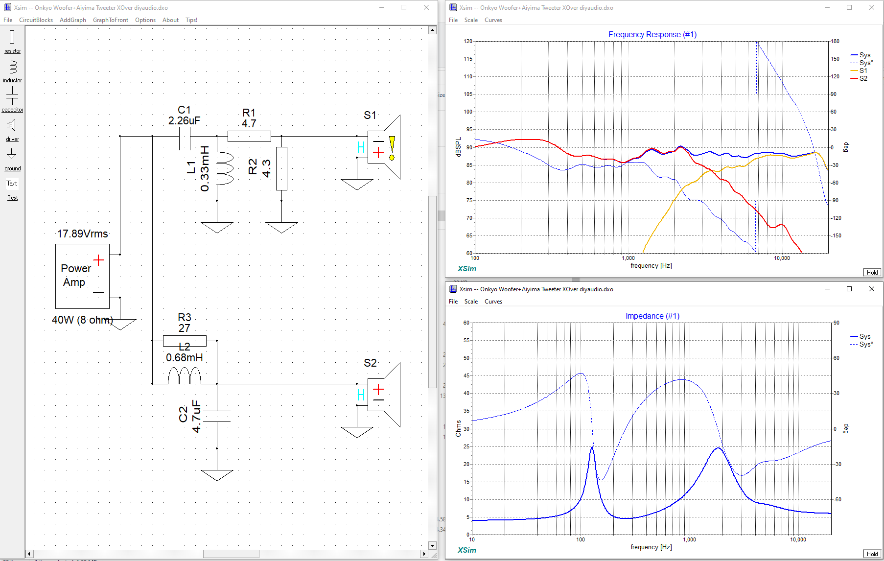

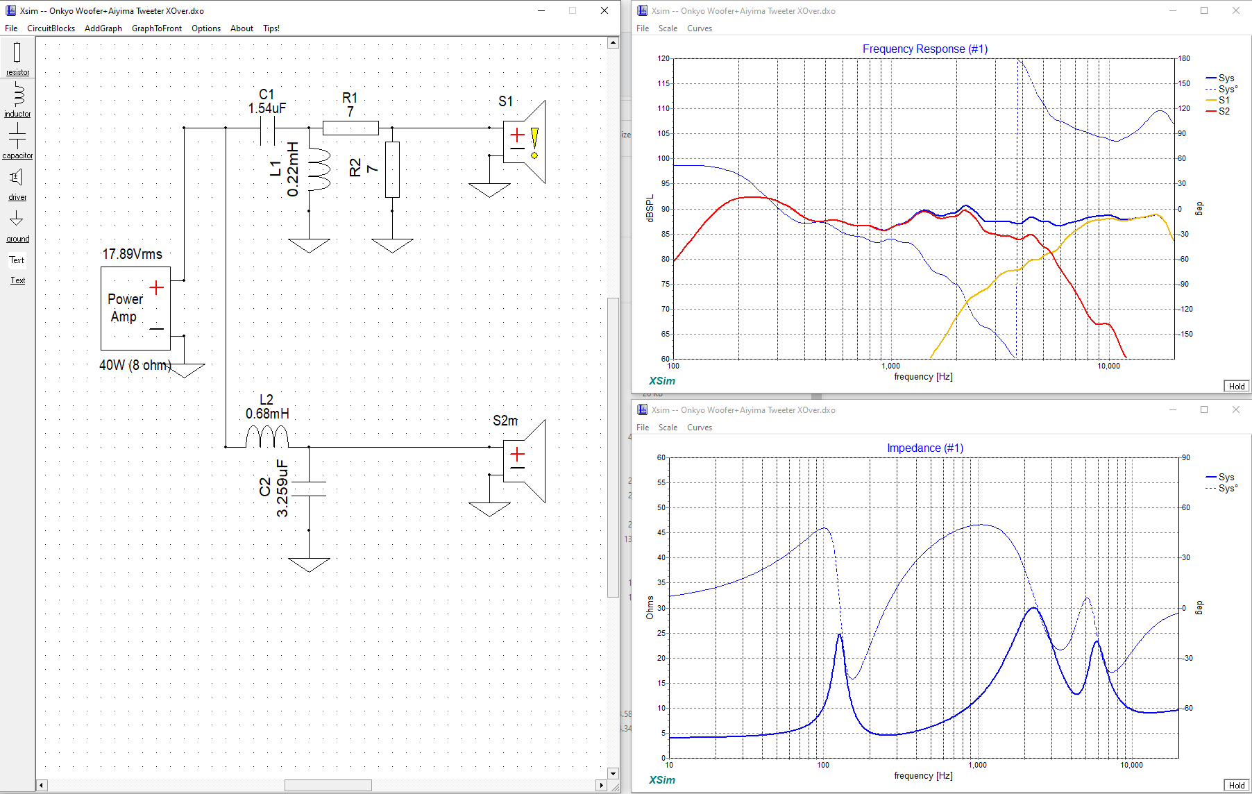

Dear Allen and Tony, thank you for your kind responses, which really made me think and revisit the design. I attached the old circuit and the new one with R3 added, as well as Ampere and Watt simulation for 40W (8Ohm) amp.

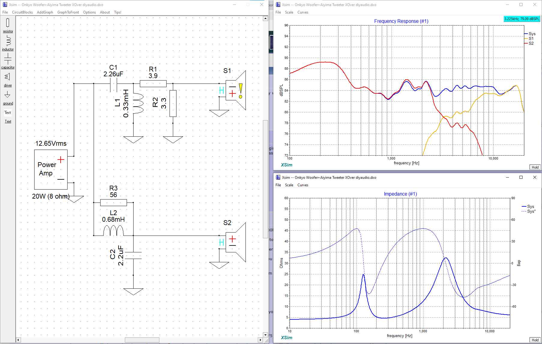

I re-imported the frd into XSim without adding delay to the woofer, but using "derived" option and checking the "show orig. phase" box. I also tried to tame the highs of the midrange to tilt downward, by adding a parallel resistor to the inductor. This managed to do that, at the same time flattened the frequency response around 2-3kHz and smoothed the impedance nicely
This brings the crossover frequency down to 3.2kHz from previously 5.4kHz.
AND..the graph shows "correct" response with the tweeter's polarity reversed, as is expected with 2nd order filters.
What do you think guys, am I on to something here?

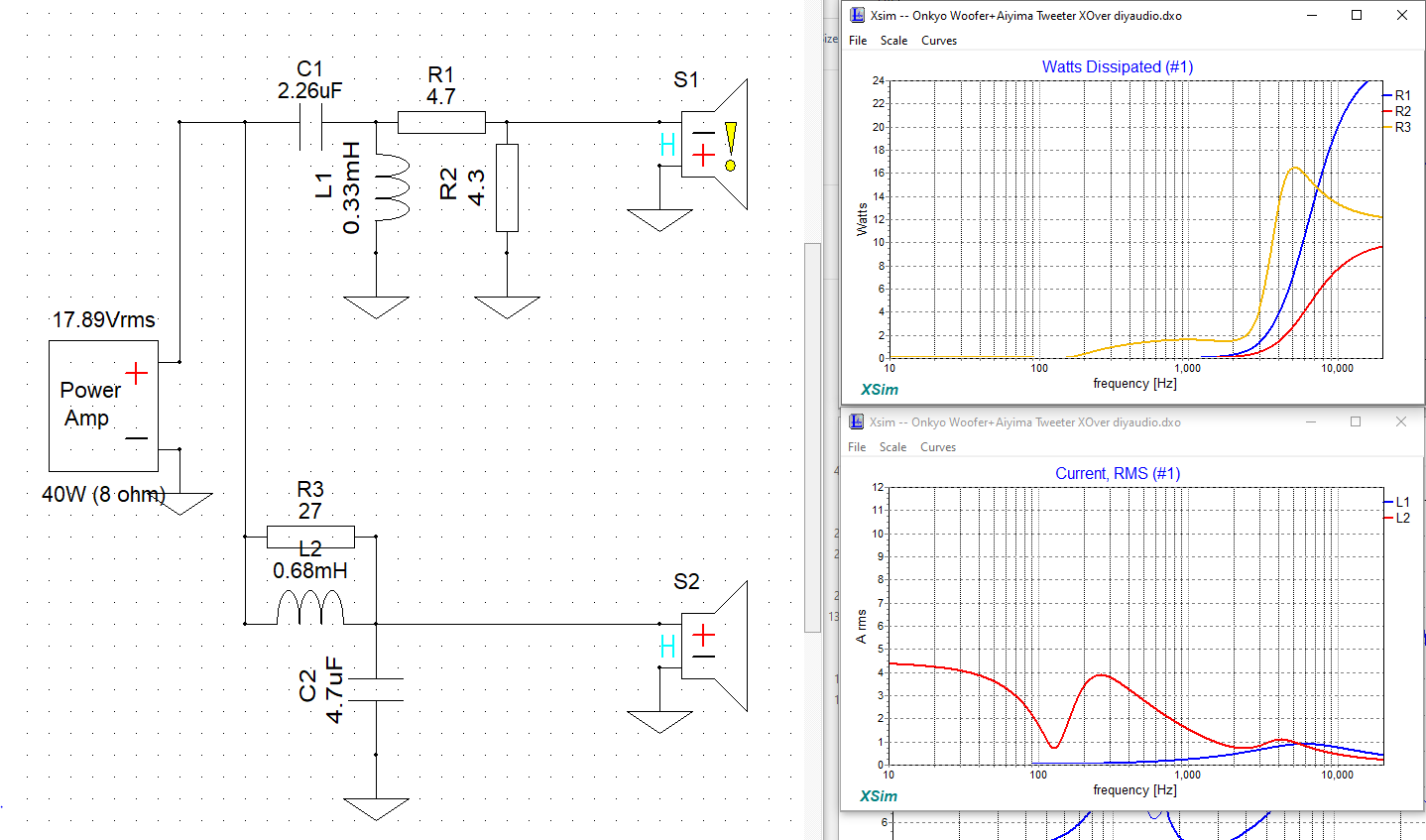

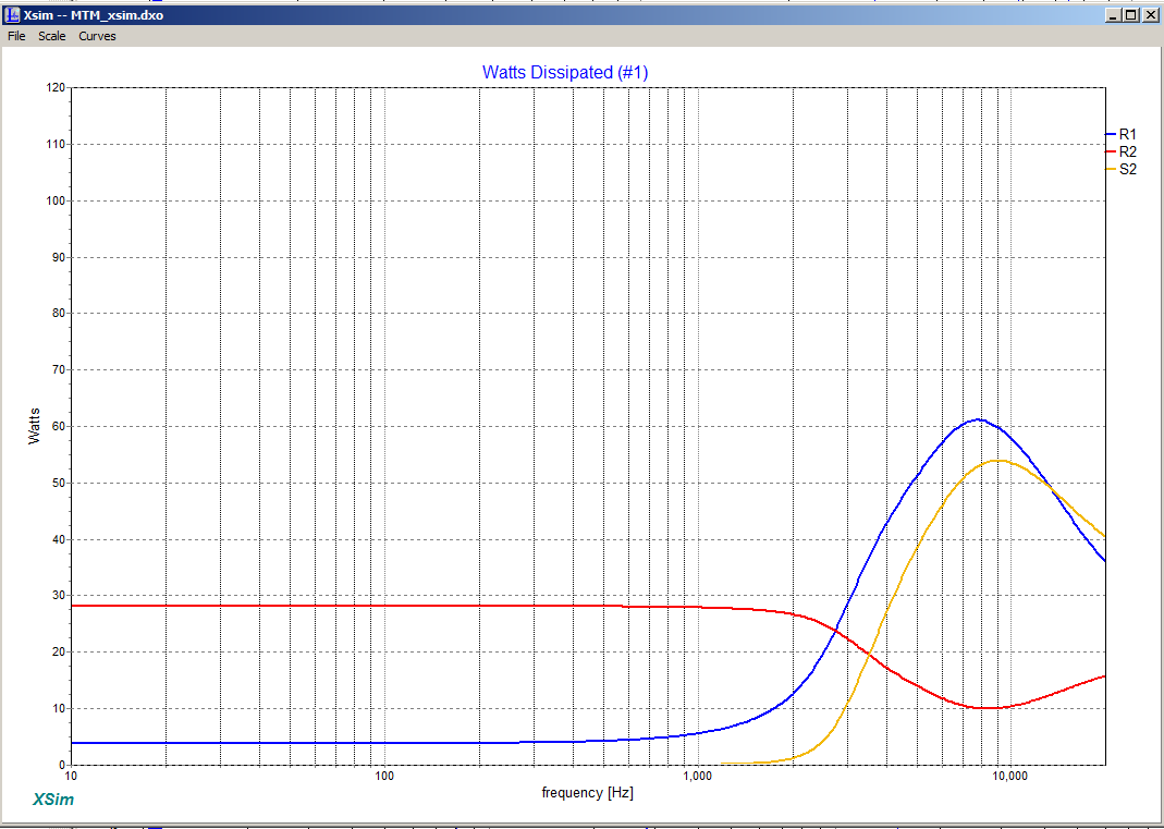

Another thing, I would really love to have the crossover inside the box, so component size is important to me. Kindly take a look at the power draw graph, do I really need to use 20W resistors for this, or can I get away with smaller ones? Thank you so much!!
On the question of resistor wattage, I assume you are talking mostly about R1. IMO no. The cap is limiting the dissipation to high frequency range, and it is highly unlikely you will have that kind of power in those frequency ranges. I think a 10W resistor would be fine. R3 I'm not so sure about.
BUT I would need to check whether xsim power calcs are based on peak or expected average power dissapation. I'm basing the above comments on the assumption it is peak...

A simulator should show full amplifier output per frequency. Of course this is completely un-realistic, but it is not Xsim's job to guess how you'll use the speaker

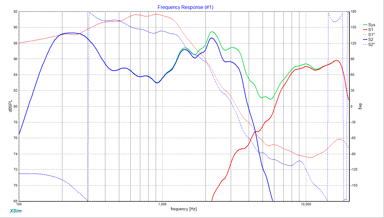

Jonathan, that woofer response is not easy to work with, do you think it is realistic? Most woofers would peak at their top end, which is higher than 2kHz for a 3" driver. I don't want to put too much on your plate at once, but I'm aware that you'll have a hard time trying to flatten that curve, and it would be a shame adding a bandstop filter to treat a phantom measured reflection.

OK I always like to verify with some real world experience. Below is a plot out of X-Sim as to what the power dissipation in the lpad on my tweeter would be at 100W input power (the speaker is being driver by a 100W amplifier).
Now note that this lpad I placed before the crossover, without thinking about the fact that, that meant it was actually working over the entire frequency range up to the crossover frequency, not just on what passes through the crosover, so the R2 shunt resistor (22 ohms) is passing for all of the bass as well, and just putting additional strain on the amp.
What was actually implemented were 12W resistors and even running at high volumes for an extended period of time they don't even get warm.
The other thing to think about is that most tweeters are rated at around 10 - 15W RMS (but tend to be rated with suitable crossover, often for around the 100W mark. the XSIM graph shows the tweeter running at around 55W which would cook most tweeters if not just a transient.

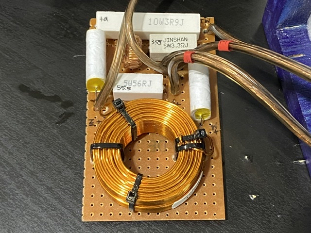

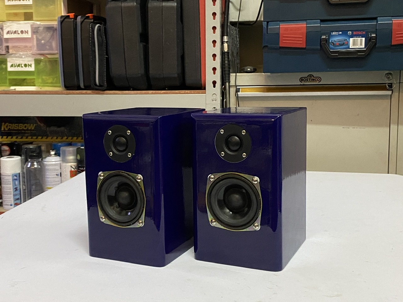

Hi Tony and Allen, thank you so very much for all your kind help. I’ve finished the project. I’ve decided to go ahead and built it, and actually have a listen. Boy am I happy I did. It sounds really good, considering the drivers, the size, and my limited knowledge on speaker building. I attach the final schematic as built, the final crossover layout, and the finished pair. I added 5 grams of dacron behind the midwoofer magnet.
Thank you again guys, this thread has been very very educational for me.

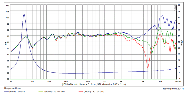

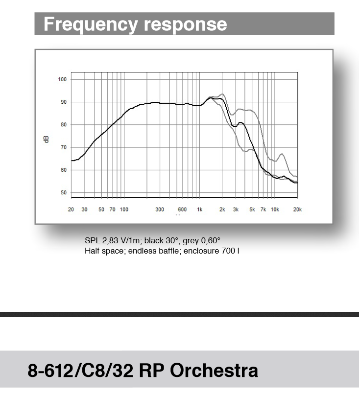

Are you sure that the frequency repsonse of the 8" Eton is what you posted? Looking at the datasheet it is quite different to your image link. When I saw the image I thought that can't be an 8" driver...
Attached is from the datasheet for the driver model you mentioned, note that the graphic you linked to had a different driver which appears to be a 4" Eton, which would explain why it didn't look like an 8".
I think you would have trouble mating this with a tweeter directly unless it is some sort of compession driver that can be crossover over very low.
The datasheet does say recommended freq range 40 - 2000Hz, but I'm sceptical You could have some baffle step related hump in the 1 - 2Khz range (depending on your baffle) and if combined with the existing response humpthat this driver exhibits (on infinite baffle) you will likely end up with problems.
