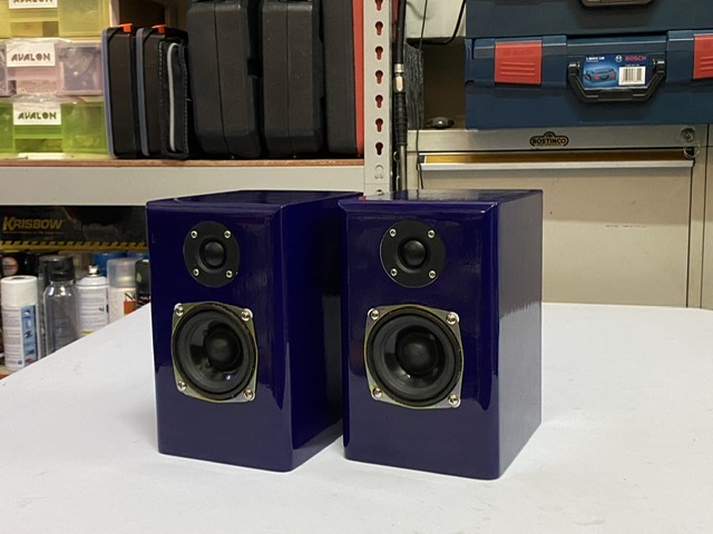

It’s starting to take shape..
Hope you guys are having a good time and staying healthy and safe..

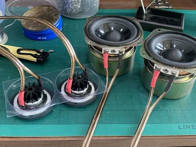

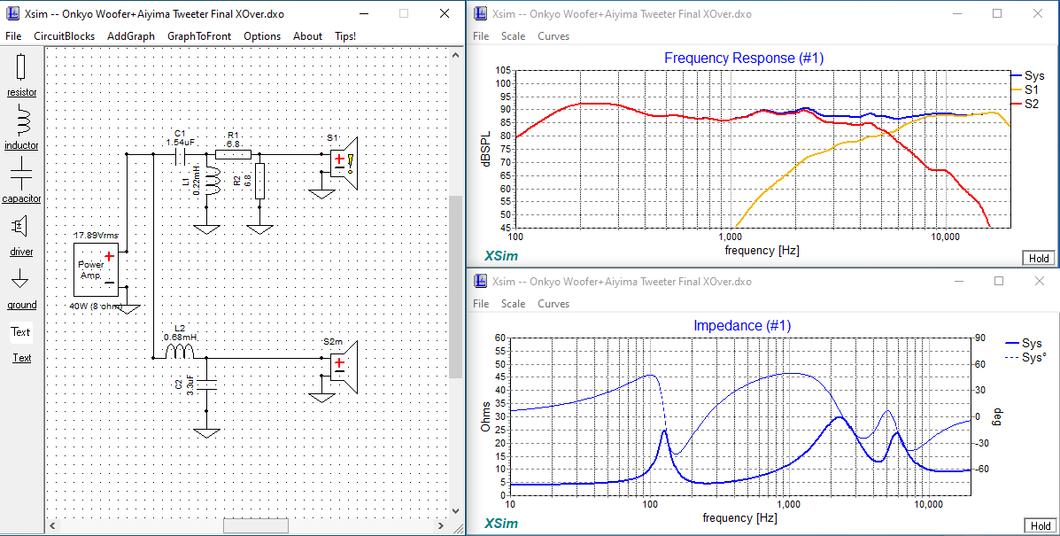

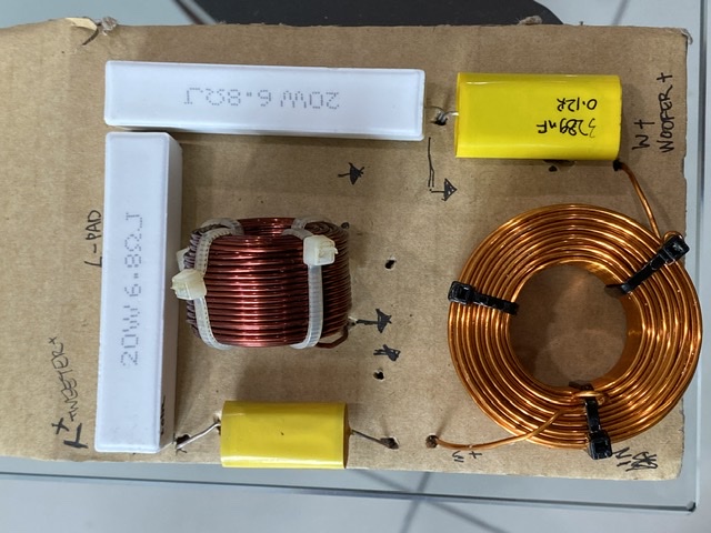

Hello Friends, sorry I’ve been missing, life happened, but now I am back on track with some progress. I had a bike paint shop did the paint job for the enclosure. It was beautiful, but it started to sink, due to the porous nature of plywood. It’s alright, adds to the character. 😉
Next, I’ve made measurements, factored in the offset (is it Z offset?) and measured at tweeter height. I designed a crossover in XSim and built it as attached. It is functioning well, it made music. It sounded just okay with the back of the box still open and no stuffing added. Happy I got this far.
Now if you would kindly share any comments or input on the crossover design, I’d be most grateful, especially since the crossover as it’s mocked up now does not fit inside the enclosure! 😕😕
- Are the inductors laid out correctly?
- Can I get away with let’s say 5W or 10W resistor for L-Pad? (I am simulating for 40W amp into 8 Ohm, since the midwoofers are 50W 4 Ohm)
- Should I look into ferrite core inductor to be put in series with the midwoofer?
Any input on crossover tuning and layout will be most appreciated. Thank you so much!

Hey Jonathan, it's been a while.
The last time I locked one of my own crossovers inside a box I regretted it. I can't remember whether you are using factory responses here but with some of these techniques, since they show you only some of what is happening, you may want to tweak them later if you begin to understand there is an issue.
Your crossover makes me wonder.. has your measurement considered the in cabinet response? Should the tweeter be crossed that high? Can you get the midrange response to tilt downward or level rather than rise again?
You seem to be able to handle Xsim. If in doubt you could post your *.dxo file here.
Hi Allen, been a while. 🙂 How are you, I hope you and yours are well.
Since the woofer is a relatively undocumented driver, I've taken the T/S parameters and impedance measurements myself. The tweeter is the same story, too bad I didn't take the T/S parameters and impedance (not sure how to add weight to the silk dome tweeter).
I installed them in the box, in the final position, raised them 1.2m above ground with more than 1.2m clearance in all direction. Mic was 1m away at tweeter height. The box was closed with the back in position, woofer and tweeter leads out through the rear port. I took some sweeps from 200Hz upwards, to protect the tweeter, and it is my understanding that my room and measurement rig don't support accurate measurement below that frequency.
I took the tweeter frequency sweep, then the woofer, then both in parallel. I used the parallel to find the acoustic center*. Woofer is at 0.64inch delay in relations to the tweeter. I settled on this current design after trying different combination, it seems reasonably flat, and if polarity is reversed, there is a nice dip right around the crossover frequency. I've read that it's a good indication of well-summing drivers at crossover point? I've taken great care to have the polarity correctly throughout these measurements, and I've read conventional wisdom says for 2nd order filter I must reverse one of the drivers. However with mine it doesn't seem to be the case. Regardless, I will measure carefully in the production stage, to make sure whether I have a nice summation or a dip, and then I will reverse my tweeter accordingly. Please feel free to confirm or correct me in any of these points 😀😀
I'd really love to have your input on my design, I attach my dxo zipped. Thanks Allen for being generous with your time and expertise. 🙂🙂
I welcome anyone who wants to play around and expose my noob-ness, please have a go at my dxo. Thank you guys!

Yes, we're great thanks. My son is getting into blogging and is currently learning about microphones.
I like how much you've been learning. It's a steep learning curve. Firstly I'd say that you don't need T/S for the tweeter, just impedance and appropriate response measurements.
Indeed you can't do lower frequency measurements the normal way in a room. However even for higher frequencies it is best to 'gate' them, after putting them away from nearby surfaces.
You shouldn't need to find acoustic centres unless you cannot get proper timed measurements. This piece of knowledge is not so well known it would seem.
I'd say similar about finding a null. Not necessary if you have a simulator that shows phase. Besides, it only shows you whether the drivers are in phase, not how well they sum as part of the system.
How's that for a start 🙂
Very important point that Allen makes above. The various simulation programs that allow you to put in driver offsets, only need you to do this if you are using minimum phase frd files. These have no offset information built into them.
If the measurements you have done have the relative phase built in, then you actually need to make sure the sim software has NO offsets entered.
Also I believe with Xsim, when importing the frd, there are different options, one of which extracts I think the minimum phase.
The methods I have used are to take all measurements on the tweeter axis. If using holmimpulse after doing the tweeter measurement, finding time zero, and then locking it, so that all other measurements are relative to that.
In REW same thing, take all measurements on tweeter axis and then use dual channel method to ensure phase is correctly captured. You can also do this with a reference signal if you have a USB mic (not something I have tried).
If you prefer to do the offsets, then you can measure each driver on it's own axis, extract the minimum phase, and enter all of the offset information into the sim.
Both I think have their pros and cons. I like the simplicity of having the phase incorporated into the measurements themselves 🙂

I began to look at the sim, and then what I wrote.. hoping to prioritise it better.
What stood out to me at first was the unusual response of the woofer. I think what would be helpful here is datasheets for both drivers. This is partly for comparison purposes, and partly for determining reasonable crossover points.
