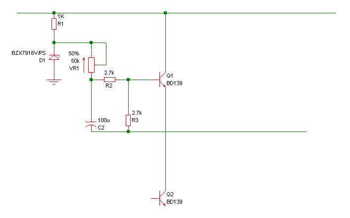

An extra resistor should solve it. See the attachment. 1K right after the input cap.
Yup. Zeners. Only one per channel. An 18V zener would be best.
Steps:- 1K resistor from positive rail to zener negative lead. Zener positive lead goes to ground. Disconnect VR from positive rail and connect the pin to zener negative lead. Done. 🙂

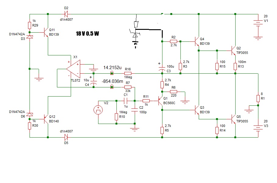

2)The bias current fluctuates between 1.5 amp to 1.8 amp.Input V is 22 V to 23 V
Hi, Shaan is there anyway of stabilising these?

Thanks for the reply. See the attached drawing.
Is this the correct wiring ? I was thinking of retaining the VR in the circuit and regulated the V in the + and _ power supply rail before the amp. In this way you can still adjust the Iq
Is this the correct wiring ? I was thinking of retaining the VR in the circuit and regulated the V in the + and _ power supply rail before the amp. In this way you can still adjust the Iq.
The VR is essential part of the circuit. What I meant in my last post is to disconnect only the VR pin that goes to + rail; not the whole VR from the board. See the attachment.

I add the zener described in post 103 and Iq is much more stable --between 1.7 to 1.8 amp depending on ambient temp.
There is added benefit as the output transistor temp is more predictable --between 50 to 55 deg c in non air con room with ambient temp of about 30 deg c.
One channel when into oscillation last night and thanks for the speaker protection unit 🙁
After trouble shooting for 2 hours notice a poorly soldered resistor .

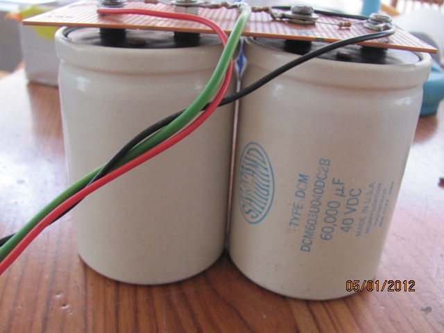

Additional cap in th epower supply
I recently added this in the power supply and is a very obvious improvement.
I have 6 Rubycon 10 000 Uf prior to the addition.
The hum through the speakers is much reduced.
The greatest impact is in the bass and dynamic.
Bass sound effortless and in cello bass, one can appreciate the timing of the fingers leaving the strings as it is being plucked .

Kp,
did you go from 60mF to 180mF?
Please clarify.
Hi Andrew,
This is correct.
The caps are shared by both channels.
My transformer is 18, 0 V ac and 18 0 V dc . about 450 Va. This is housed separately .
thanks
kp93300
Your numbers make sense.
+-20mF for 8ohms speaker load.
+-40mF for 4ohms speaker load.
A pair of channels feeding 8ohms speakers is an effective 4ohms load as far as the PSU is concerned.
That implies 80mF for a stereo 8+8ohms speaker
and 160mF for a stereo 4+4ohms speaker.

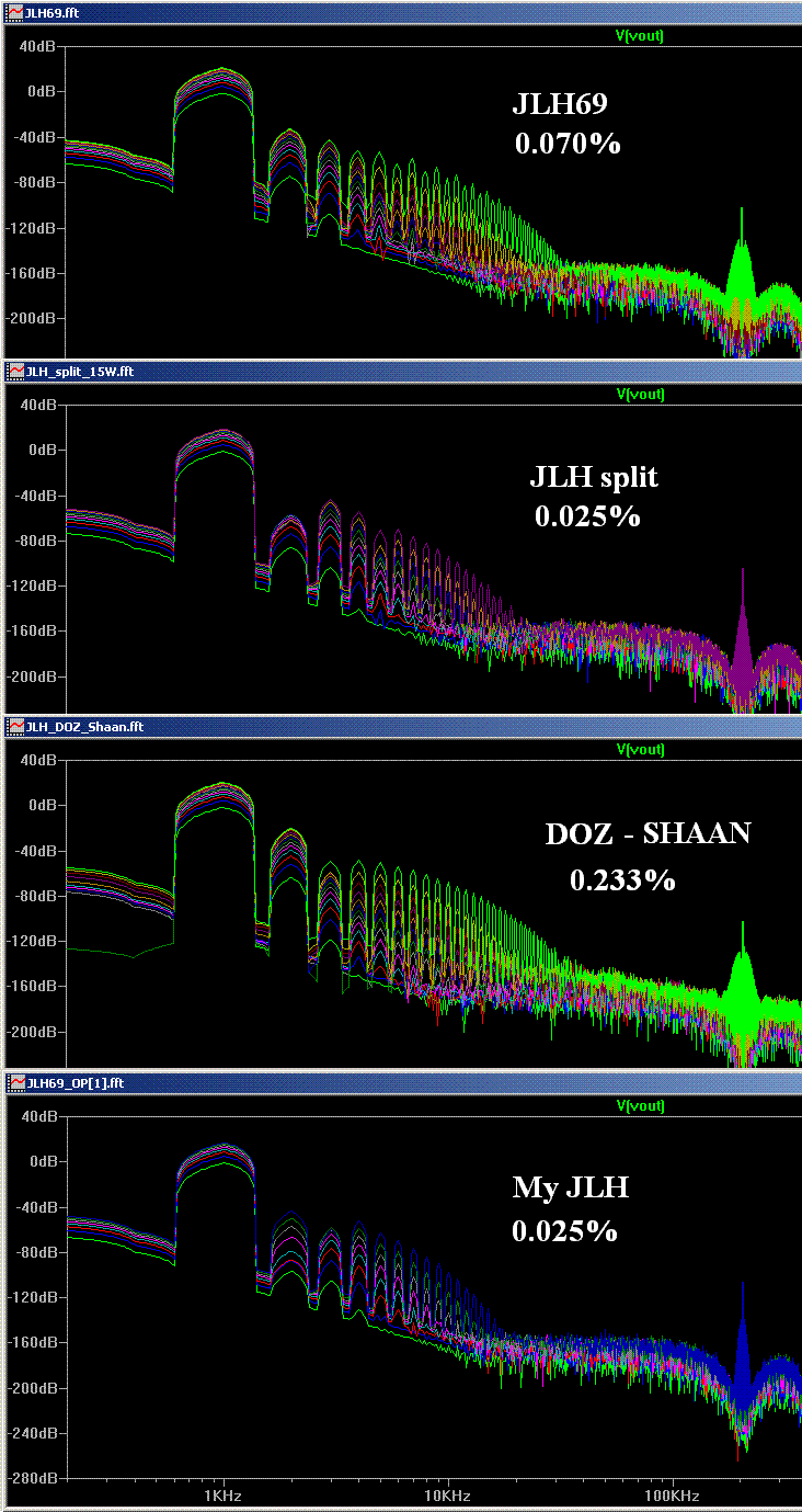

Just simulated a few JLH variations along with mine. I want to make some comparisons regarding these amps from THD point of few... Of course, there are many things that affect the sound of an amp, but some are too subjective so I decided to look only from THD alone.
Three amps are compared: JLH1969, split supply JLH, DOZ-Shaan and my split JLH variation.
All transistors are as specified on own schematic, except for output all use 2N3055 (LTSpice model).
From 4 amplifiers, DOZ-Shaan has some overshoot (pulse test). Mine also the same, only very slightly better.
The objective of my JLH is to remove the capacitors (hence opamp servo as DOZ_Shaan); maintain simplicity, i.e. no constant current source (as close as possible to copy the idea of the original JLH69); achieve THD low enough without destroying the "good" monotonic spectrum; can be used with very low bias current without damaging THD (I want to use my small heatsinks). The rail voltage is 2x22V to use the Salas' shunt regulator.
Here is the rough simulated THD from the 4 amplifiers:
JLH69 NUDOZ Split JLH15W MyJLH
Rail 36V 2x20V 2x20V 2x22V
THD1 0.070 0.233 0.025 0.013
THD10 1.066 1.072 1.045 1.053
THD20 2.206 1.650 1.739 2.206
Bias (A) 1.4 2.1 1.1 <1
From first glance it seems that the NUDOZ has the highest distortion. Actually it is the 2nd order distortion. If the 2nd order distortion is neglected, actually NUDOZ has the lowest distortion. Now the overexposed 2nd order distortion in the NUDOZ will make the amp subjectively very pleasant sounding.
That's it, comparison based on THD alone.
I found that too in the simulator. But ignored it as nuDOZ isn't a perfect amplifier. I found the clipping performance to be superb. M0UKD's video justifies this. You can see a shot in my avatar. 😉
Exactly what is expected from an amplifier of DOZ's kind. For SE lovers this info will be very useful.

Yesterday, the plastic fuse holder for the +ve rail of the power supply to the DOZ broke and the speaker protection module is activated.
The power supply filtering caps is damaged
I replace the wire and caps and is back on duty.
I am surprised that the transistors did not get damaged !
Still discovering new information on the disc things with the amp
cheers
kp93300
Hi
I want to change the output transistor from TP3055 to 2sc5200.
Is this a drop in replacement for this circuit ??
any change in the circuit necessary to prevent oscillation ?
thanks
kp93300
thanks
kp93300
Hi
Unfortunately, no. 5200 is a very fast bjt whereas 3055 is much slower.
thanks
kp93300
Zobel network of 10ohm+100nf in series from output to ground is a must.
5200 has two problems with doz.
1- prone to oscillation without compensation.
2- Severe Iq instability resulting in overheating.
Being a high gain bjt it keeps passing more current as it heats up. DOZ is a current feedback amp and makes the best out of 3055 which is the ideal choice. 5200 won't probably be any better soundwise.
