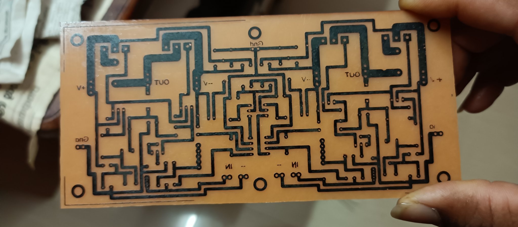

I'm going to jump on the old thread chain. I have a troubleshooting question. Fyi, using the schematic from rods site. I am able to get bias set at 1.7a off a 24v power supply. However at the output it says to set v1 to half of input. But mine seems to max out at 3.1vdc. What am I missing?
I dont have the 2200/4700uf capacitor and 1k resistor in place at the output. Would that make the difference?

I built both Capacitor coupled and Direct coupled versions; both with their advantages and disadvantages. The cap coupled version has less demand on the PS filtering and is less complex, while the direct coupled version has more stable bias and subjectively cleaner sound with no capacitor in the output and the feedback path.

This is the exact schematic I used in the direct coupled version, everything except the power transistors are on-board. The diode-bridge+zener+bjt regulator for the opamp was a first time for me and it works well with no bad effect on the turn on/turn off event; i.e. no thump/click/pop etc..
