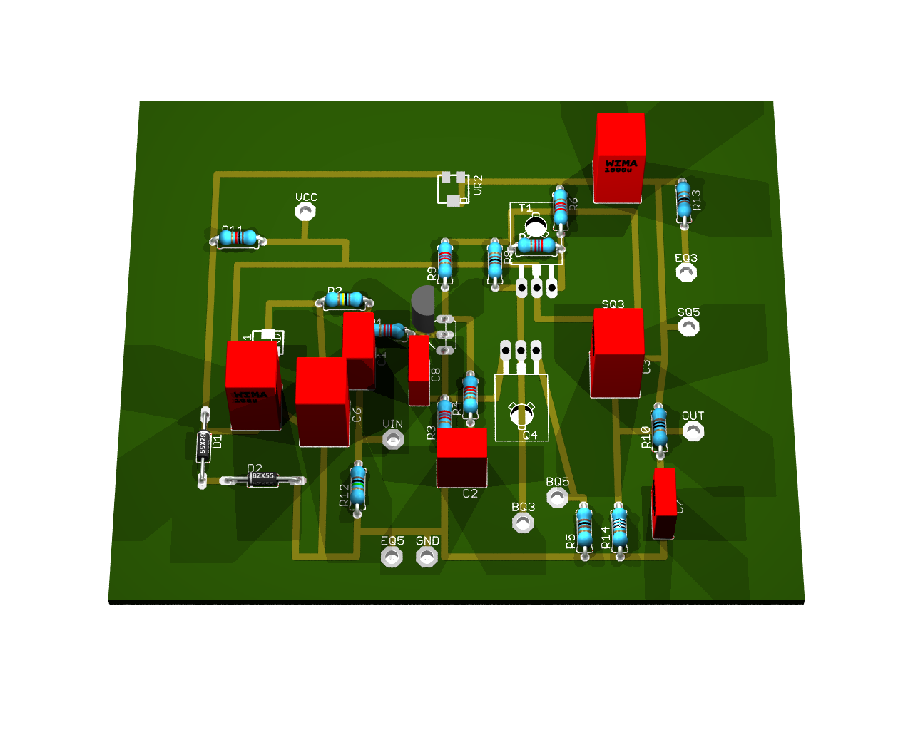

This is my pcb:
Notes
Any comments on the pcb or the options I've made would be really appreciated!
Thank you a lot!

Notes
- I'm using the same schematics from the project's website.
- I'm using a 4700uF as output decoupling cap.
- The blue boxes are the pcb fixing points.
- The BD139's will have an aprox. 3x3cm heatsink
- The output stage will use 2n3055's because them are the only available ones I can find with my local supplier from the options you discused earlier.
- I'm planning to get a new 22v@150VA power transformer with 2x10mF caps and a 10mHy choke. Should I still use the 12v+12v zeners or should I lower the voltage to something like 18-20v?
- I'm using 0,4mm copper wires. It's that OK?
Thank you a lot!
(I'm attaching a picture + the eagle files, I hope they are useful to someone coming next!)
I don't think this layout will work well. Many of the capacitor shapes you've chosen are too small for the values shown. Have you measured the dimensions of the actual components you will use, to see if they will fit?
PCB tracks could be much wider, and should be in all the places where large currents may flow. Also consider curvier tracks, but that's not as important here.
Do you plan to use SMD trimmers? You don't need to, and it will probably be easier to assemble if you don't.
Are the BD139s going to be bolted thru their heatsinks to the board? If so, you must make room for the heatsinks and move the tracks out of the path of the mounting holes. Even if they are to be mounted vertically, you still need to decide what style of heatsink you will use, and make sure the component layout can accommodate them.
Have you drawn all the tracks on the top side only? Eagle defaults with red for topside tracks and blue for bottom side tracks. If you're going to etch the board yourself, I recommend doing all the tracks on the bottom side.

I'm going to etch it myself so top and bottom layers will become the same layer. I used blue for planes for a friendlier layout on Eagle.
The size of the caps was taken into consideration, now it's displayed correctly.
Now the output stage uses a 1mm line and the ones carrying a large current now are double-sized.
The trimmers shape is quite dependant on the supplier and will be adjusted when I have all the components.
The BD's will have a heatsink like the one on the picture. It's quite light so I was planning to solder them vertically with the heatsink bolted to the transistors.
A ground plane like the one shown should dismiss the effects of ground loops right? Or should the 3 rightmost ( Death of Zen - A new Class-A power amp ) ground be connected on a different plane?

Hi agus.
Nice layout.
Some thoughts:
1. Use 20k for VR1.
2. C8 goes from base of input bjt to ground.
3. Place the VCC header so that it meets the 3055's collecter and then the BD. Or, separate tracks for each stage.
4. If your PS output is 40V or more, use 15V zeners.

Hi AgusR,
When using Eagle always run Tools > ERC and DRC and fix the errors.
I would suggest you change the lead spacing of your resistors. 7 mm is very tight for standard resistors. I would recommend 10 mm as a minimum, you have plenty of space.
Why are you using surface mount for the pots?
Double check the size and efficiency of your heat sinks, my DoZ ran very hot.
BTW: Most of us at DIYAudio would encourage you to just buy the PCBs from ESP.

I believe this will be the final version of the pcb.
I reconnected the C8 cap to ground (instead of to Q1's collector as on the schematic).
I read on another topic that in order to reduce noise, signal's ground should be connected using a different wire to a star ground on the power source. So I decided to split the ground from Vin, C6, C2, R12 to a different from the main one.
The VCC pin was moved so it would be closer to Q3's collector.
(Note: I am designing the pcb myself instead of buying it directly from Westhost due to the extremely long process of importing something to my country. Books buyed from amazon take at least 2 to 3 months to arrive.. (technically they arrive in 1 month and are retained for quite a few more on customs office..))

Today's afternoon I'm planning to finish soldering the amp for a test.
I did found something odd on the LtSpice simulations. One of the output transistor dissipates 2-3 times more power than the other one. In particular, the one that dissipates more power is the 2n3055 with the emiter resistor. Did I screw something with LtSpice schematic or it really works this way?
Did you set the voltage at the collector of the lower power transistor with the 100k trimmer at the input? If trimmer isn't available in sim then connect two 50k resistors in series, from +ve to ground. And connect the 100k at the base of the input transistor to the middle junction of the resistors. Then you can control the voltage at output by varying any of the series connected resistors.
