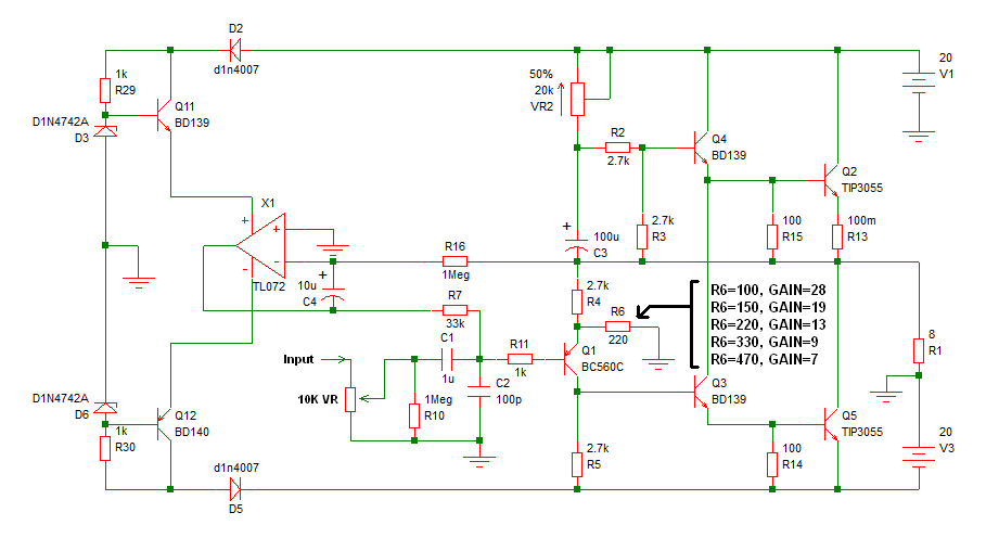

See the attachment, it shows how you can connect the 10K(or 100K) volume pot to the DOZ and a table where you can determine the gain of the circuit with varying value of R6. Remember, a gain more than 28 or less than 7 may either introduce high distortion due to low feedback factor or damage the circuit due to oscillation, and should not be implemented without the assistance of an oscilloscope.
Hope this helps.
p.s. The default gain is 13.

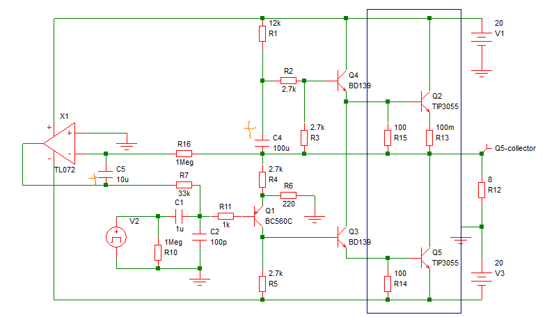

Hi Shaan
From the feedback, I think there a problem of power dissipation for the TIP 3055.
See the attached picture.
Is this a correct way to parallel the TIP 3055?
Or
can i just wire the additional TIP 3055 in parallel with the existing base, collector and emitter pins of the TIP 3055 ?

No.
you cannot wire in parallel BJTs where some are without emitter resistors.
You need to modify the circuit to insert the emitter resistors. Optimise the new circuit to get it working properly and then you can parallel the output devices.

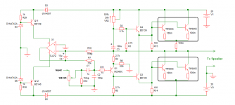

See the attachment, this is how you can connect two 3055s in parallel. You do not need to modify Anything in the circuit board. Connect one 0.1ohm resistor to each emitter of every 3055s and join the bases and collectors as shown inside the black rectangles. You can do all the wiring on the 3055s mounted on the heatsink.
All the best.

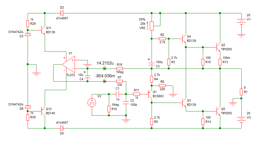

Hi guys,
I'm rekindling my interest in Class A amplifiers and this DOZ project with offset servo and a nice PCB layout courtesy of Shaan makes me want to do this again. 5 years ago, I tried the single supply JLH powered by an open frame 27V 7A supply. It sounded nice although I worried that the loud thumping sound when you turn it on might eventually damage the speakers over time. So to the basement it went.
I would love to implement the DC coupled DOZ. I do have a few questions so would really appreciate your comments and suggestions.
1. I already have two fix 27V/7A power supplies so that takes care of the split supply. Will the values of the components, specially the resistors have to be adjusted since the current supplies are at +/-20V?
2. What causes the power on thump/pop sound on the speakers?
3. In our country, finding the component Zener diode might be more difficult than say a fix regulator. If I use a 7812/7912 or LM317/337 regulators for the op-amp, does this have any effect/s on sound quality?
Thanks in advance.

Ans 1:
If your power supply is +27V(single supply) then nothing needs to be changed, but you cann't use the direct coupled version. If it's +-27V(dual supply) supplies then you can use the direct coupled version and only the input BJT and the 20K VR need to be changed because BC559/560 has too low VCE and 20K would make too much current to flow.
2SA970BL is a great replacement fot the BJT and you may need 50K or higher value for the VR.
Ans 2:
In a direct coupled amplifier the thump is caused by assymetric turn-on of the upper and lower part of the circuit. As the output rail needs a little time to settle at near 0V, one of the power transistors turn on before the other or conduct more than the other and the difference voltage is presented to the speaker. This can be totally eliminated using modern design practices and is fairly easy.
In a capacitor coupled amplifier it can be caused by the same reason as above, plus the charging of the feedback and output capacitor. This charging is inevitable and people often use time-delayed relay systems to protect their drivers.
In the direct coupled DOZ both caps were eliminated, and the servo was designed to turn on as fast as possible; as a result, no thump.
Ans 3:
You can use the regulator ICs for the opamp without any problem. This has no effect on the sound quality.

wponline,
You can use a BC560C (45V VCEO) transistor as the input BJT in a +-27V circuit, as the voltage around the BJT will hardly cross +30V even during clipping. Well within safe zone. See the differential voltage during clip(PS at +-27V) waveform in the attachment.
A couple more volts than one supply rail.
560 could be used at up to +-40Vdc.
556 <=+-55Vdc.
You can add diodes across the bases of the LTP and/or Zeners from signal to return for further protection.

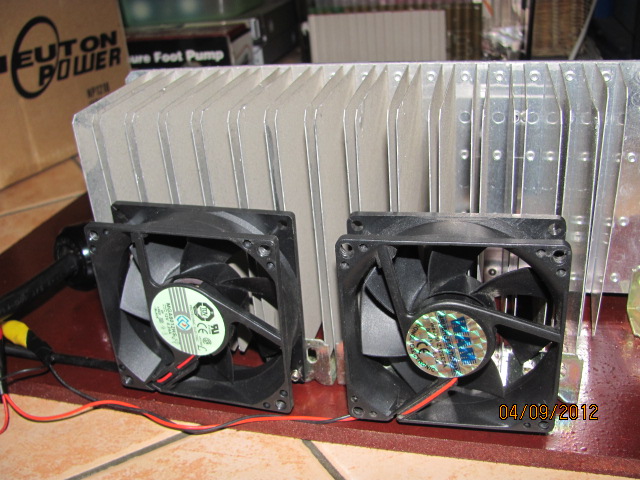

twin fan
I followed Shaanś suggestion about fan to increase efficiency of the heatsink and read up the article in ESP.
I tried different size fan operated at different V. This is my implementation and after about 1/2 hr, the temp at the TIP 3055 is about 55 deg c with a bias of 1.75 amp.
The fan are retrieved from old pc power supply and run at 6 V in the implementation..
I hope this is the final hurdle to enjoying DOZ 😀
regards and thanks to all .

Just one last small thing... turn the fans so that they push air towards the heatsink. This will cool the heatsinks much more efficiently and will also prevent dust buildup during long term operation.

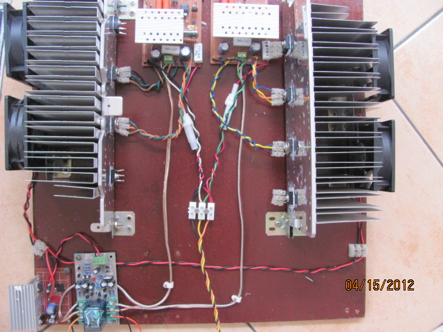

HI
I made a little more progress by installing a speaker protection module and a LM 317 reg for the 4 fans and is listening to it now via test speaker.
There is negligible hum despite the poor wiring. It has the sound characteristics of JLH 69 . Very promising and will do a formal comparison later when it is moved to my main step up.
I noted 2 minor problems :
1) I notice that it is very sensitive to switches of power supply in other parts of the house. There is a rather obvious thump audible through the speaker.
2)The bias current fluctuates between 1.5 amp to 1.8 amp.Input V is 22 V to 23 V
Hi, Shaan is there anyway of stabilising these?
I post a photo but excuse me for the very basic build. I have turn the fan to blow air towards the heatsink and temp at the output transistor is less than 55 deg C.
thanks to all for the guidance
I am very happy as this is my first successful amp build point to point and is probably cheapest amp to build.!
ad 1) wiring, shielding, grounding (of all audio chain components). Do you have an input RC filter
ad 2) if it fluctuates up and down and back, most likely you might experience high frequency oscillations. Check with an oscilloscope.

The article in Rod site use zener to stabilized the Iq. Can this be done here?
PMA , I have attached the schematic that i use below.

Hi PMA,Hi 93300,
as input RC filter, I meant the filter at the signal input, something like 1 kohm + 330pF. It prevents HFI and RFI frequencies to dynamically overload input and also prevents rectification on p-n junction of the input bipolar transistor.
I follow the schematic posted by Shaan earlier in the thread and there is a 1K in series with the base of BC 557B and a 100p cap to ground
I investigate further and noted that it may be related to the fluctuating power V that varies from +/- 22 to 23.5 V.
