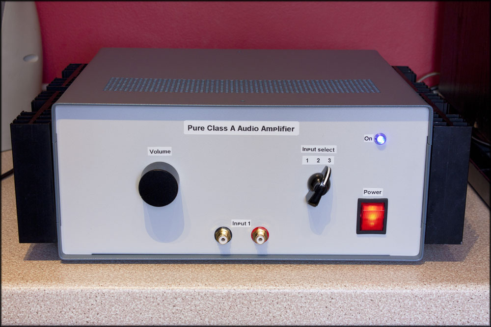

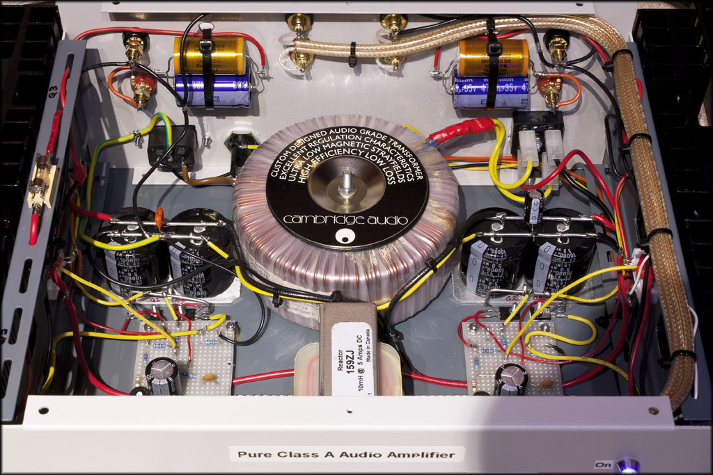

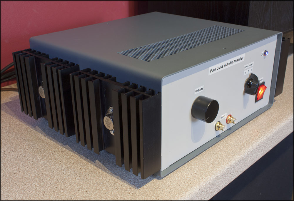

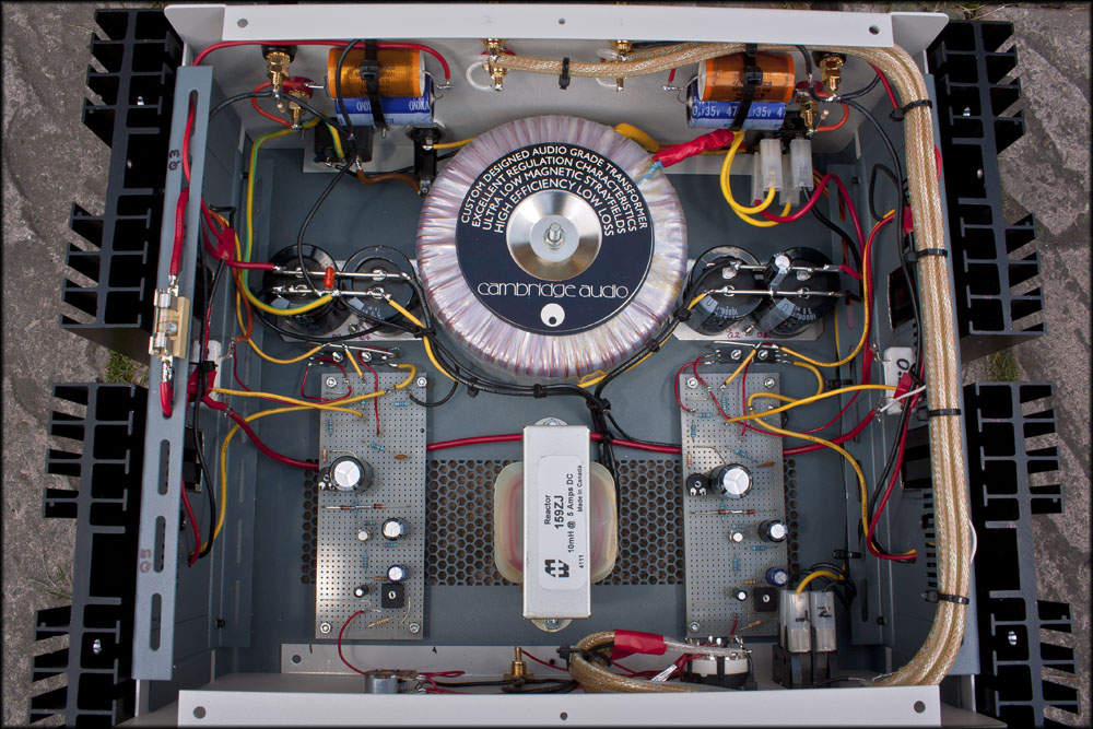

Hi. Yes, I took a video, but forgot to post it here. I'm not one to go into tremendous detail. Like a fine wine, it just 'tastes nice'. I can't tell you about the fruity flavours or what food it goes well with 😀
Here is a video tour of it: Class A Death of Zen (DoZ) - YouTube
I know you are building a slightly different circuit, but I found the idle current fiddly to set. It could probably be designed better on the schematic. Still once its set, it seems to be ok, so i'll probably leave it now.
I am very pleased with it, it sounds great, frequency response is good, its amazing how loud 10w is! It will be permanently replacing my Pioneer A-676 integrated amp which will be going on a well known auction site to help pay for the DoZ parts!
Cheers all 😉
Beautiful DIY job! Congrats M0UKD! You've built a great Class-A amplifier. You've found "the" sound, where just 10W of it can drop jaws! I'm damn jelly... the finished cabinet looks super-cool!

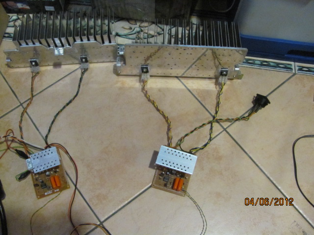

heat torture
Hi
Picture of both channel under heat torture !

Hi Shaan,
I thought TIP 3055 has a maximum operating Temp of 150 deg C .
I have run both channels continuously fro about 5 hrs without failure.
The heatsink temp is about 55 C and temp at the TIP 3055 is about 70 deg .

Pd = Pmax * [Tmax - Tc] / [Tmax - T25]
using Pmax = 120W
Tmax = 150°C
Tc = Ts + 15Cdegrees = 70+15 = 85°C
The maximum power of the 3055 with a 70°C heatsink interface temperature is de-rated to ~ 120 ~ 65 / 125 = 62W.
Running the hottest part of the heatsink @ ~70°C effectively reduces your 3055 to a 62W device. Then you must de-rate for second breakdown at all the higher Vce imposed on the 3055.
