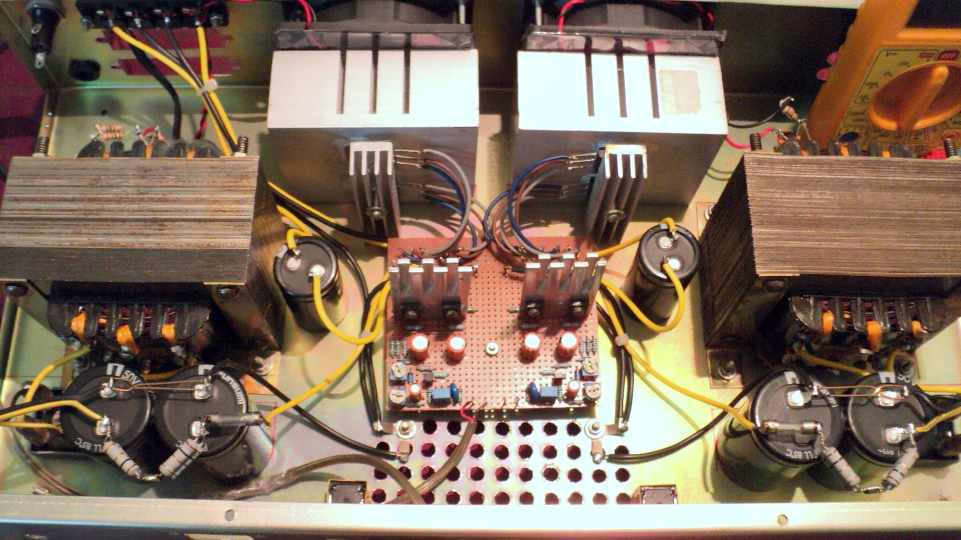

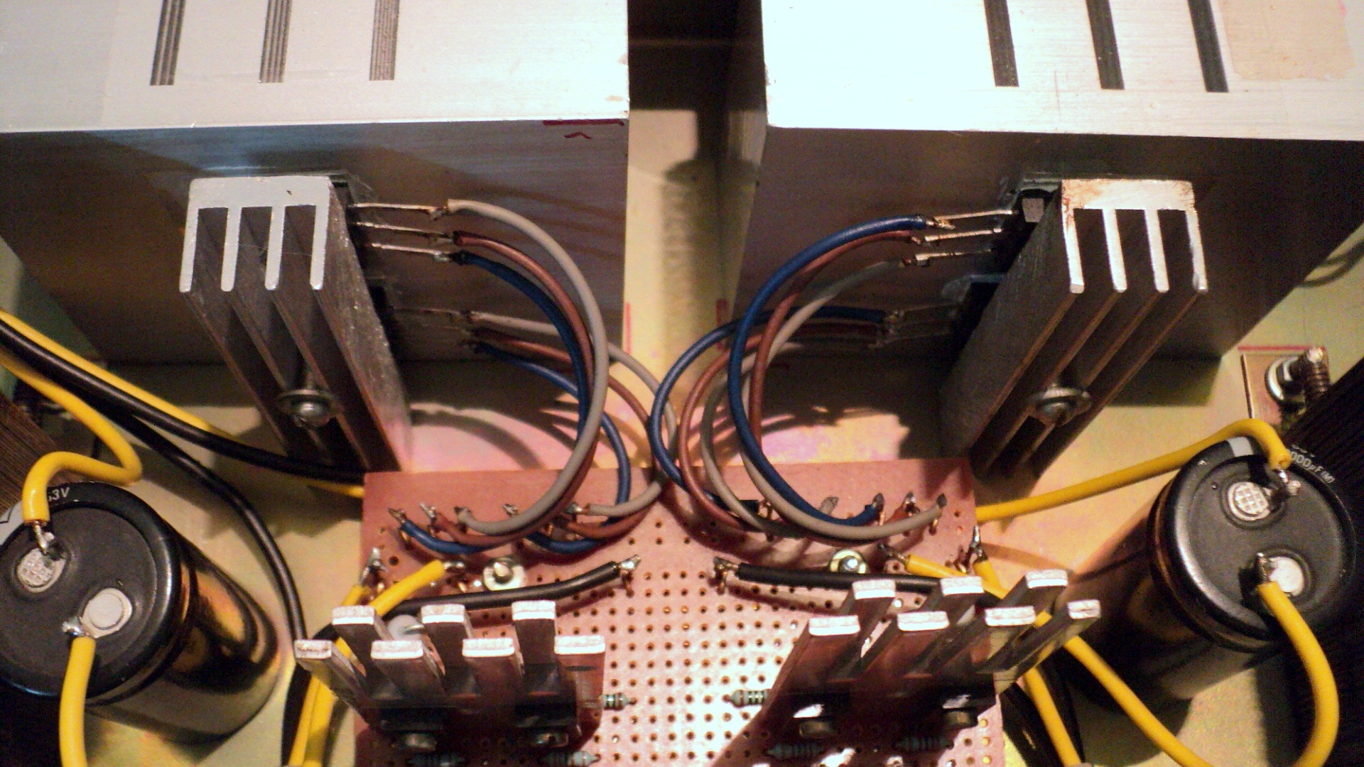

Hi all I have built the class A doz,and can confirm that it has that JLH full,rounded class A sound. The bass seems punchier and dynamic. Here are some pcb/overlay traces if anyone is interested.Good luck🙂
DOZ
Hi kp,the VA the transformer is about 120va and when rectified gives 32v dc.The heatsinks are 4 individual 5" by 4" for each output transistor. I assume your going to use the pcb layout? good luck.

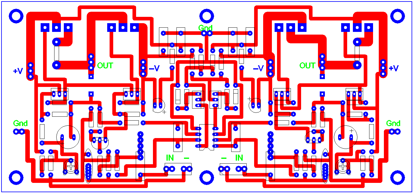

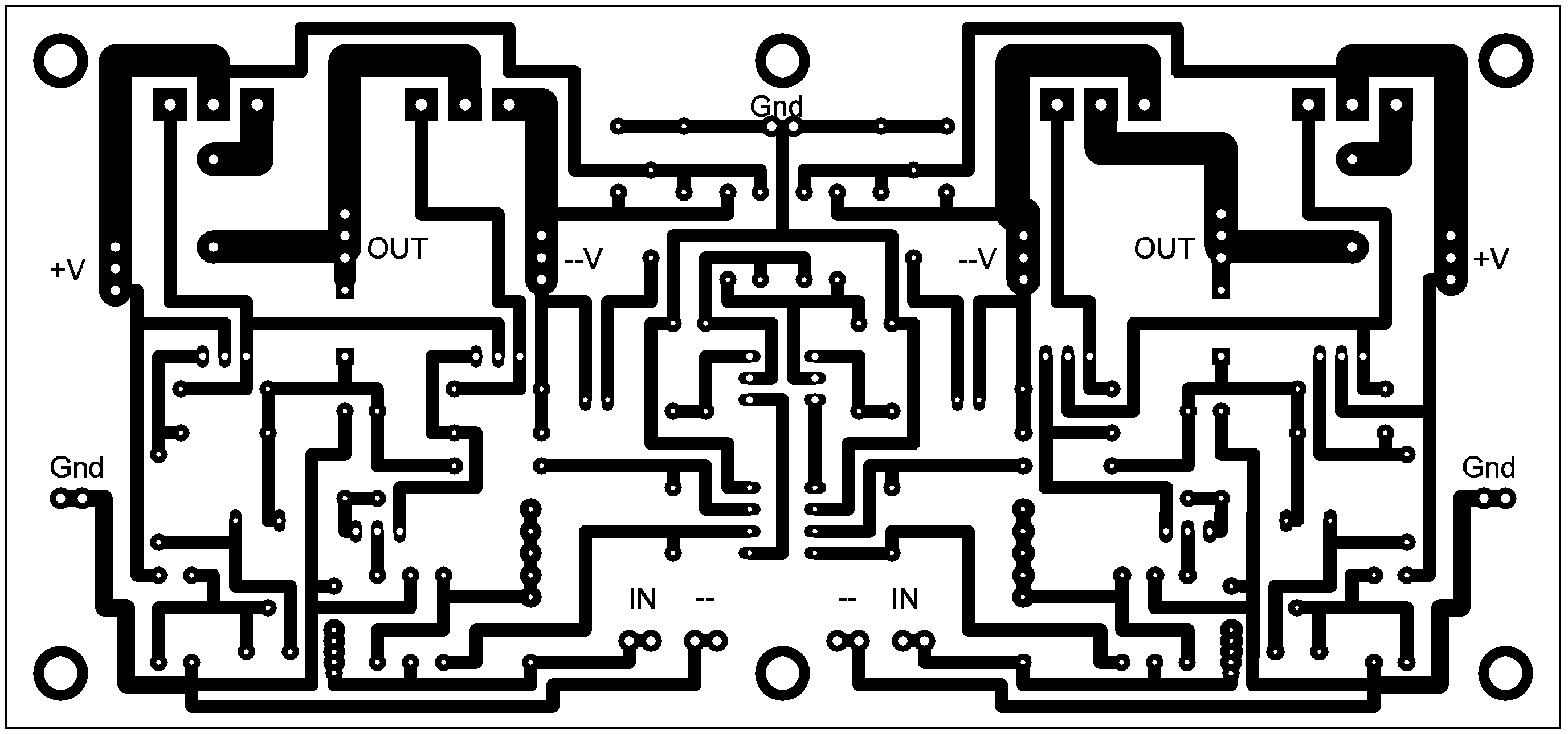

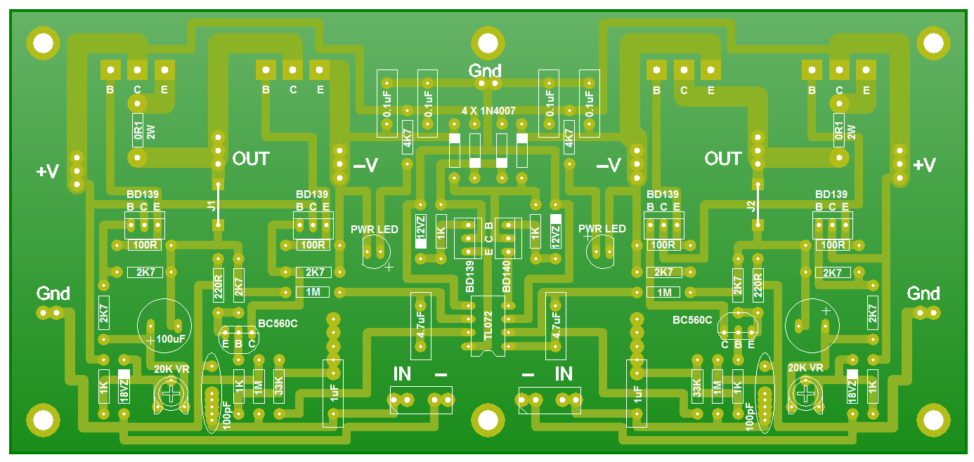

btw, I have designed a simple single layer PCB for the direct coupled DOZ. Will post it as soon as it's finished.
Check this out. Well, I havn't built it yet. But hope it'll work without any problem.
Sizes:- 155mm X 75mm.

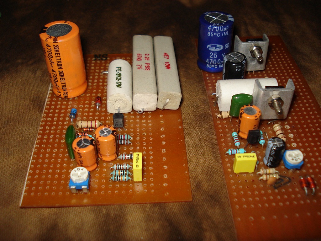

Hahaha, yes I did get awful result from DOZ at that time... 2009... my first attemps. But you see that was not the shaan of 2012, right? I now know what mistakes I made building it - I used a cheap 5watt wirewound resistor as the 0.1ohm at the emitter of the upper transistor(which I measured with a multimeter in 2011 to be around 3.6ohm 😱 ), it became hot during listening, which it should not be. But due to my ignorance and lack of experience I couldn't suspect it. Also I used some cheap chinese electrolytics in the feedback path, bootstrap and the output; pretty ridiculous when I think of it now. Of course it had to sound bad. I wish the resistor or the power transistors blew; then I could have had a chance to understand what I needed to understand. Finally, the layout was also non-standard for this circuit. Did you see the PCB plan in one of my last posts here? I used the same design in the stereo direct coupled DOZ on a veroboard. It sounds great! Now a days I use expensive electrolytics made by an Indian company "Keltron". These electrolytics have given fine sonic results be it a simple class-ab amp, Lazycat's SSA, JLH or DOZ. The power resistors I use are metal film 2watt type. I experimented a good deal with different parts, I learned a good deal, I got good sound. It just wasn't supposed to happen in 2009 😀. What I now know is that - All amplifiers sound "great", when built correctly.
Funny thing- I ran the new DOZ amp using the same pair of ST made TIP3055s that I used in that 2009 experiment. Did they go through mutation?! 😀
Hi Shaan,
Many thanks for the explanation. Recently I too came across a similar issue while I was building a Philips 40 W amp. I replaced the power supply filter caps (12000 microF, 100 V, one for each channel) with another brand, and the sonics improved right away. Funny thing is, the swapping was only for aesthetic reasons and I was not in the quest for any sonic changes. However the audio got "cleaned up": my subjective assessment is that the original caps were introducing TIM distortion in the amplifier.
Keltron is a Kerala Govt company based in Trivandrum. At one time time they were reporting losses; anyway good to know they continue to make good capacitors as before. Actually with the proliferation East Asian caps, I hardly see them in Bangalore these days !

Found an interesting old photo. See the attachment. In the left is a simple pure SE class-A follower amp and in the right, that DOZ of 2009. You can see cleanly that the left circuit has a big Keltron cap at the output and the right board has a blue "Samwha" cap. The left board sounded superb, the right sounded the opposite. You can also see the dreaded 0.1ohm(3.6ohm)/5watt white resistor on the right board. That thing had a +-5% print, but measured beyond 100% tolerance, it was flying at +3600% of the printed value...
ROFL!

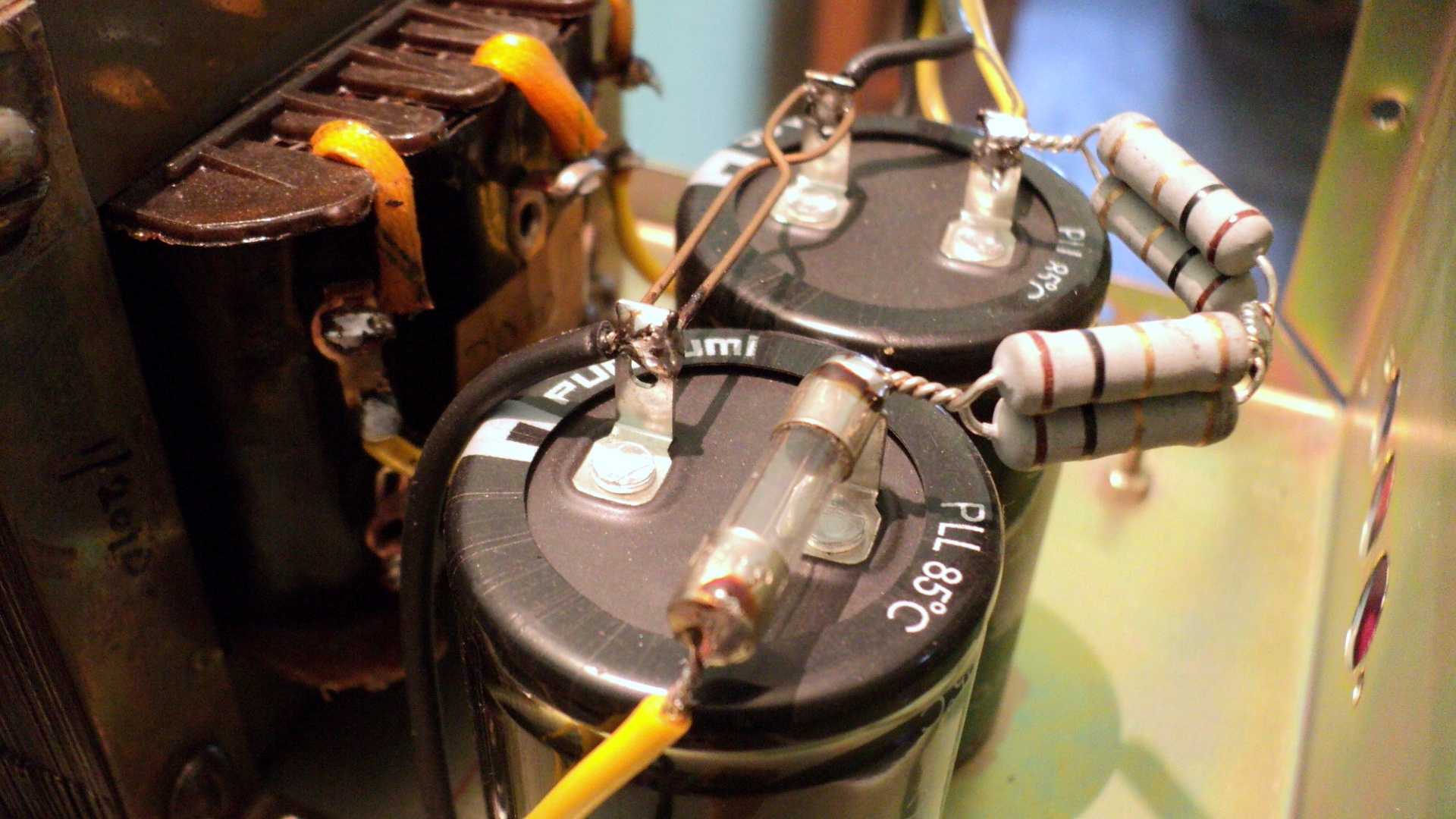

Let me tell you how I dirtied my hands with these bad capacitors. I used to buy Samsung caps at that time from the retail shop(I still have 4 of them). One day they showed me these "Samwha" caps and said these are the new "imported" "substitute" caps and should do the job without any problem. Those samsung caps gradually vanished and these "imported" trashcaps became the new standard here! Of course not in the high-end audio dept., these are prefered mainly by TV repair mechanics 😀. A 4700uF/25V cap costing Rs.16; can you imagine? On the other hand the Keltron thing costs Rs.30 for 25V and Rs.42 for 35V.
Shaan,
Yes, there is lot of "imported" stuff these days. The "Samwha" of course looks better than the the Keltron in the photo (that un-appealing colour of Keltron caps has never changed as far as I know), and also being cheaper, one might end up buying them. My bad electrolytics also were imported (and expensive as well).
I was not aware of the perils of the white wire-wound high wattage resistors; now I know !
