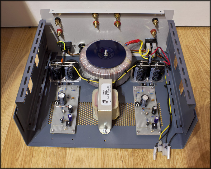

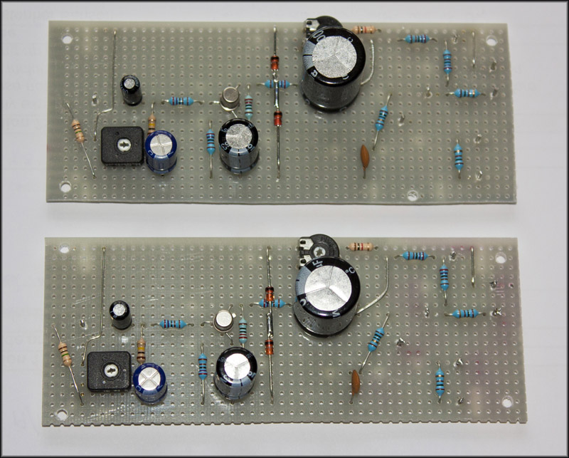

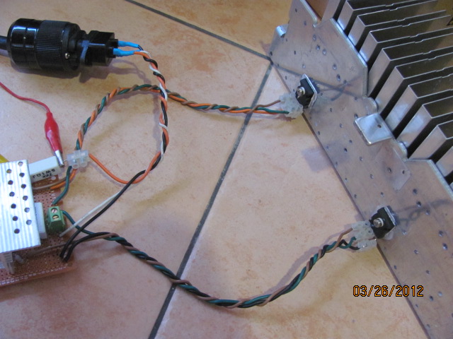

Hi all.
Could anyone tell me if the output of the DOZ is inverted? Like should the speaker + go to the output capacitor or, if inverted, the - ?
I have had the circuit up and running but I am in the middle of putting it all in the case and need to know where to position my capacitors. I am pleased with the sound, especially the bass! It should sound nicer once finished rather than being connected together by 15 crocodile leads
Some progress pics..
View attachment 272381 View attachment 272382
Cheers, John.
The boards look cool John. Congratulations!
DOZ's output is non-inverting, so the speaker + goes to output capacitor.
Once again, that chssis leaves me drooling... !
How are the midrange and highs coming? Also, what are you using as the input transistor?

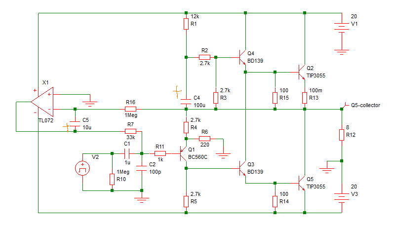

Hi Shaan or others
Please confirm the cap orientation in the schematic below
thanks
kp93300

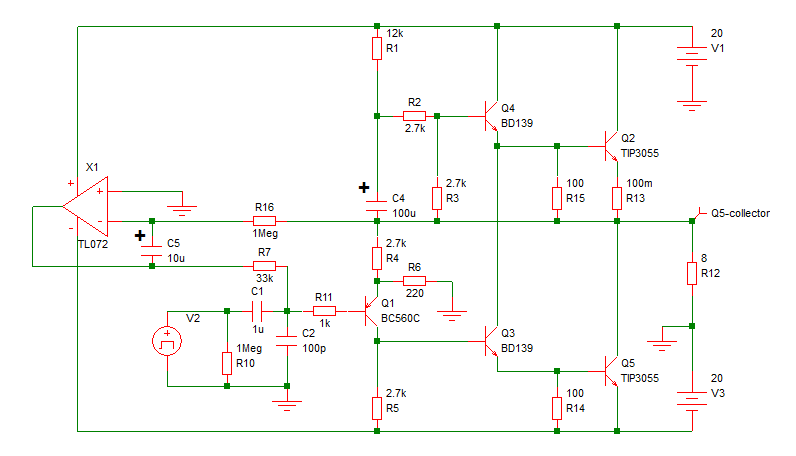

C4 polarity is right. C5 polarity needs to be inverted. Correct schematic shown below.
Sha,
follow the circuit from junction of C4&R4, thro' R4 thro' Q1 eb, thro' R11, thro' R7, past C5, to X1 out PIN.
For current to flow from amp Output to opamp Output then the opamp Output must be negative relative to amp Output.
That requires the polarised cap C5 to be returned to the position it is in, in post44.

Hi Shaan. The input transistor is a BC179C - same as BC559 but a TO-18 metal can type. I prefer the look of them
Yes, it sounded nice, which is why I built the second board. It's almost complete, so i'll post an update soon. Cheers!
Sha,
See the attachment, notice the voltage markers. In order to maintain 0V at the output the opamp must pull the input bjt base voltage lower than 0V. This is possible only if the opamp presents a negative voltage through the 33K resistor. As the voltage at the inverting input of the opamp is much positive than its output so the cap should have the +ve pin connected to the inverting input.

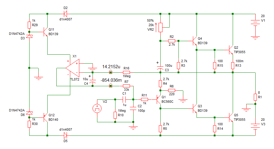

HI Shaan
I follow the schematic in post 49 and one channel is ready to hook up to power supply soon.
How to adjust VR2 , the 20K Vr ?
thanks
kp93300
VR2 setting:- Turn VR2 to its maximum resistance, connect the power supply, note the quiescent current, turn VR2 slowly to decrease its resistance while keeping track of the bias, stop turning when bias reaches 1.4A. After a couple of minutes the bias will increaese automatically to about 1.7A as the transistors heat up and stabilize. If the bias climbs more than 2A after a while, then decrease it with turning the VR2 to the opposite direction(more resistance).
For tracking the current you can place a 1ohm/5watt resistor in series with the + supply and probe the voltage between its pins in case you don't have other arrangements; 1V measured around the 1ohm resistor means 1A of current flowing through the circuit.

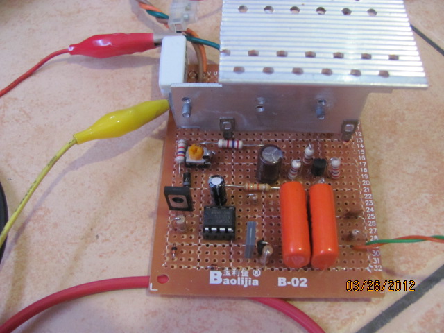

Hi
My build is not as neat as Shaan but i am happy ! It is alive !
I tested one channel with V in of +/- 22.8 V . This are ordinary parts from the local store.
There is no switch on or off thumb and the dc offset is 0 V .There is good clarity through the test speaker.
However, I cannot bring the bias to below 1.8 amp despite the full resistance of 20 K at VR2.
It climb to about 2.1 amp and the temp at the holding screw for tip 3055 is about 68 deg c.
I think i have to increase the value of VR2 to 30 K and try.

Great! I am very happy to hear this! Your build looks very compact. Congratulation!

Just add a 10Kohm resistor in series with VR2 and the problem will be gone. One end of the resistor goes to +ve supply and another end to VR2. I am doing this too. Sorry I forgot to put it in the schematic as the schematic was for simulation purpose only.
The 30K pot will always have less precision than 20K one. So this mod will solve the problem and setting the current will not become hard. Initially I planned to put a 100K pot there but they have too low precision and just a little pressing with a finger over the pot changed the bias to +-500mA!... Followed some experiments and I concluded with 10Kohm+20K VR2.

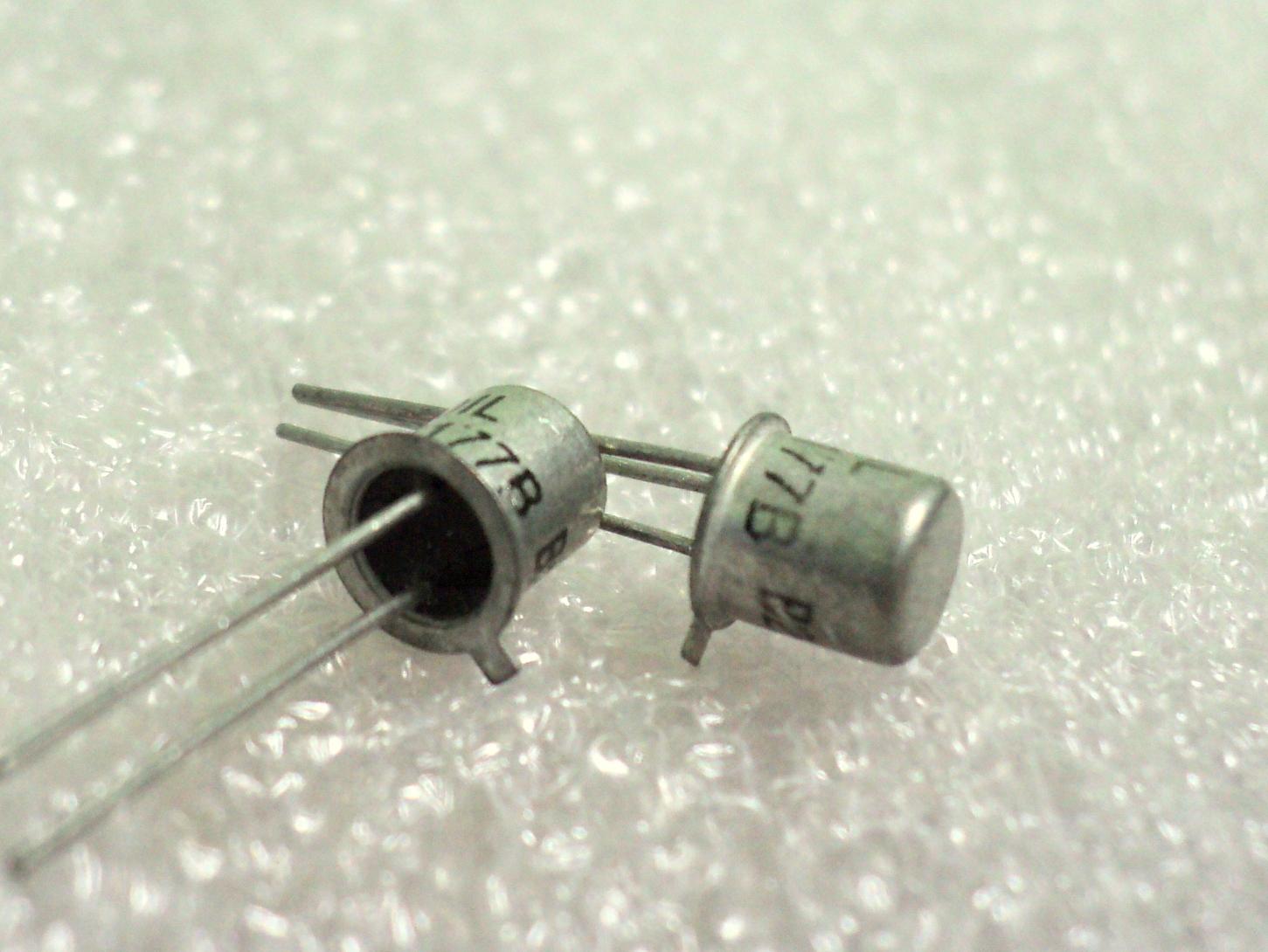

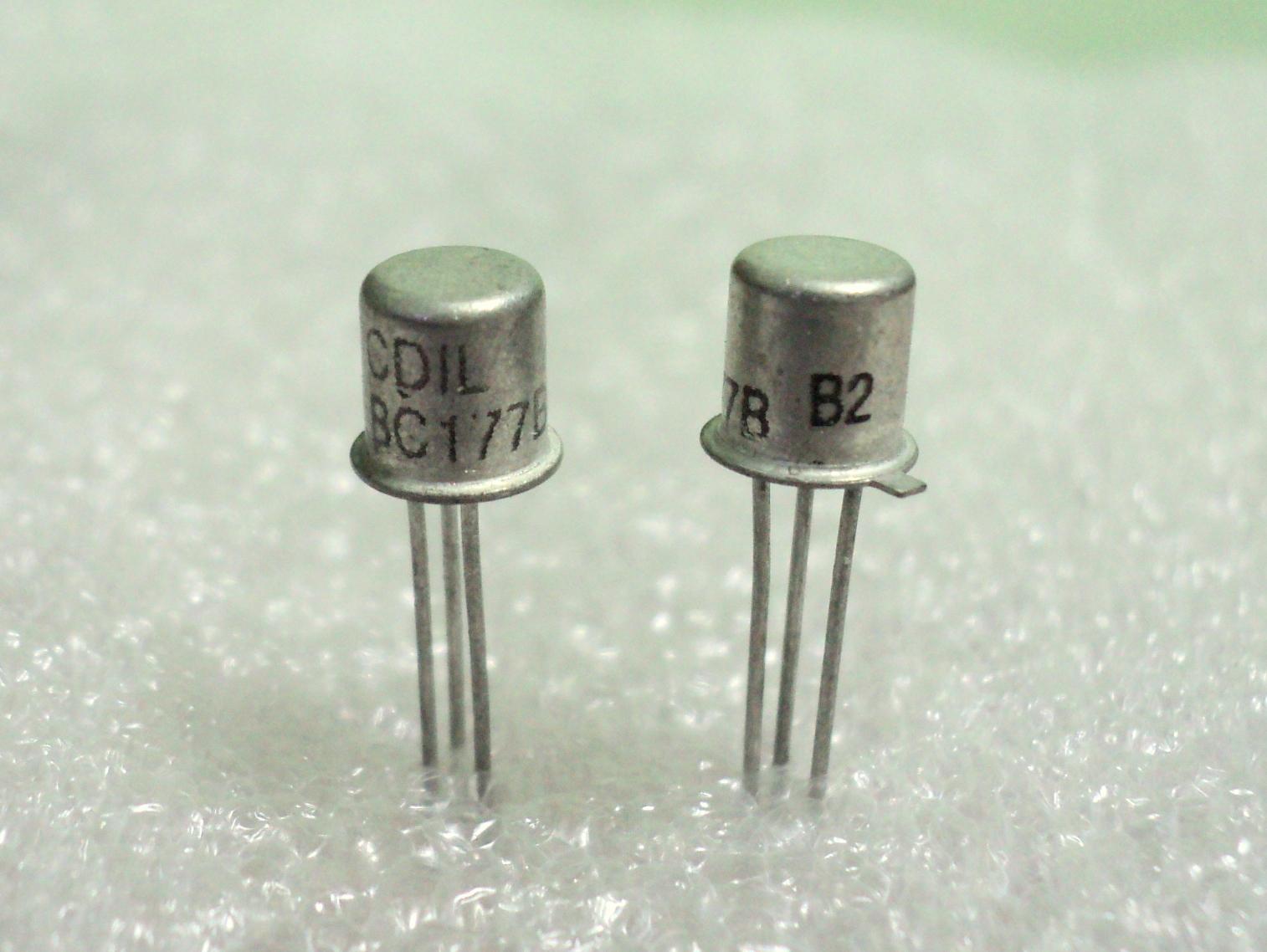

I just bought 4 of BC177 TO18 bjts out of curiousity after reading m0ukd's posts. I'll install them in the DC coupled board in place of the BC559. Wonder how they are gonnna make DOZ sound.
I just bought them because I like the look of metal can transistors

M0UKD, I have been using only plastic transistors for the last three years and these metal can small transistors look cute and sexy! LOL...
