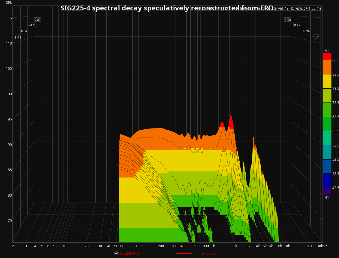

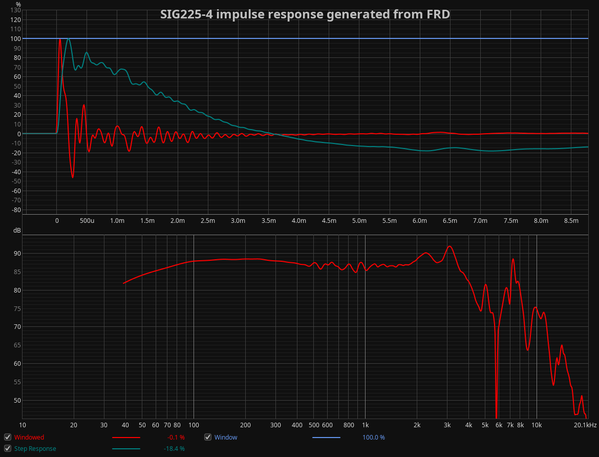

The FRD data is good enough to speculatively reconstruct the impulse response. The 500-2k roughness is caused by a reflection at 3.4 feet (~6.5ms). There is a large difference in decay between the first 2 woofer peaks.
The hillside on the left here is just spectral leakage from using a sharp FFT window.

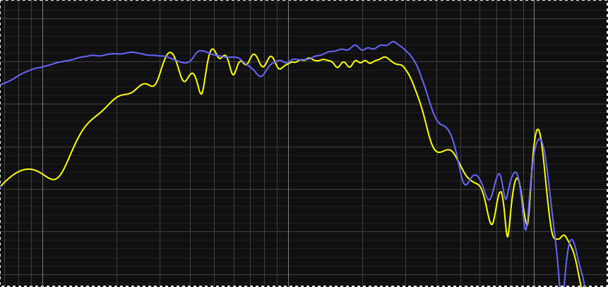

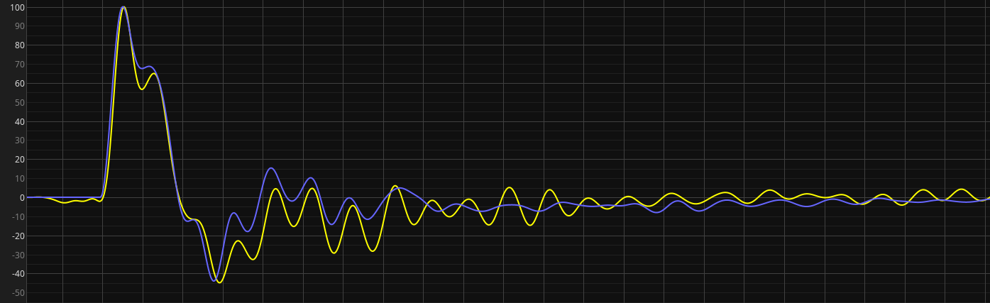

Someone asked me to measure sig180. Idk how useful this info is, might be totally useless, I just tossed it on an 8" baffle similar height to BMR speaker. There was no box to this, just tossed a thick blanket over the back and did a close mic and 1m measurement. Used Iphone NIOSH level to guage level at 1m. I was reading 86db for these measurements at 1m, but I also cranked the last one to try and bring out any distortion issues. The driver on it's own definitely sounds very pleasing which is generally a good sign to me. Seems really easy to cross.

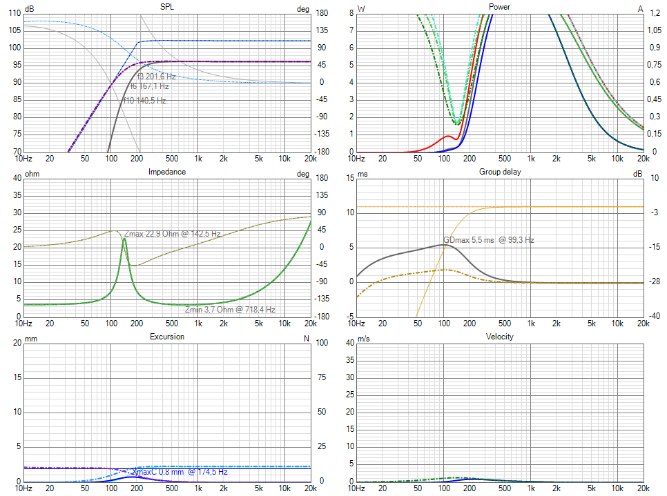

I need some advice regarding SIG-120 driver. I was thinking about using this driver in car audio install (driver installed in A-Pillar, above dashboard, in closed enclosure with nett. volume ~1.0to1.5L).
What could be the lowest reasonable HP frequency? I was thinking about [170Hz / LR4 active] and [~1.5kHz LR4orLR8 to T34A], but not sure if this is a good idea..
The other driver i was going to use is SB-A MW13TX-8, but it feels to big and not looking good (enclosures already made, but have to redo it, since i've made some errors).
thanks for all the input 😉
