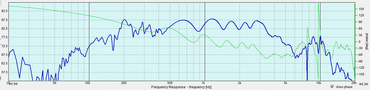

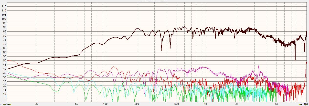

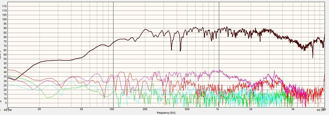

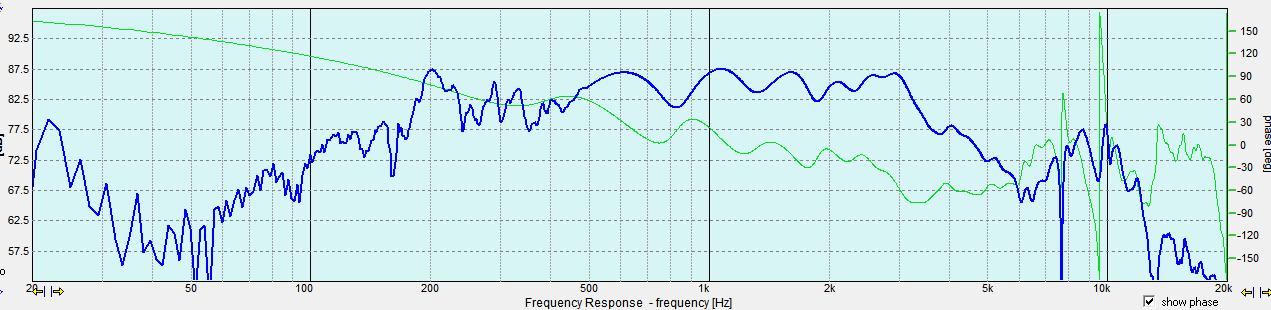

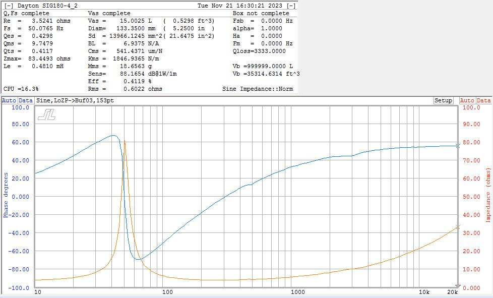

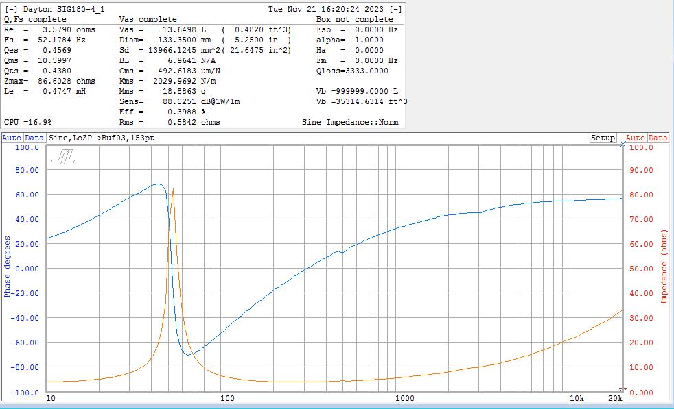

Finally got some retesting done, as well as some quasi-measurements.
I measured the T/S with the film off of the pole this time, so those are truly valid. Those specs did not change that much from the previous.
I also measured the woofers in a very holey box with lots of fill, surface mounted, sitting on the floor facing up. This is not quite ground plane being the box was against the 'wall', and the mic was about 30" from the woofer on axis in the leaky box. It is also not free field. This means the baffle step is partially compensated for in the measurements.

As already stated. If all distortion is minimum 55dB down - everywhere. And the breakup is around 10kHz - for half the price of SB and others. Then it should be a pretty nice driver overall 👍
-45 to 50dB anyway, as it's not -55 in my plots. 40 and 85-90dB respectively. But yes, I see no reason to think this is a bad driver. A driver at -45dB or better across the board at thus price I'd call a steal.
Michael, yes, it was mainly to get an HD plot. I do not hold much stock in the FR plots I posted. They will be retaken for 2 reasons. 1- My current laptop is on its deathbed, one coming to replace it. 2- Of course they were not taken with as much caution as I normally use.
Reactions: Marveloudio
I would be most interested to know how problem-free it would be to operate the Sig225 up to 1 kHz. The distortion bump of the sig180 at 800 Hz unsettles me a little. Are there any new findings?

The one drawback I see on these new Dayton drivers is a longer than typical VC former, which tends to cause standing waves inside the pole cavity. The other issue is the spider resonance, which looks to be present on most of the drivers in that series. The main deal breaker for me is the concave Alu cone. If the surround can't control the first radial mode, it will be a difficult driver to work with in terms of xover. The Dayton FR graphs are very smoothed and don't show enough resolution to quantify the potential problems in the suspension design. The larger models look somewhat promising but the price tag isn't that low.

I'm still waiting to see if the reported changes between the originals & production units have actually happened or not -and if so, exactly what and why. I've seen worse, but at the moment I still lean toward the RS225-4/8 or the RS210HF if you can cope with the latter's very low sensitivity, making the 225 still the canny choice. I wish Dayton would back off a bit on the smoothing though -the old data sheets were better in that regard, even if the physical graph size was a bit small.
