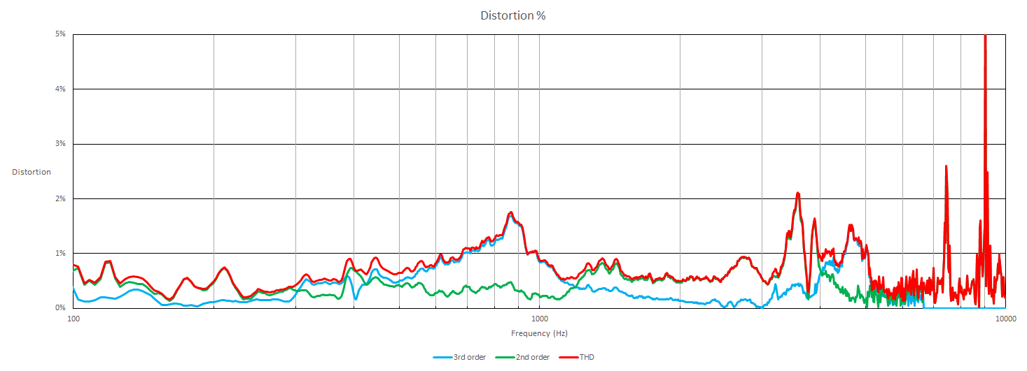

I posted some measurements of the SIG180-4:
I was able to experiment with a SIG180-4 in a 12.26L box.
The distortion measurement above doesn't really look right based on my experience.
Some quirks of this driver:
At 1.2KHz there is a peak due to an abrupt change in directivity, so in a bookshelf speaker you would want to be listening below the axis of the woofer since it gets worse when you listen in front of the tweeter.
Around 500Hz there is a wolf note that is very audble but hard to find in the measurements. It corresponds to peaks in both the 5th and 7th harmonic and a minimum of the 3rd harmonic.
The 3rd harmonic peaks around 3KHz, but this is not a localized phenomenon, it is just the motor's 3rd harmonic coming out through the acoustic response. In any sane crossover the 3rd harmonic will not peak so much.
In terms of the sound I can get it to sound pretty good, but not so much so that I don't feel drawn toward my SDS160 or other few woofers I have to see if they might sound better.
Plain distortion chart:
Same chart but with the harmonics plotted at their natural frequencies. Notice the 7th harmonic peak at 600Hz:
Same data, but this time plotted with the harmonics normalized to SPL at the harmonic frequency. The lines become straight, showing that the distortions present here are mainly consequences of normal motor and suspension behavior:
Distortion with a notch filter and 1st order crossover:
