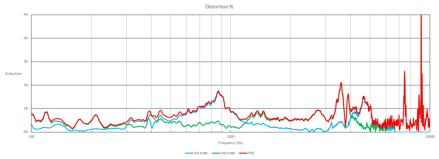

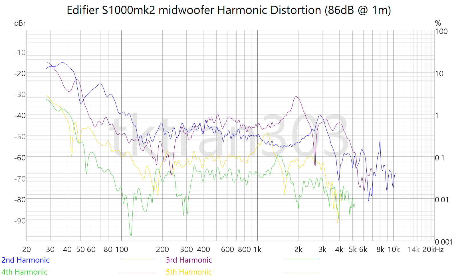

If you worry about 1.5% K3 of the Sig180 why don't you just filter it out? (passively)
You can even switch it on/off during listening anytime making a cable long enough to your listening position!

In this case I think filtering it out passively is going to be a bit of a challenge since it's quite broadband.
