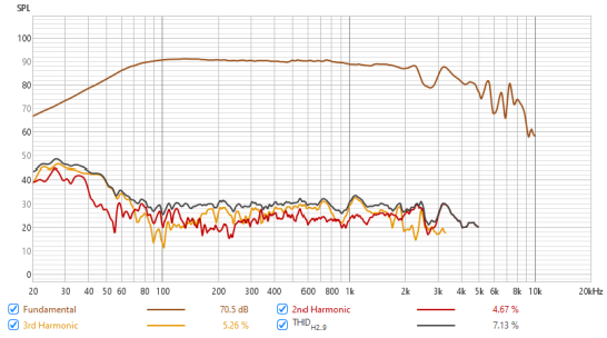

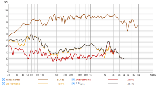

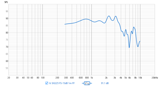

Hi, I've been using one as part of a studio monitor design I'm working on. This is flush mounted into a 16.7L cabinet 400mm high by 290mm wide.
Note the two bumps at 2.3kHz and 3kHz are cabinet resonances, they show up on the impedance measurements.
Three plots:
  1. Free Field response at 1m gated 3.5mS
  2. Distortion Free Field
  3. distortion Near Field

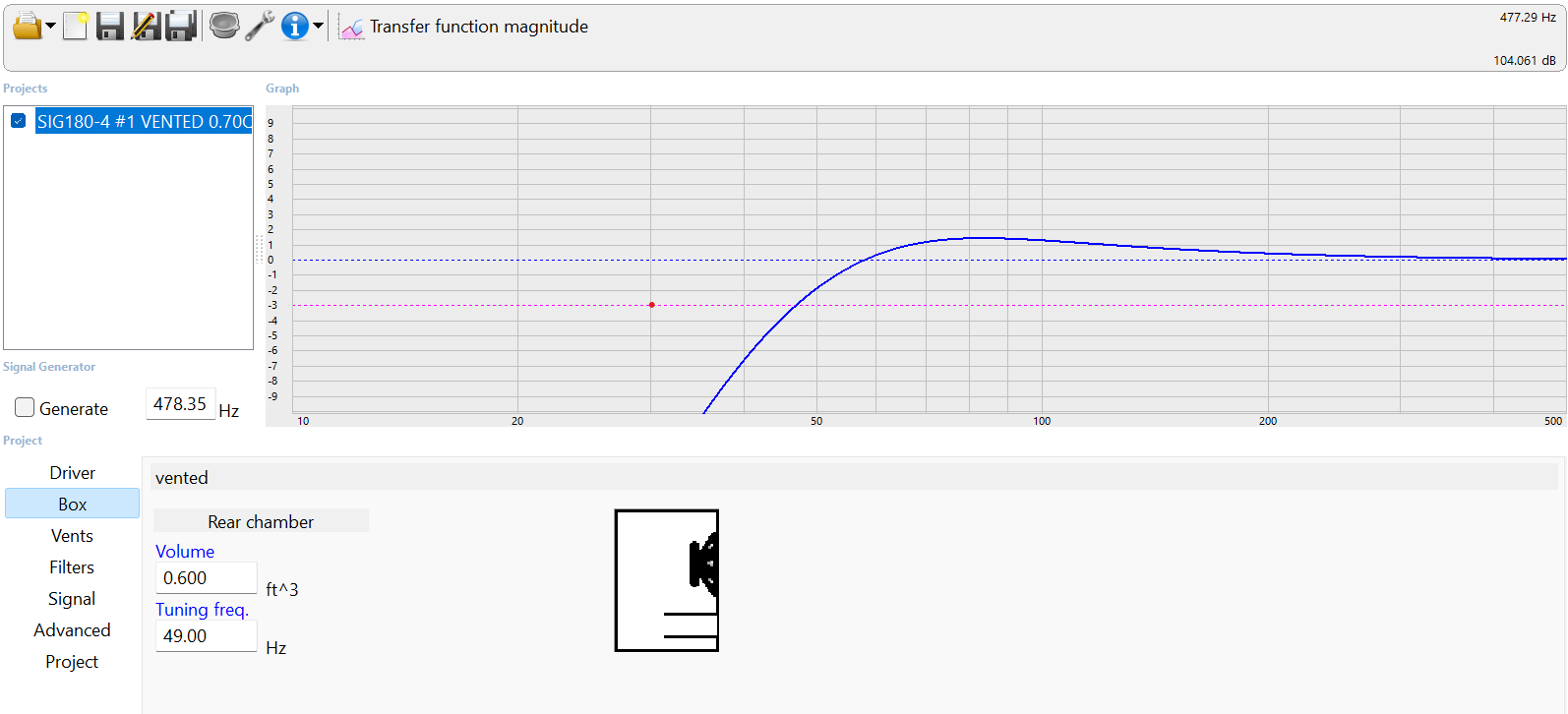

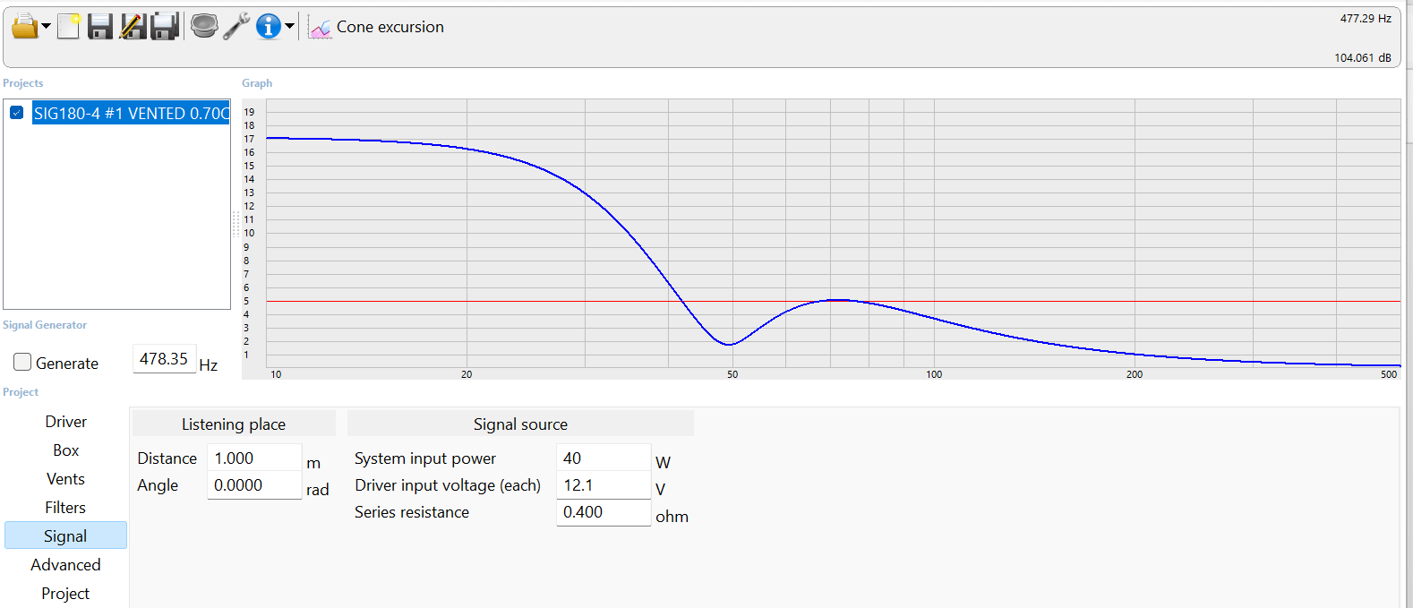

Was about to get cutting some wood for a sig 180 bookshelf, winisd tells me that I'll hit xmax with a 41hz tuning in the suggested reflex box. That seems early to me but I could be wrong. Getting max spl of 102 which is plenty for this.
These will be for my partner's bedroom and she's opted for a typical two way with 104mm faceplate tweeter in walnut veneer. Not what I'd choose tweeter wise but I'm not the decision maker here and I'd like to use what I have on hand, and it'll sound just fine really. I'm going to see how the woofer behaves with a 2.5khz xover with an nd25fw (I love these things) , if that's not good I have plenty of others that will cross lower and fit.

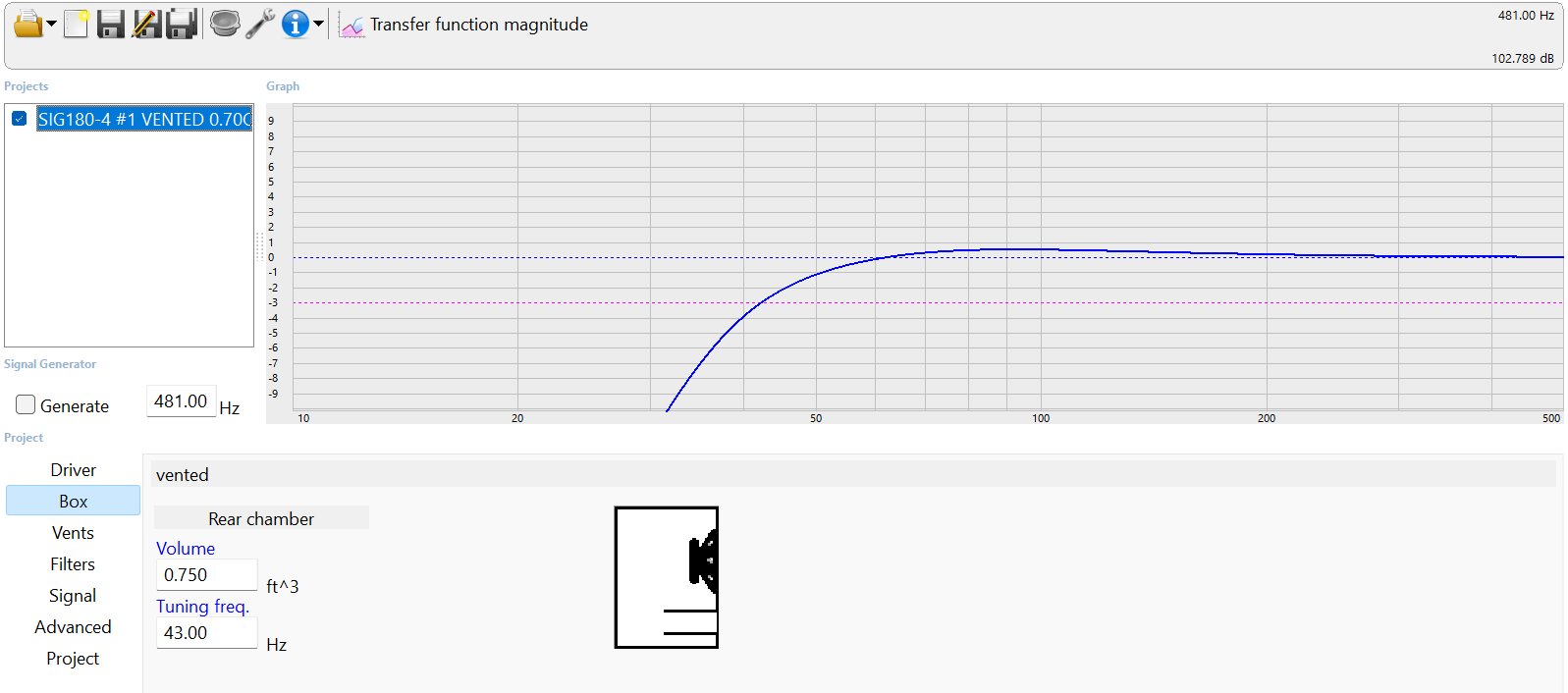

It will depend on the box size and power also, so hard to know exaclty what you modelled.

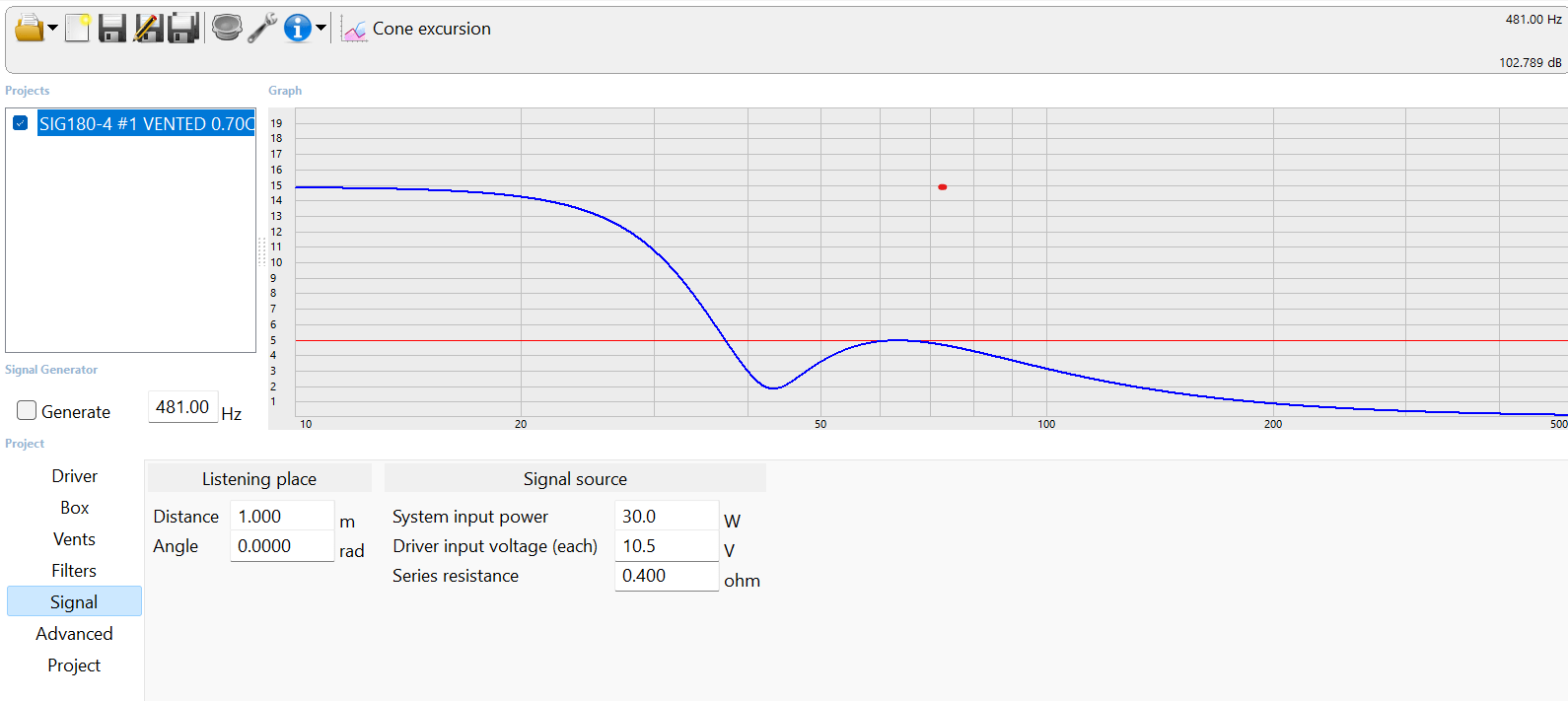

Here is a model I have saved, using actual T/S measurements of one of the drivers I have on hand. 0.75 cf, tuned to 43Hz, xmax at 30 watts, anechoic SPL 102.8db.

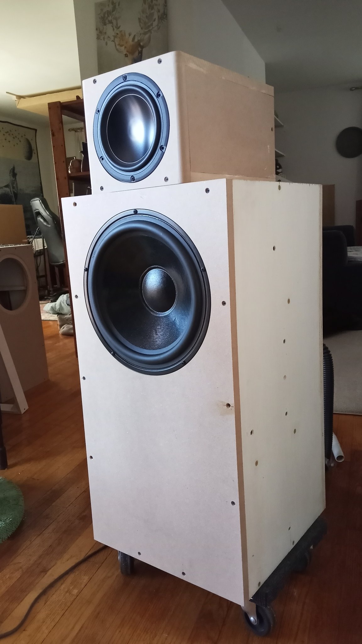

Ended up brain storming and decided on a modular speaker setup using the sig180. I'm hoping this build addresses some of the complaints I had with my last speaker. I repurposed the large box from that project and just slapped an mdf baffle on and tossed in the woofer, will port them eventually.
The imaging of my last project was not great, and I contribute that to the wide baffle with hard edges. I opted for a design that keeps the baffle widths sort of optimized for the driver size. I still wanted a 3 way speaker. Filtering will be active.
Just have the little tweeter "boxes" to make, then I veneer stuff. Gotta go get more wood glue because I let my big bottle freeze.... You can see the signs with the white powder dried glue.

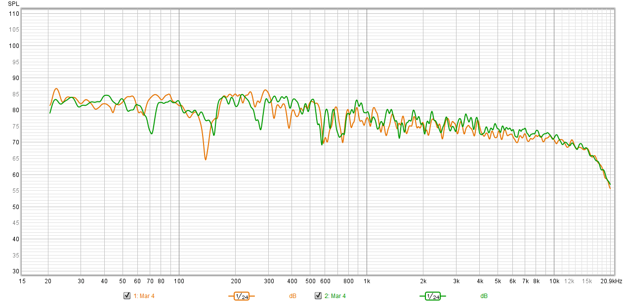

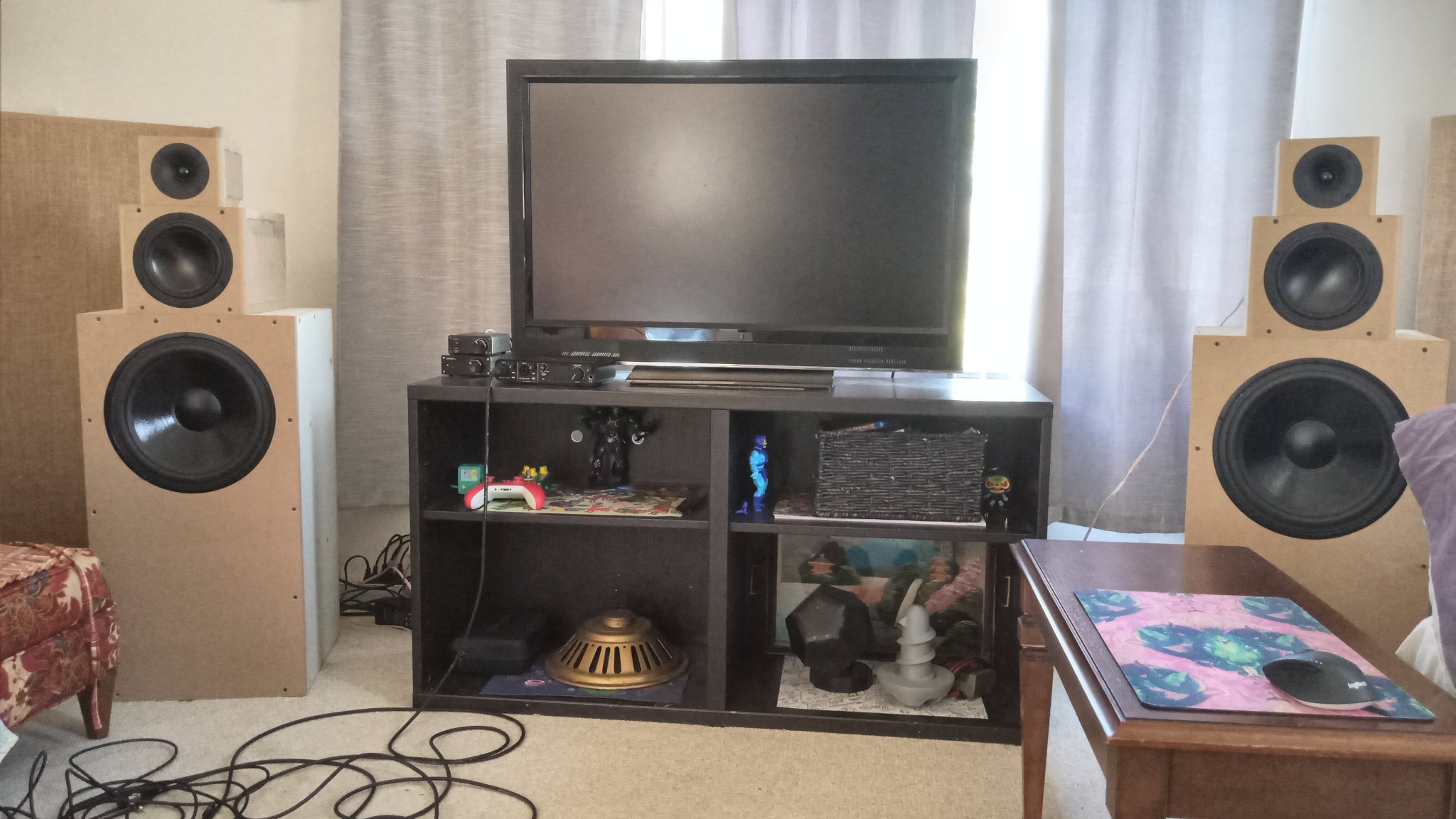

This is my LP, just have two filters each on the 12" woofers to account for some room issues, and otherwise just 2nd order 300hz, 2500khz xover points. Definitely the best sounding speaker I've made but is that saying much?
