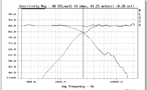

Joe's measurements of the individual drivers with filter attached -apologies, it was a 2.526KHz crossover frequency, not 2.2KHz.
