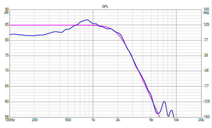

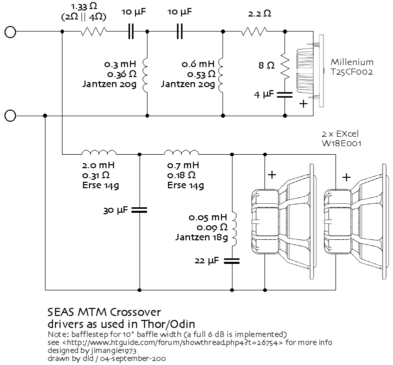

Short version is that Thor is acoustically undersized, although assuming an Augspurger type alignment which is optimised for low gain & a relatively flat impedance it's not catastrophic in that narrow context. It's more of a problem however when most builders / buyers expected something with a bit more output a la some of the '70s era TLs typified by IMF. Which is what many of them did.
That was compounded by the crossover. Joe is a great designer (chronic understatement) but when Thor was designed 20 years ago, midbass drivers of this type were a relative rarity. Moreover he had to keep in mind this was a kit design, that (even as a nominal flagship) still needed to be relatively affordable, which put some limits on just how complex the filter could be. Those midbass drivers are very good for what they are but -and it's a big 'but'- there is a reasonable consensus that they're only useful up to about 1.6KHz if you want to get the best from them. Joe's filter shaped the response to the target, no question, & from that perspective it's a very elegant design, but there are other issues at work. The Thor low-pass uses a single series inductor & an LCR on the midbass driver's main bell-mode as the low-pass, giving the desired rolloff, but it doesn't appear to be sufficient to prevent it causing audible HD amplification in the operating band. To do that, you'd need to drop the filter frequency, target LR4 or higher order slopes, and have a bottomless notch on the main cone mode to break-circuit and prevent it amplifying that distortion in the passband.
Yes, the left hand of the images you attach Allen is the original filter Joe designed for Thor. The other appears to be one of several later filter designs others created that attempted to fix the issues a number (in fairness, not everybody) were experiencing with it. IIRC several reported them to be an improvement & that one certainly looks promising; I've not studied the 3rd party filter designs in any detail though as we're going back a quite a bit now.
Yes Joe turned that into a nice 18dB filter. I'm not sure about fixing distortion with a filter. On looking at the datasheets I'd mark the useful region of that driver around 2,100Hz.

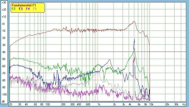

I don't want to push this too far OT, but FWIW:
Re the HD distortion amplification, as I recall this has been discussed at length on other threads (& elsewhere); it's something a few of us do & is also noted on the Hificompass thread. Accuton sometimes apply variations in the distortion measurements on their data sheets.
As for usable bandwidth, YMMV as always. With a ruddy great let-go point at ~4.8KHz, causing a big spike in HD3 at about 1.6KHz - 1.7KHz as you can see from John's / Zaph's measurements, that's about as high as I'd be comfortable taking it (and as far as Thor et al goes, it seems that others ran into that issue; I see Zaph also noted that's about the limit he'd set with this driver). So that's in my view the 'safe' option, but obviously others will have a different take. I'm just stating what issues I know were encountered with the original design (which IIRC acoustically is asymmetric LR4 at about 2.2KHz), and what I would do / others have done to address them.
Working through what I was suggesting, we're saying the same filter is wanted.. even if it is for different reasons. 1600 only needs to be down 6dB to set that harmonic at -18dB. Besides, I don't think it's as if you're going to listen to these on axis.
Here's Joe's on-axis woofer slope.
