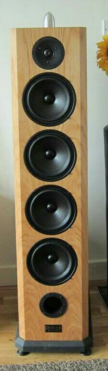

So your fullrange, crossoverless loudspeakers ended up being a three-way system with a combination of electrical AND mechanical crossovers in the end?

yes yes you got it.
I speak in some weird ideas, i realize, Non tech style.
But hope you at least listen through the video.
I am in a new design and very close toa finsihed system,. Looking at addinga 2nd tweeter,, BUt dont wish to ohm over load my friends UX250 SET amp.
My Defy will have new tubes late Janurary.
Anyway, I like how this dual FR came out,. I try to explain in the video.
Again some here may not agree with this concept, and I can understand its out the ordinary.
Both drivers have to match up. If either has weaknesses, it will not work Both drivers MUST BE near perfect, lets say ~~defect free~~.
Davidlouis VX8 + DavidLouis VX6 Full Range + Seas W18 + Philips AD163 tweeter - YouTube

If I understand your design you are using a seas woofer up to about 1kHz, next you use two fullrangedrivers without any filter that share one enclosure that is too small for them, and then you are using a tweeter with a single 8 or 10uF cap which means it will have output down to the point the woofers stops and then you are talking about adding a second tweeters. So now it is a thrown together three and a half way? four way? or even five way system? but you keep referring to it as fullrange????? (no clue how you have thrown it all together, your posts are unreadable because not one single sentence has a normal linguistic structure that other people can understand)
This sounds like a system that has a lot of overlap between the drivers with a lot of lobing and phase issues and a plaine terrible power response. Such loudspeakers can sound spectacular on some recordings but will simply sound horrible with a lot of other music, but there is always the recording to blame isn't it. It is clear that you are indeed non-tchnical and obviously havent' got a clue what you are doing actually. But as long as you enjoy music the best this way that's all fine, it's only a hobby after all but please don't start preaching that it is the best of the best, it ain't.

OK Midwoofer to 1khz
Running 2 Mundorf caps, each $100+ per cap, I have no cash fora 3rd M cap and this would take hz xover to say, 500/600hz.
But why?
I can hardly hear much going on with the W16, The W18 Excel is IMHO the worlds best 6 inch midwoofer, magnesium, = winner cone material,
Very stiff, rock solid sub bass with the Defy's 100 watts a channel.
Eliminated 1 driver.
I think 1 will givea better response vs a pair. Not sure
If I want o add the 2nd, i will, all depends.
Dual FR.
OK, maybe not anyone's cup of tea.
I get that.
Just listened to Santana/McLaughlin, Love Devotion Surrender last night.
Guitars came through cleanly, clearly, with a tad too much warmth,,but better than a single FR, according to my persoanl preferences.
You might hate duals.
Yes glad we all agree these high tech Full range really are super midrange, complete mid band in all its colors, tones, textures,.
Here's my point. I do not care for how a mid bass driver delivers the fq's above,,say 1400,,no make it 1200 hz,,,nor do I care for how a tweeter sings the 1800/2k/2200 through to say,,, 4khz's. maybe even 5 khz's.
I have no issues whatsoever with a magnesium midwoofer being employed as assist up to say, 1000hz, better 600hz, all depends on amp, and pure true wattage.
tweeters , domes only please, fantastic with FR starting at say 5khz, as i have it with a M EVOSG 8.2 cap, The Philips sounds fantastic.
Will test a Seas clone Nd sometime in Janurary.
A SET amp is well known for wonderful mids, the 2 end bands are somewhat rolled off, as you well know.
So its hard to say how the 4 drivers sound with a higher power PP amp.
Better dynamics is my guess....
The jury is still out, as to HOW much a success the Dual FR turned out, ,,,testing will continue through early next year.
CM being mostly mid band and as ypu know is miced far away from instruments, as its the only way to get the whole as a unit in the recording.
I'm starting to hear details that were a bare hush, especially in the gently played notes, now come through the thick of other more aggressive played sections, and I pick these nuances up in amazement.
Tahts the reason i planed this scheme of pairing up dual FR's.
I knew it goes against The Rules.
If we put this speaker in Carlson's lab, his equipment will show gobs of distortion, , spikes, who knows what other ugly things he will see on his measuring gadgets.
The Duo is permanent , Carlsons testing results won't sway me the least bit to dump this project.
Trust me, it will fail all your measurements to qualify as a **High Fidelity loud speaker**
