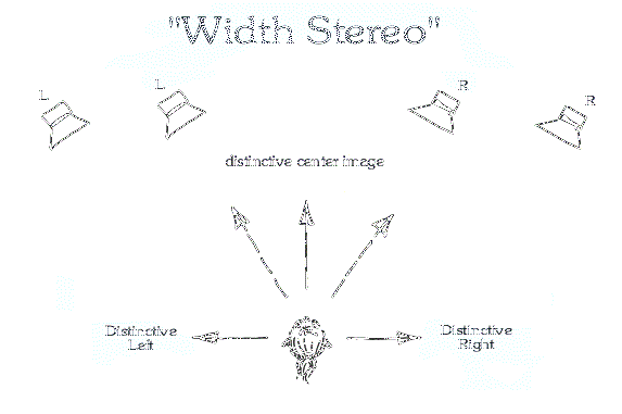

4/ Something a few of us lost souls who have a liking for 1970s era quadraphonics occasionally play with (apologies to those who know -for the innocents, stick with it a moment) was what we called 'width stereo'. It probably has a bunch of other names, but being a closet quad fan, it's what I use. Four speakers: two wired on the left, two on the right channel. Absolutely lousy, as you'd expect, if you stick the extra pair of speakers behind you, as you'll lose all depth perspective in a stereo signal. However, if you move the extra pair of speakers forward, so they're to either side of the normal pair & a bit further out, it starts getting more interesting. Very crude as is, but not without some merit. Assuming you aren't in a position to low-pass the additional speakers, it tends to work best if you can play the second pair at a lower amplitude. When I played with this, I used to run a tape-out into a cheap integrated & power the extra speakers that way. Certainly not perfect, but a fun thing to play with and if well implemented, it can actually make a bit of a case for itself on certain recordings, especially those with a strong stereo image. A slightly refined variation has some support from Linkwitz with his little Watsons, where in essence he's tweaked the positioning & amplitude, & low-passed them: WATSON-Stereo_Expansion_Loudspeakers Attached drawing, modified from an old sketch of different matrixed wiring schemes, shows the layout in its basic form.
